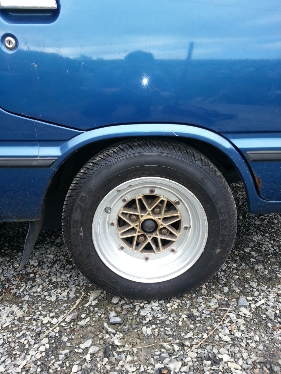

I don't usually start with modifying instead of fixing but the van was too high to fit into the garage. Played with the front torisions and bump stops and it came up quite nicely. Also chucked my Work Equips onto it to replace the knock offs that were on it.

Oh, Offset on the Works sits almost perfectly on the van. Back door just clears the wheels. Might be 3 or 4mm in it!
