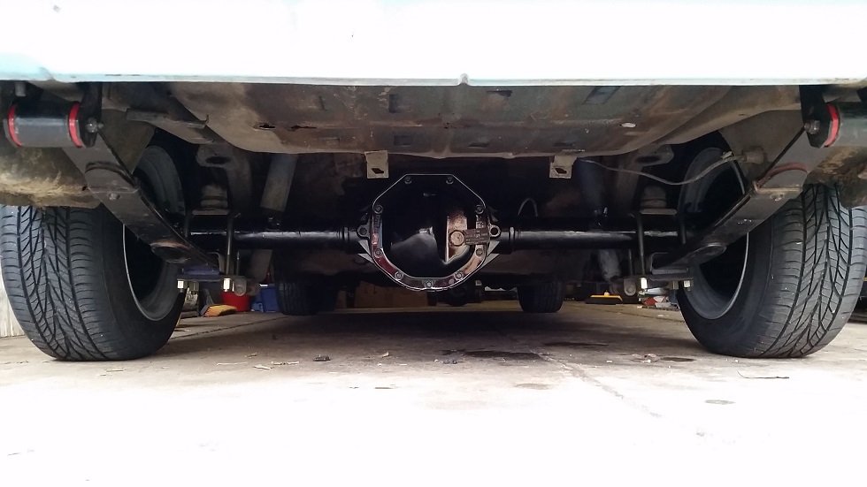

Popular Post Rhubarb77 Posted January 22, 2019 Author Popular Post Posted January 22, 2019 On 25/05/2016 at 21:39, Rhubarb77 said: Big update. Since the last post I got a heavy duty driveshaft made (modified XA-EA falcon tailshaft) and the anti tramp bars welded in. Diff gears are now 3.7- WOW, so much better than the 3.45's. A new GTX2860R GEN2 supercore has been slotted into the existing 0.86 turbine housing. All new custom alloy piping to hold more boost, allow a bigger filter and 32mm plumb back BOV. New tune coming up in the next couple of weeks. Gate spring pressure is now 12lb (up from 7) , 840cc injectors ready to go in and we'll be going to 25psi hopefully netting around 350whp! The car already feels so strong with the new turbo and diff gears. Cheers 20 Quote
