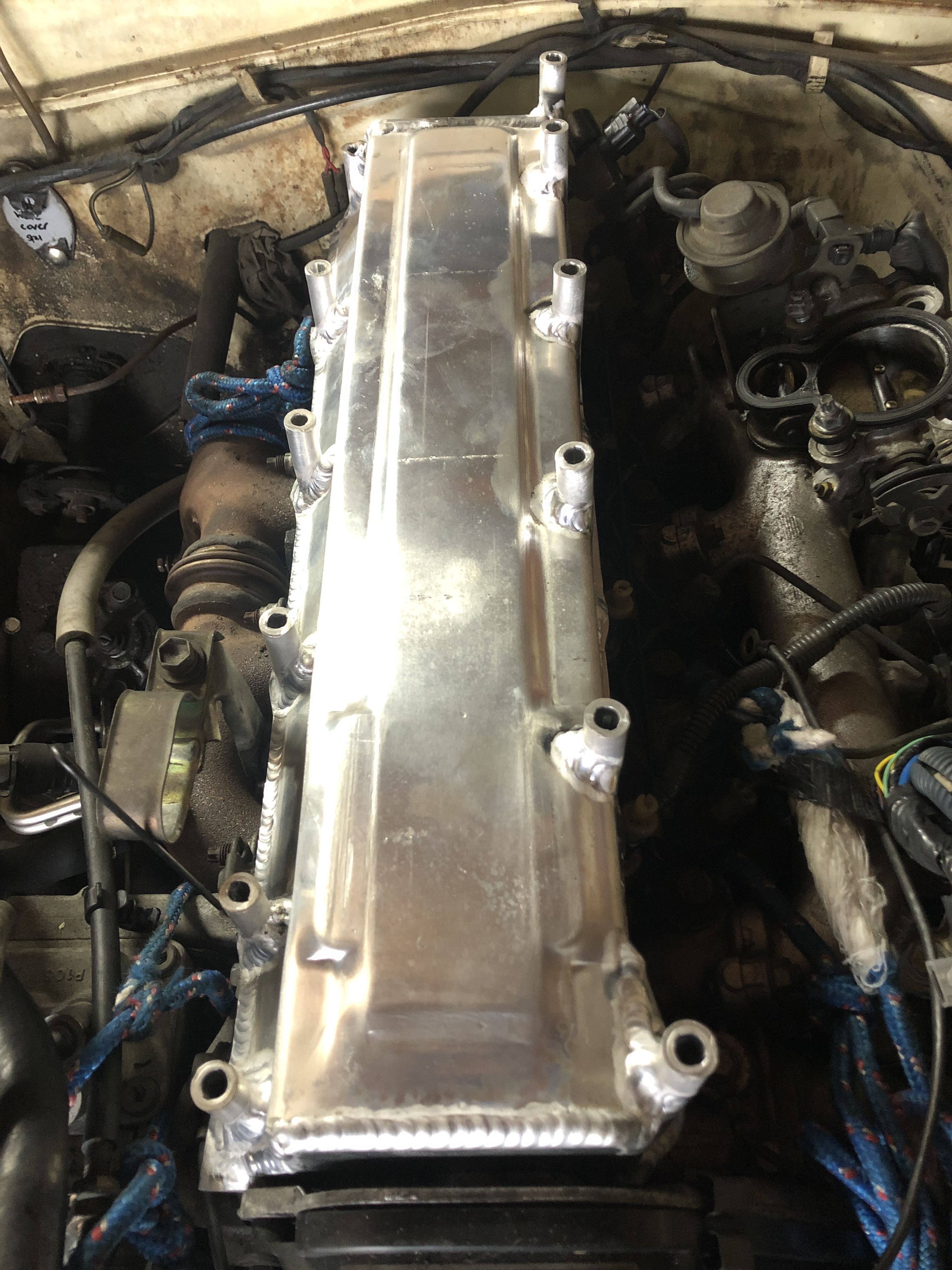

Popular Post toy-mota Posted June 20, 2021 Author Popular Post Posted June 20, 2021 Rocker cover nearly finished.need to go to pick a part and find a steel oil cap and use the wing lock style ,adapt to the 70s toyota one, also weld in the corresponding side to the cover. The pressed square patch on top is for a 4m style sticker but say 1kz. superpro bushes arrived. Will fit them one day. 12 Quote

Popular Post toy-mota Posted July 14, 2021 Author Popular Post Posted July 14, 2021 Rocker cover finally finished and turned the granvia rear sump and pick up to a midsump setup. oil pickup is as high up as i can get it ,4mm off the conrod 14 Quote
