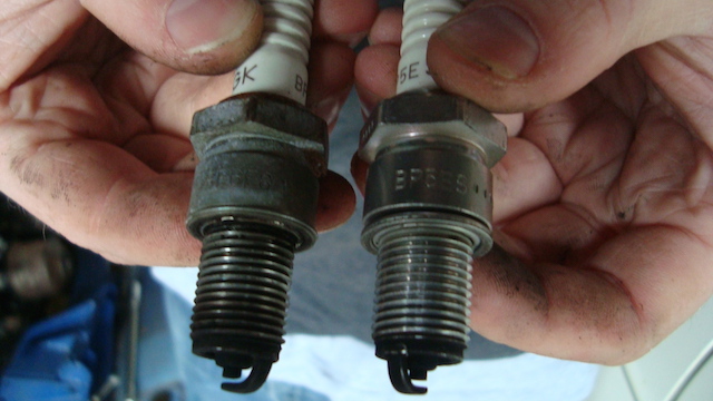

Vidar Posted June 20, 2015 Author Posted June 20, 2015 Discussion Thread //oldschool.co.nz/index.php?/topic/48880-vidars-1974-gt6/ More photo's of bleeding the front brakes. And plugs and rust above windscreen 2 Quote

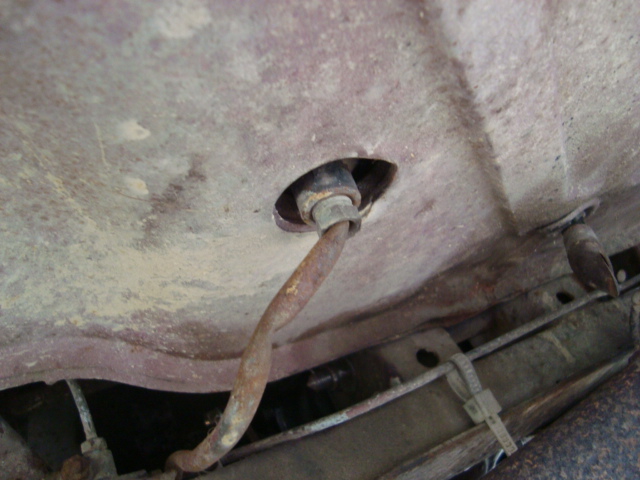

Vidar Posted June 27, 2015 Author Posted June 27, 2015 Found this when we were under the car yesterday. Its the fuel line. Cant be good for it to be bent like that. 2 Quote

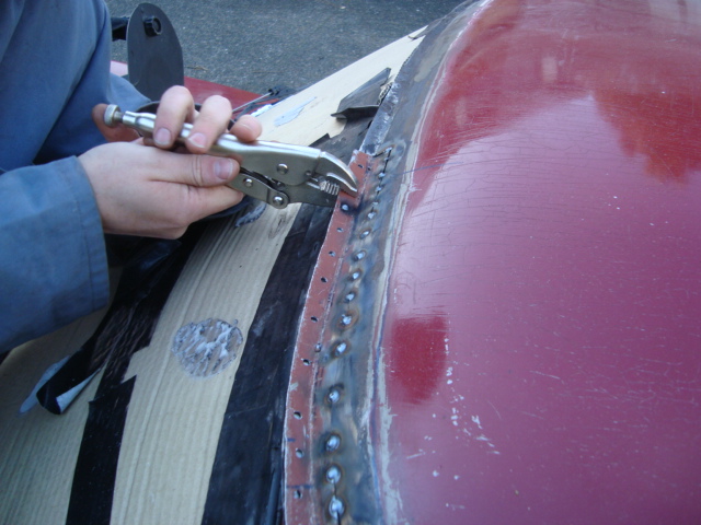

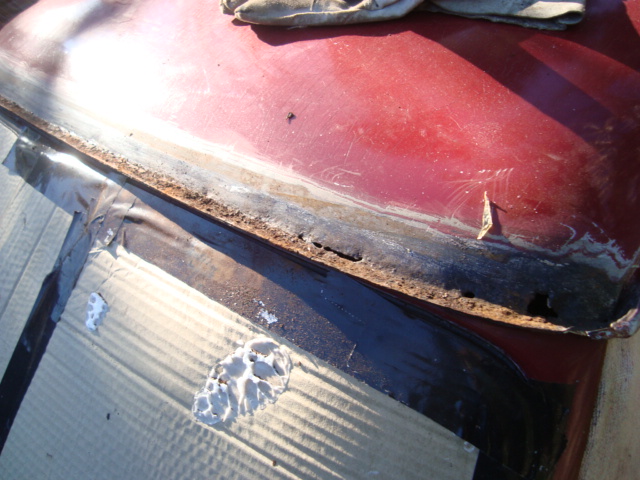

Vidar Posted July 11, 2015 Author Posted July 11, 2015 Next job was to get started on the rust in the form of the roof. Triumph (in their wisdom) put a finishing trim over where the roof panel is spot welded to the windscreen frame and it eventually fills with water and rusts out. They all do it eventually. So we pulled our off and this is what we found. Quote

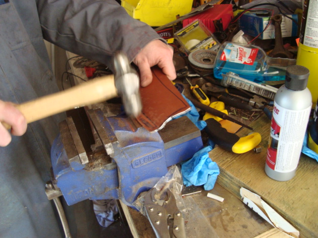

Vidar Posted July 11, 2015 Author Posted July 11, 2015 So out with the grinder and lets see what it like. I think we need some repair panels. I went online and no-one makes a repair pannel any longer so Ethan went hunting in our stack of part and found a couple of old boot repair panels. They kinda look like they have the right curve. 1 Quote
Vidar Posted July 11, 2015 Author Posted July 11, 2015 Time to start pretending to be panel beaters and see if we can fashion a repair out of these. 1 Quote
Vidar Posted July 11, 2015 Author Posted July 11, 2015 More hammering......more bending.....hammer......bend....hammer....bend Lets trim out the the rust and trim up the repair There is a little rust inside that we can take car of before welding Seems to fit OK Time to deal to the rust Quote

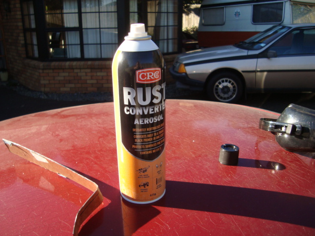

Vidar Posted July 11, 2015 Author Posted July 11, 2015 The rust converter foamed up and covered the inside of the roof.....it did leak inside a little Re-check the panel fits Out with the welder It promptly ran out of gas! that put a stop to play.... May have to go back to working on the mechanicals. 7 Quote
Vidar Posted July 24, 2015 Author Posted July 24, 2015 Finishing off one side of the rust in the roof People seem to avoid showing shots of the welds before they a ground back. I guess to prevent being mocked for the bird crap welds. They always look great after grinding Add some bog... Looks a lot better now 2 Quote
