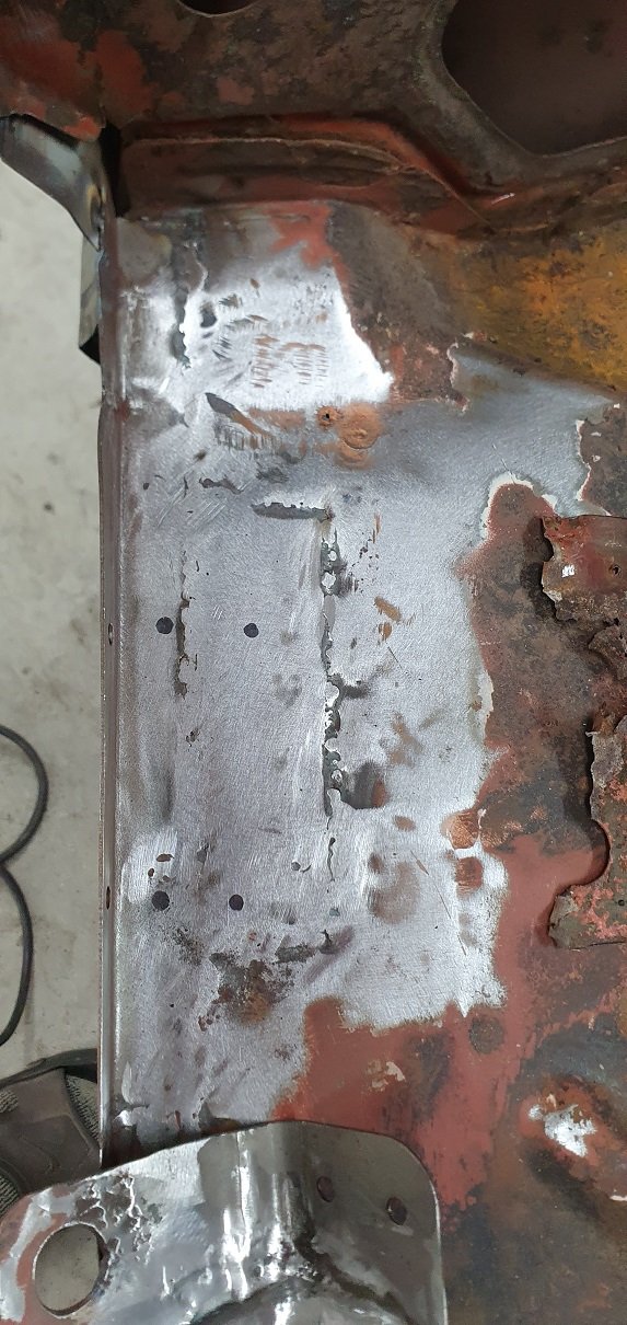

Popular Post sleeektoy Posted September 7, 2020 Author Popular Post Posted September 7, 2020 Rear bumper brackets on the inside were rusty and loose Removed the bracket to fix it and also fix the floor under it Fixed the bracket and sussed a repair piece for the floor ... but how to weld it in properly.. So.... minor escalation in repairs.... off with the valance~!!! Turns out it was held on with a little brazing and some pop rivets , plus welded at the top Easy access for welding and of course the other side too.. 10 Quote
