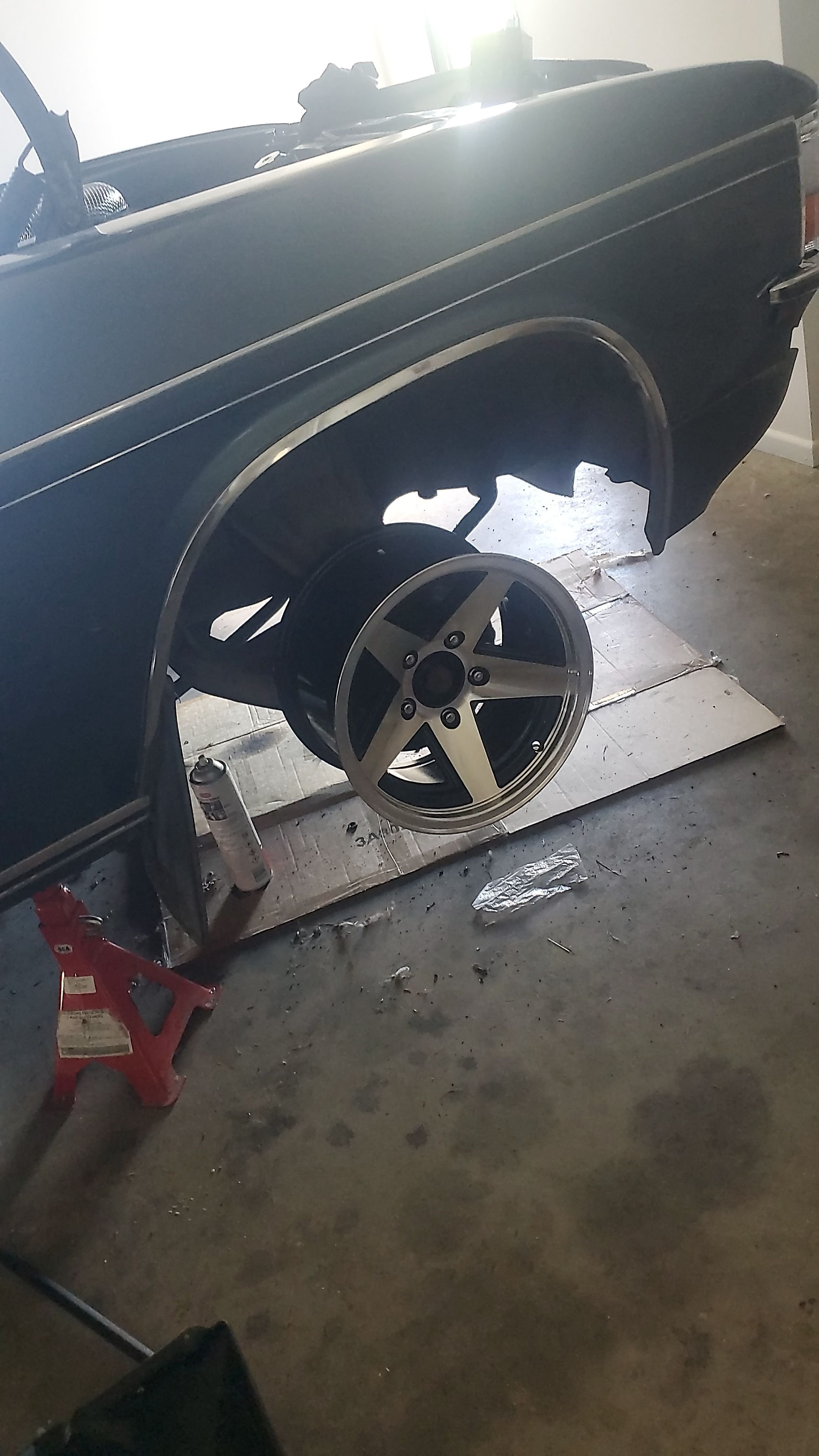

Popular Post dr.wylde Posted February 25, 2025 Author Popular Post Posted February 25, 2025 One thing I always thought that let the car down was the wheels. I love the Steelie and Hubcap combo but they need some loving. On top of that I'm a little over the Stock look and now the car will need a bit of a makeover anyway so I thought I'd treat the old girl to some new Shoes. Show her that I still care 16 Quote

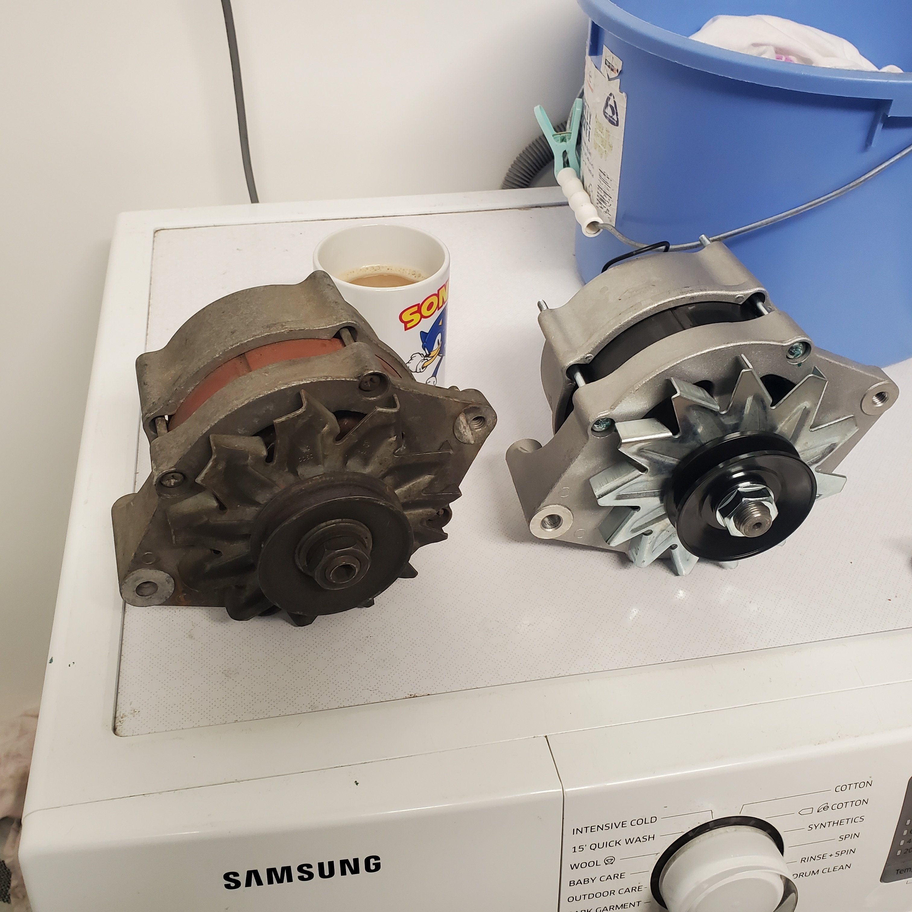

Popular Post dr.wylde Posted April 30, 2025 Author Popular Post Posted April 30, 2025 also gave it a new alternator. not really much to post about but meh! new 120amp instead of the factory 55amp. hopefully enough to future proof any other mods that require electrical stimulation. however even with there new alternator I'm still having electrical issues, lights dim and flicker . seems like the overall system isn't getting enough power , so now I'm looking at battery terminals and leads as well as all my connections. but that will be for a future update 10 Quote
