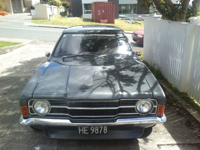

Hey all,
After my last 2 RB projects i still missed my old mk2 ford escort project so much that ive decided to get back into the old school scene with this.
A Mk3 Ford Cortina! Always wanted one and after selling my last project which was a C35 laurel this came up on the forums.

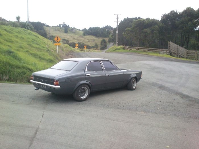

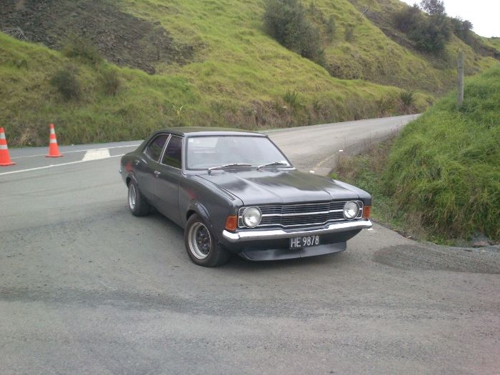

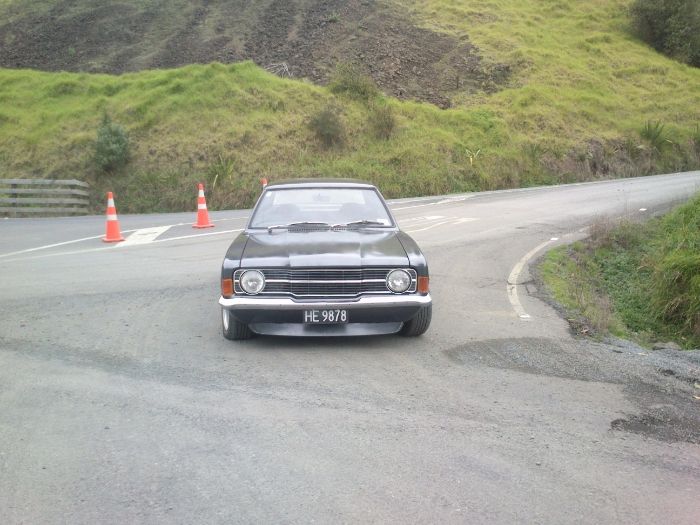

Took it down to taupo for a track day that was intended for the laurel but since id already paid for the day i figured id take the cortina on for a giggle.
Only to find it had used pretty much a whole sump of oil and ruined a few of the brand new plugs i had in it. Tried a few suggestions through the forum to diagnose and also rang the cylinder head shop for a bit of advice. Turns out bottom end needs a rebuild (was planing on doin it at some stage but the cortina wanted it now)

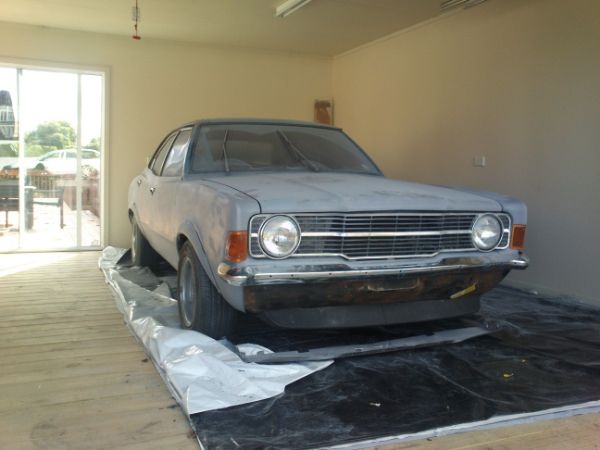

Decided to pull the front valance off the front and found its full of bog (about 10mm thick in some places) and a shit load of rust.
ive decided to make my own front lower valance and replace a decent chunk of the upper valance.
Just a trial fit to check the guards line up with the curve and where to cut to fit over rails.

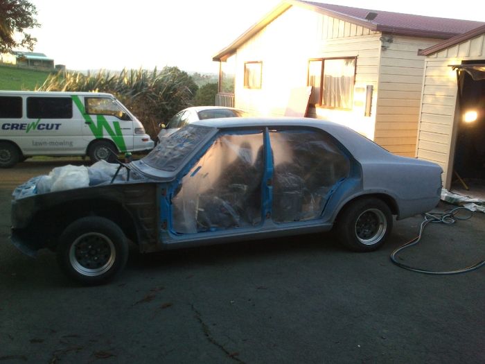

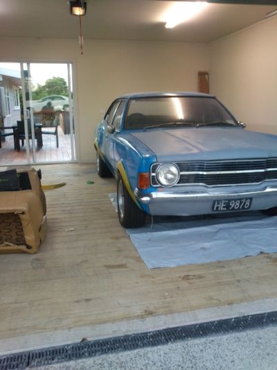

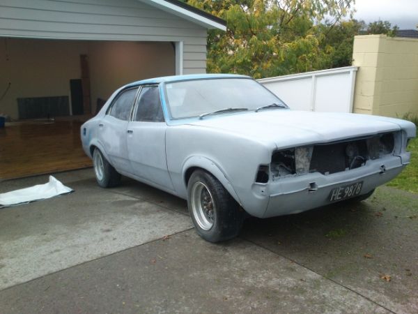

My landlords given me his garage to use for a couple weeks while he sells his place so ive been trying to take advantage and get stuck into some body work.
Removed most rust and have predpd those areas and have also got the passenger door sorted as the paint that was on it had heaps of hairline cracks through it.

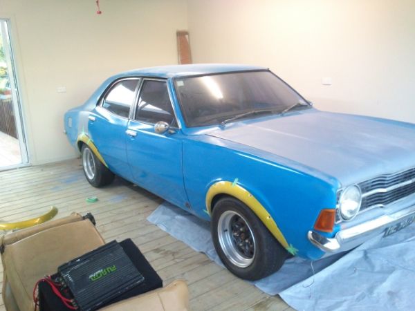

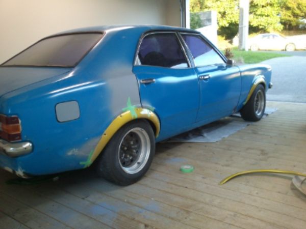

I also just bought some wheels arches, currently mocked up for now so any and all feedback is welcome.
Rears would need spacers IMO and i would mould them to the body as opposed to just bolting them on, What do you guys think?
give me shit: http://oldschool.co....74-mk3-cortina/

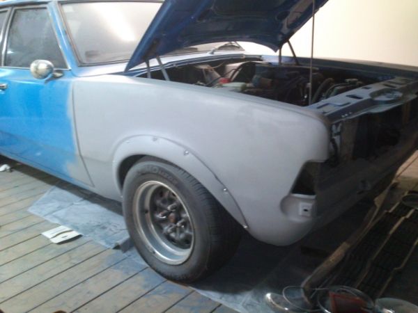

Bolted the arches on. Got some nice looking button head socket screws, sits pretty nice.

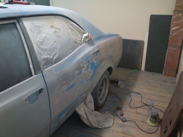

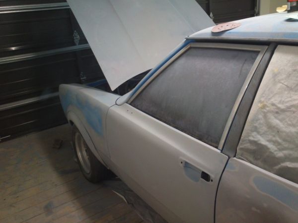

Got stuck into sanding it down aswell. Its been a bitch because the blue paint on it is a lacquer so its clogging up the paper really easy.
I now have mad blue bogeys. Sweet
Most major sandings done, just got roof left and door jams etc.

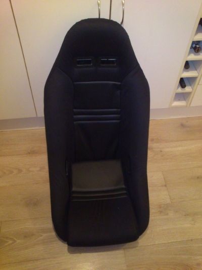

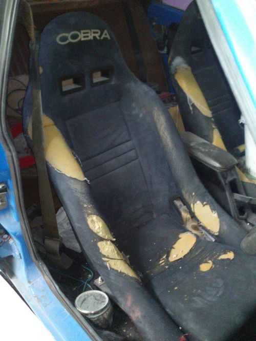

Got some bucket seats off trademe a while ago and my workmate mentioned hes getting into a bit of re upholstery and offered to do the bucket seats for me because he hasnt done any before, hes refoaming parts aswell so im keen to see how they turn out.
this is a before pic of the drivers (the passenger is a shitload worse) will chuck up an after pic when i see the end result this week hopefuly

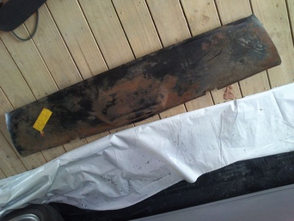

Managed to score a genuine front valance on trademe for cheap as, been sitting in the guys garage for years after he bought it as a spare, little bit of surface rust on the front but nothing major. Was happy with the one i made but nothing beats original.

And i got my seat back from my workmate, did a pretty good job.
only issue he had was sticking the bottom of the back down where you can see its bunched up a bit but he reckons it should stretch down and be fine after a couple months of sitting in it.

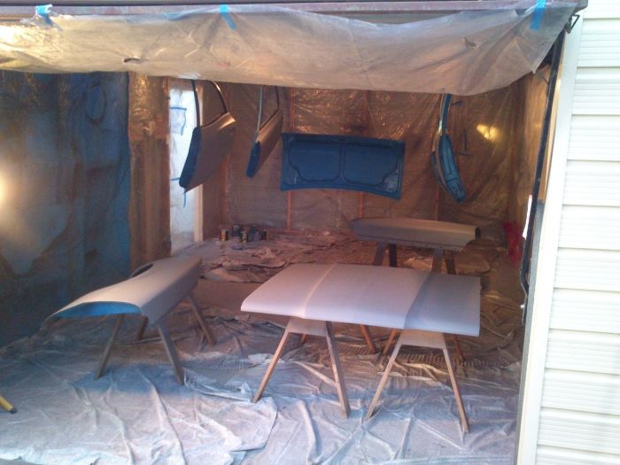

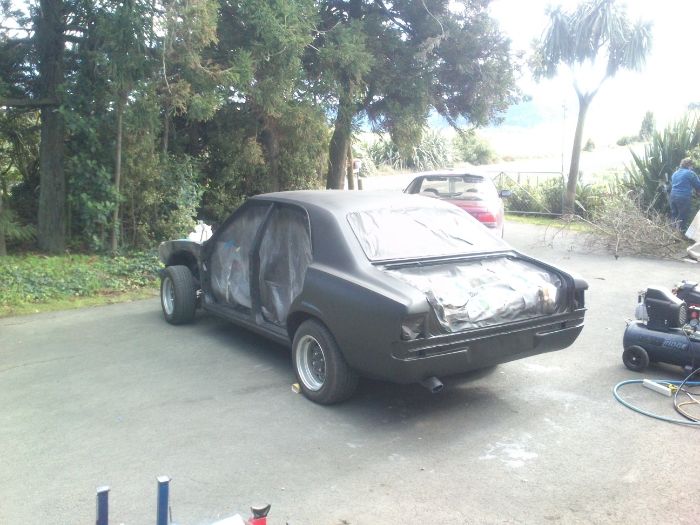

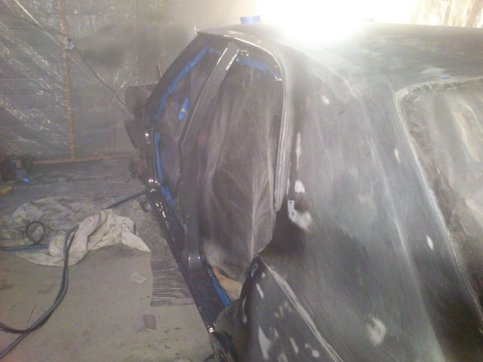

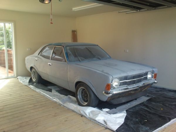

Finally got some proper car paint on the hussy!
Set up a paint booth in the olds garage and is working pretty sweet. Only have the sandable primer on at the moment (3 coats of the shit) then its blocking everything, 2 coats black undercoat, 2 coats colour, 2 coats clear. Its gona be a long process.

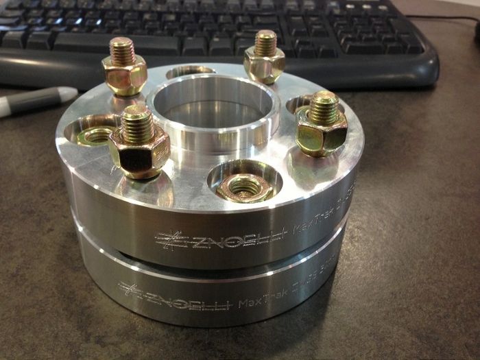

Got some spacers made up aswell, 30mm thick, keen to get it all back together now and see how it will sit with them

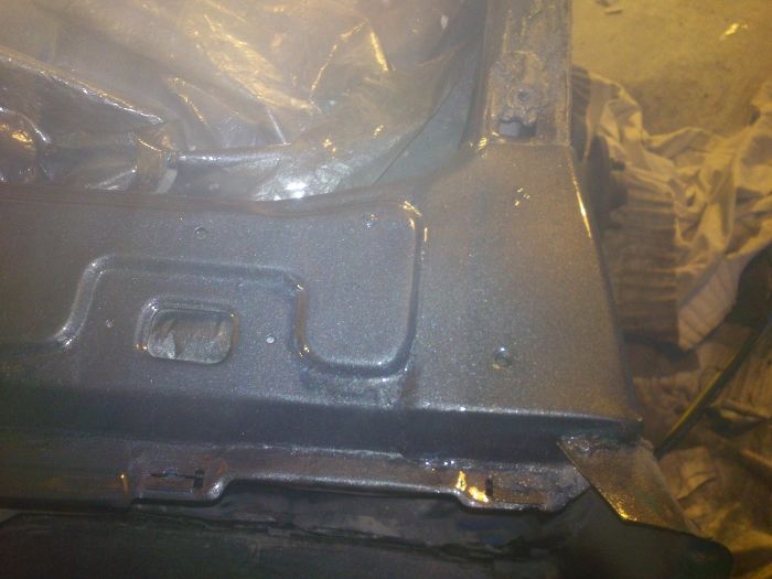

Got all the black undercoat on on saturday then blocked everything that arvo and this morning then this arvo got the door jams, boot lid jams etc in paint and clear. Now got to block some more, paint the inside of the doors and guards etc then bolt it all on and paint everything.
Fuck sanding cars.
Body in undercoat.
Photos pretty pooey because id just finishing spraying clear, that shit gets everywhere

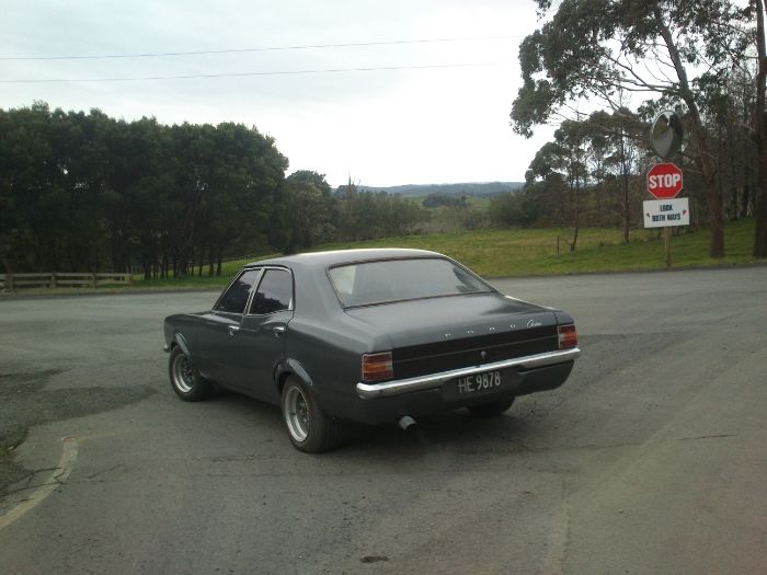

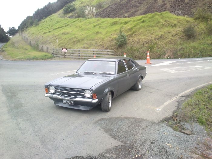

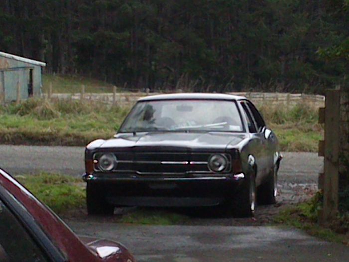

Got it all back together yesterday after letting the paint dry for a week.
Needs a polish tho but im stoked with how its come out. Now its onto tidying up the inside of it and sorting out things for a warrent, starting with the exhaust since it sounds like an aeroplane.
anywho pics!!

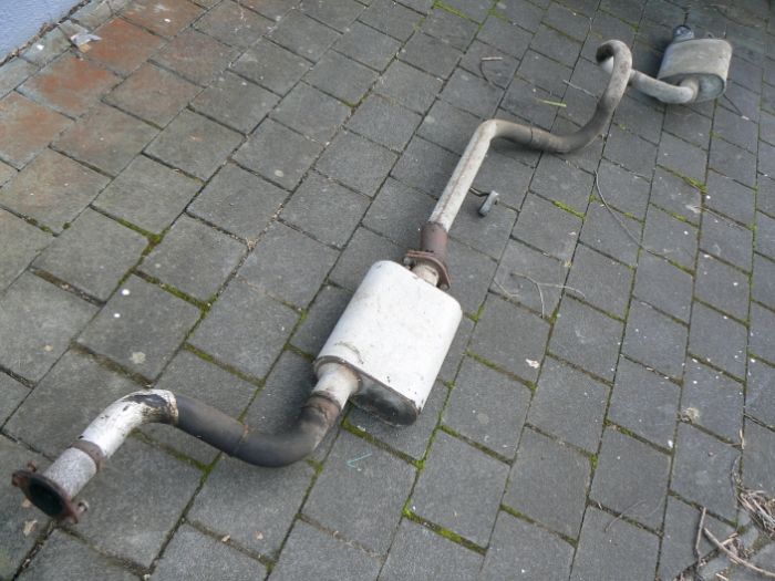

Scored a decent exhaust system off tardme today.
It was off a mk4 cortina originally but all i had to do was shorten the pipe where it bolts to the extractors.
Its 2 1/4" piping with a flowmaster muffler in the front and a super turbo muffler at the back.
Took it for a hoon and sounds heaps better. I did notice that when i had the revs high and foot to the floor it blew out heaps of white/greyish smoke, am i right to think that its all the crud and shit burning out of the 2nd hand exhaust ive just put on???
Ease my paranoia:  //oldschool.co.nz/index.php?/topic/34512-escortns-74-mk3-cortina/page-2#entry1145299
Also ive been looking into electronic ignition, What brands have people here used and whats the price like? ive been recommended this one: http://www.trademe.co.nz/motors/car-parts-accessories/performance/electronics/auction-645106022.htm but i dont want to pay that much if one of the trademe 100buk jobbys will do the same thing.

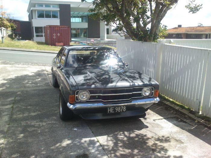

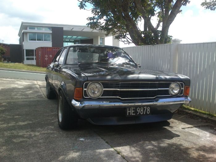

Wooop got the cortina a WOF on tuesday stoked as.
Theeeen i kind of bought what i like to think as a 'the cortina got a warrant present'

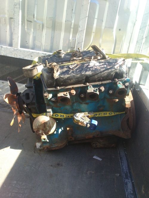

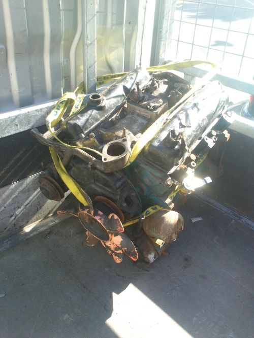

The famed 3L V6 Essex motor out of a Capri!
Haven't had a chance to pull it apart yet but im not expecting anything perfect, it was cheap. From the looks of the sump however someones had it apart previously and cut and welded the sump either bigger or to fit into something.

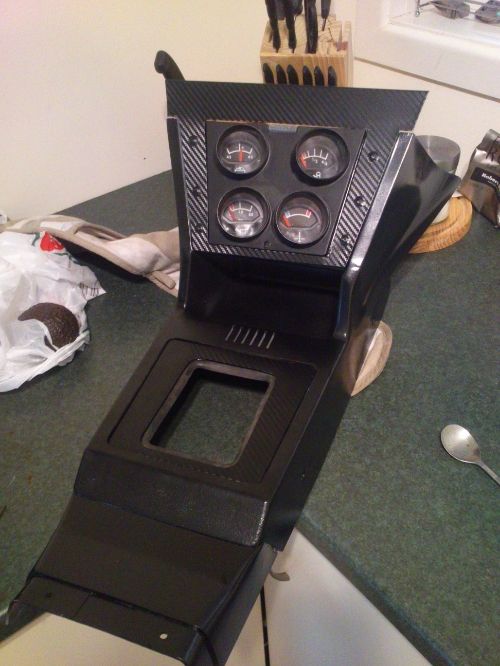

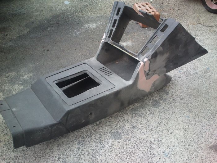

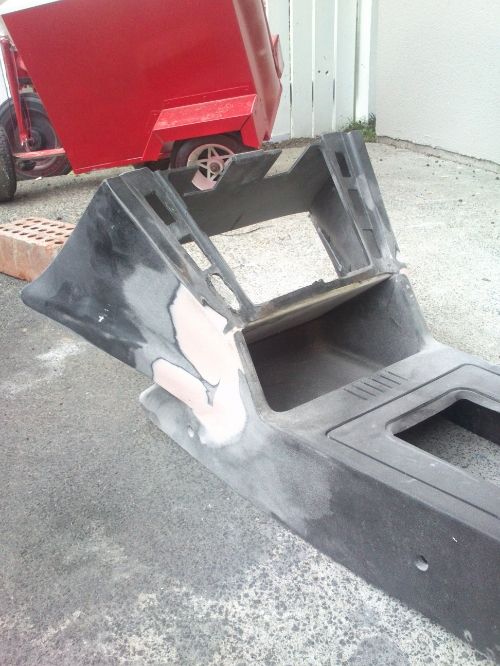

Ive also been playing around with the centre console. A while ago i bought a centre console gauge cluster out of a MK3 GT Cortina but it was a bit cracked in places and was missing the piece that went over the gear stick and joins to the piece that goes over the handbrake, i then found a MK5 cortina center console that just covered the gearstick and joins up to the handbrake cover luckily. So with some rivets and plastic putty i came up with this...
I used a small sheet of ali to cover the top of the mk5 piece to make a tidy compartment.
Along the line someones cut the rectangle holes in there (no one needs that many switches) so i made a cover and used those to mount it. The GTs dash is different to mine and slopes down steeply where mine is more like that of a mk2 escort so i made the cover to also try and fill the gap and bring the console into line with the dash.
Painted it all black and used that carbon vinyl crap for my front cover (covers up the rivets and scratches really well i reckon) Now to make mounts to fit it to the tunnel and see if it looks any good in the car.

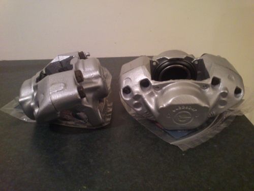

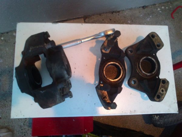

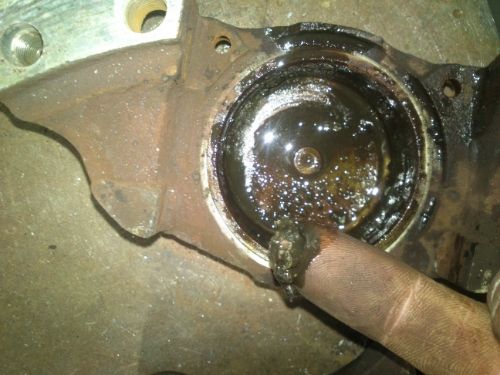

So my front brakes packed up a few weeks ago. Front right siezed so i decided to strip, clean and rebuild both fronts.
They were both in pretty bad nick when i pulled them apart, looks as tho they hadnt been bled in years!

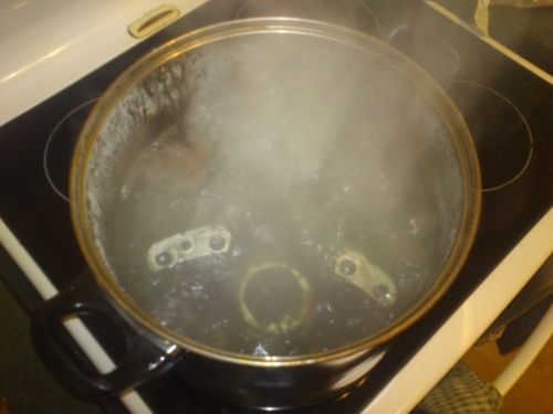

One of the pistons was siezed in so i boiled it for a bit then popped it out with a compresser. (Dont do this if your better half is going to come home within an hour, it makes your place reek!)

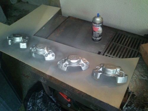

Chucked in a new seal kit and gave em a lick of paint.
After i bled them the pedal was still going down way to far. Had a look at the master and found some fluid leaking down from where it bolts onto the vaccuum doofer, so chucked a seal kit through that aswell (no pics coz it was giving me the shits).
Bled again and it was alot better but it still feels like it goes a bit to far. Ive bought some braided lines aswell but their yet to go on. Looking into getting the master resleeved then putting them in. Theeen i can concentrate on getting my gauges and centre console in.
