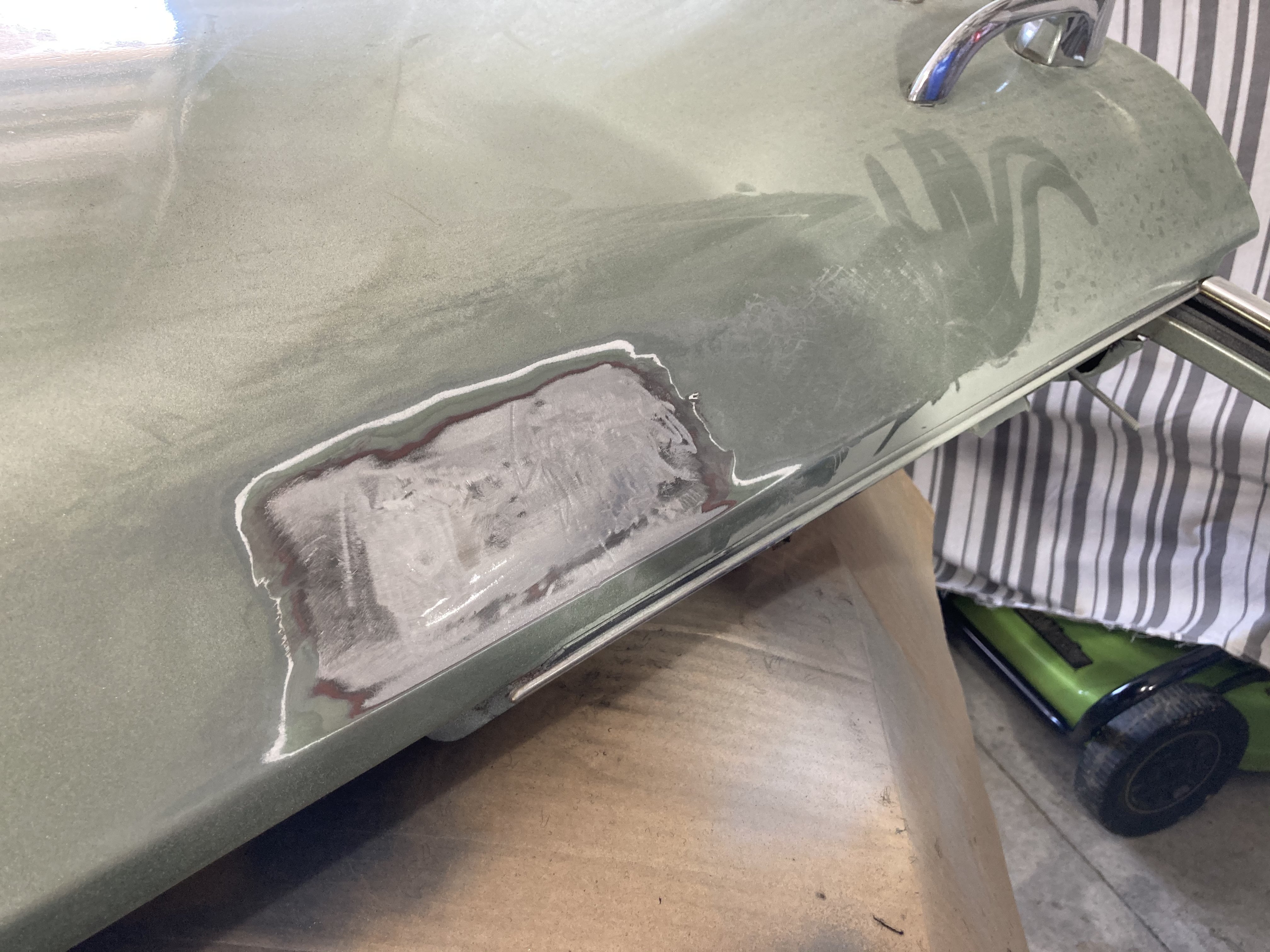

Popular Post AllTorque Posted May 6, 2020 Author Popular Post Posted May 6, 2020 Picked the next spot. After the big piece on the corner this was so easy. Nice to see my skills improve. Starting to get the welds dialed in. Should have stripped the paint back further. 22 Quote

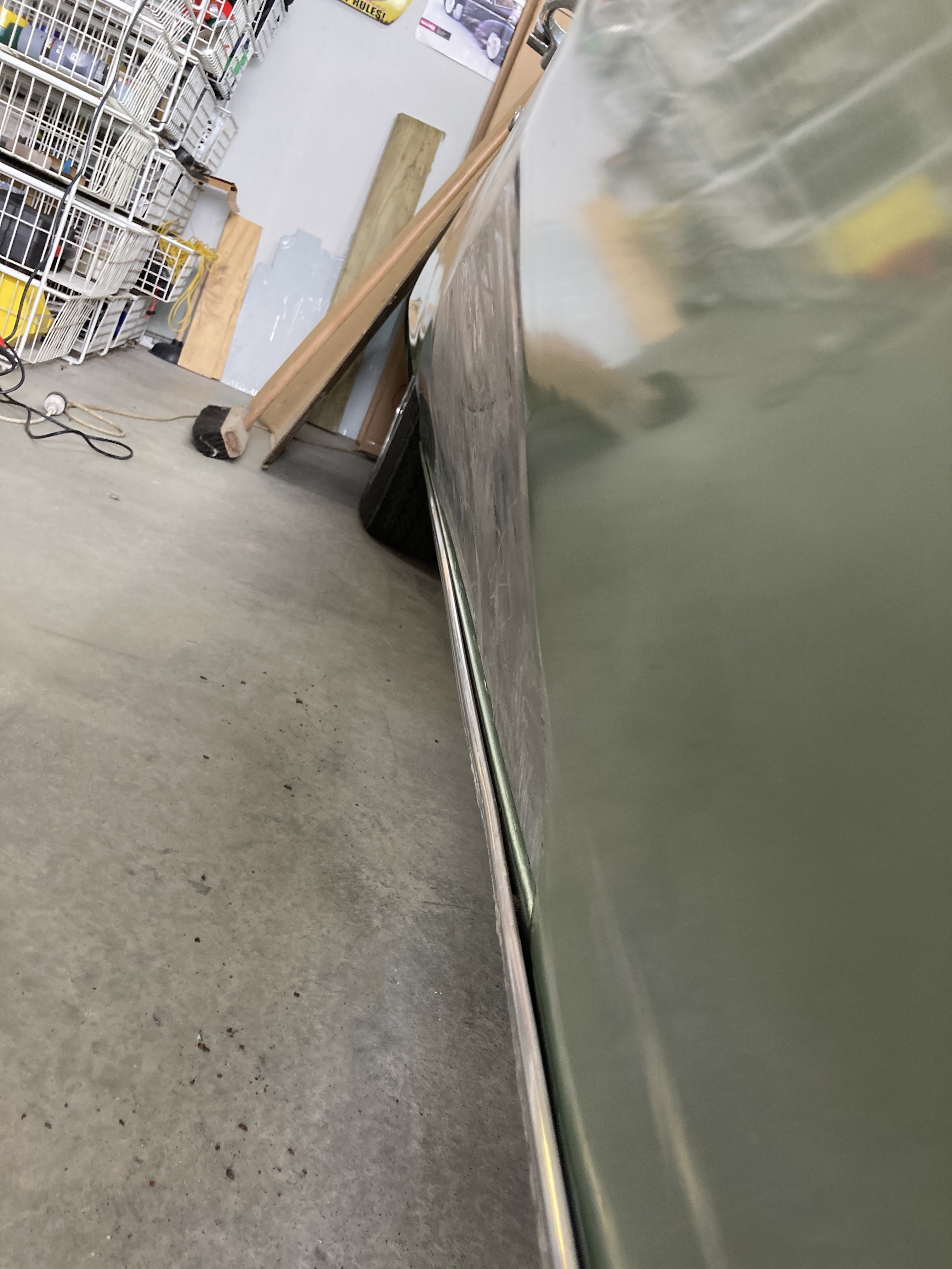

AllTorque Posted December 13, 2020 Author Posted December 13, 2020 I put the door back on to check the body lines. Hit it with a hammer in a couple of spots but pretty happy with it considering the bog I took out. 5 Quote

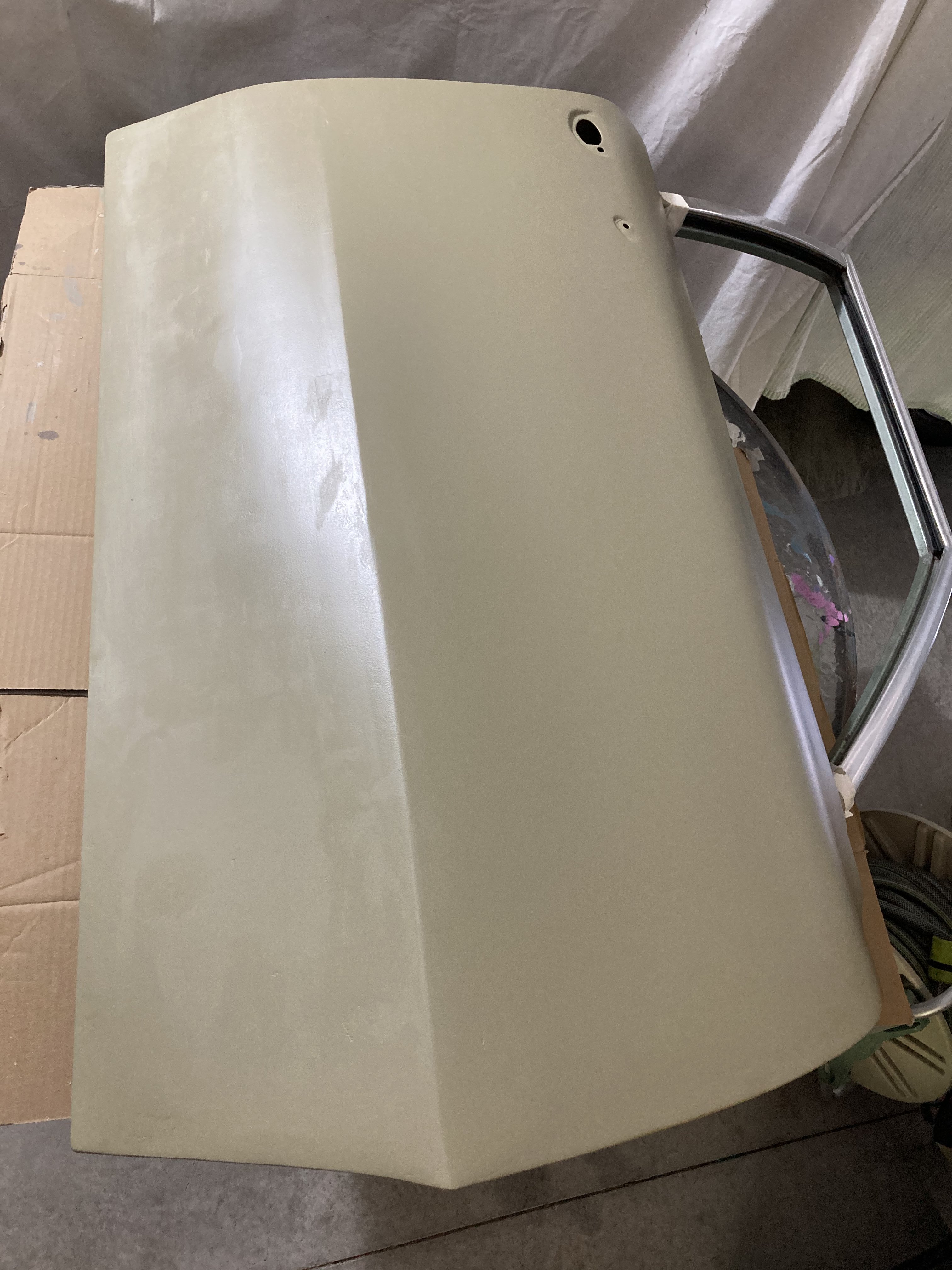

AllTorque Posted January 25, 2021 Author Posted January 25, 2021 I wasn’t sure if I was going to post this cock up. A bit embarrassing. First time I have used 2 part primer and bog that’s not newtech. Start of January I mixed up too much epoxy primer and slapped it on way too thick. Info sheet said to add filler after 25 minutes. I thought that was a bit soon, so waited a couple of hours before I mixed up too much bog and slapped that on. Checked on it a bit later... FAIL After a week of feeling sorry for myself I ground it off again. and put on a thinner layer of primer. 6 Quote
Popular Post AllTorque Posted January 25, 2021 Author Popular Post Posted January 25, 2021 Thinner layer of filler, a few days later this time sand, bog, repeat... Close enough for 10 days before Wagnats and seal her up with epoxy primer It will need a bit more work, but at least it’s good enough to go out of the shed. 27 Quote
