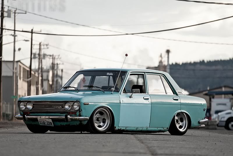

after that just a skim of filler, primer, a quick paint with some colour match rattle cans and fix the exhaust and should be wof time (sounds easy when you say it fast :) )
then hope to have it sitting like this:
oh yeah

the ratsun from the random piccy thread has motivated me decide to drop my spare leaves and springs in to Snells to get reset this week too, so im looking forward to seeing lil blue closer to the ground with matching mis-matching blue panels, 'patina', and slot mags 8)
