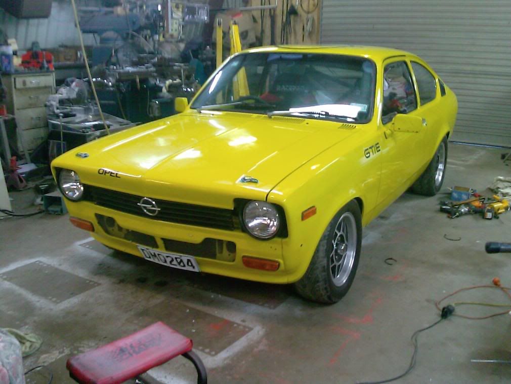

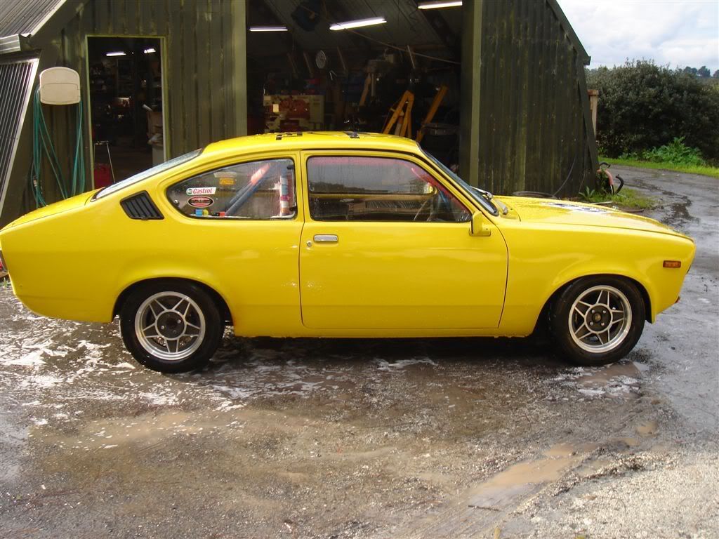

1978 Opel Kadet race car.

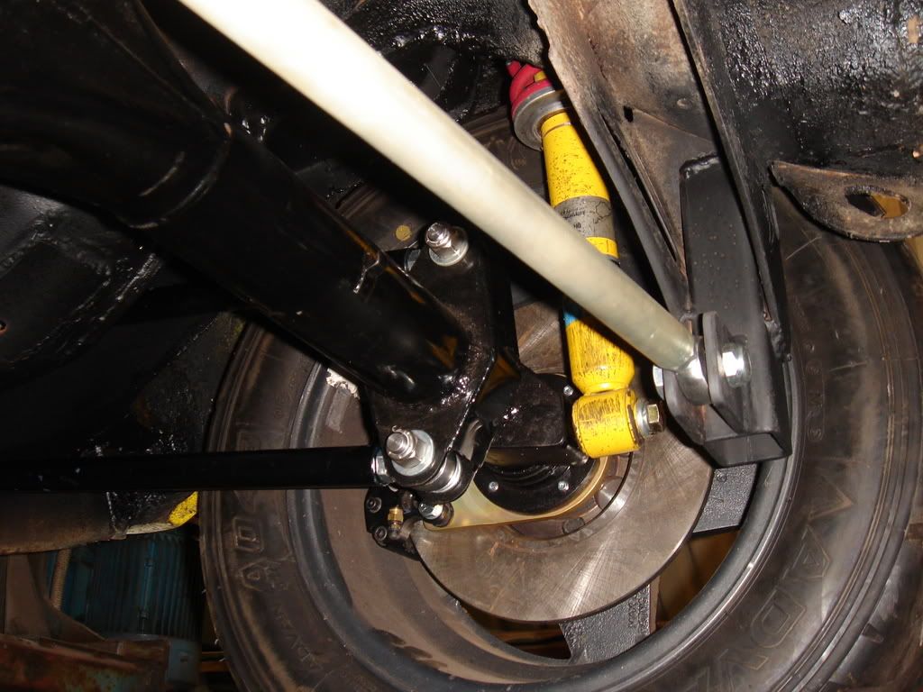

Bruce Kirk's ex racer, it was essentially a complete race car minus the rear end, seats and belts when I bought it hence I took it to my good friend Tony Lynch of lynchbuilt (Race car fabricators). Bruce had cut channels to four link the rear but hadn't gone much further.

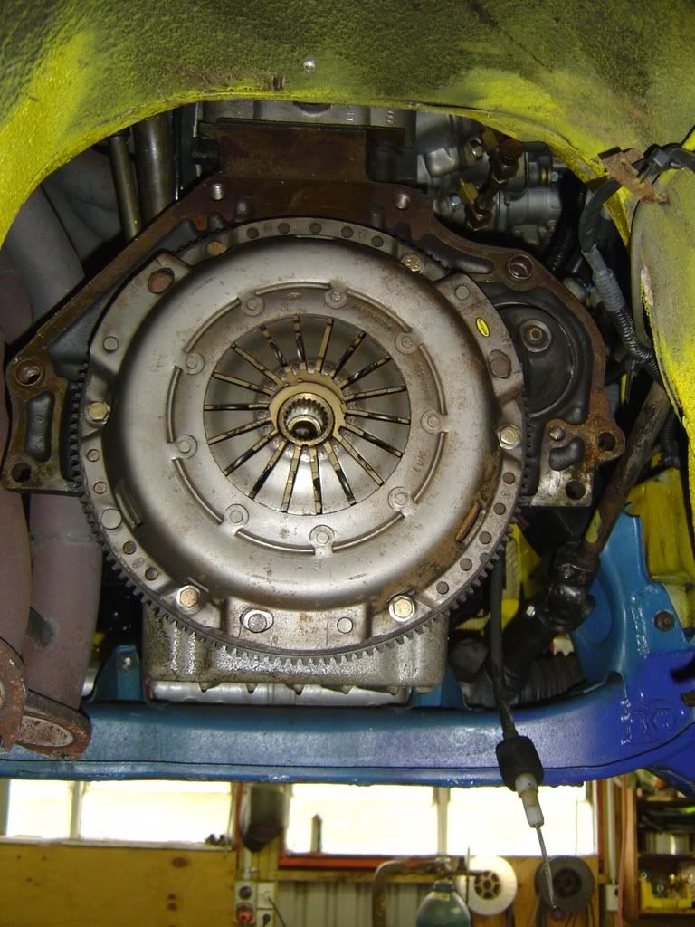

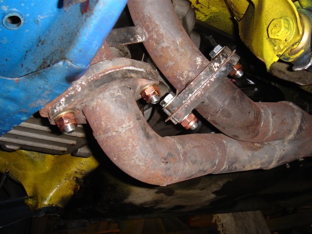

Vauxhall / Opel C20XE twin cam 'Redtop' motor running twin 45 Webbers
Electronic ignition

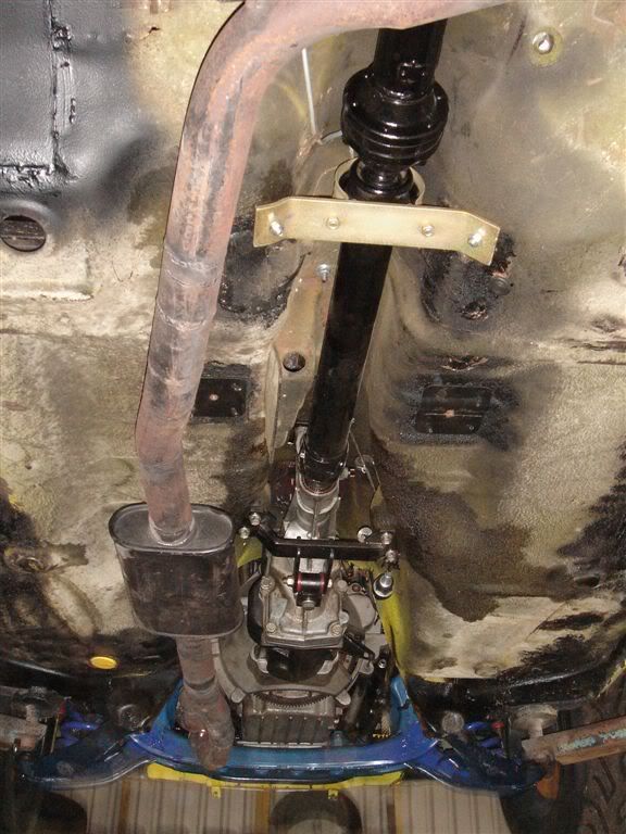

5 speed sierra with short shift kit
Complete Suspens coilovers all round

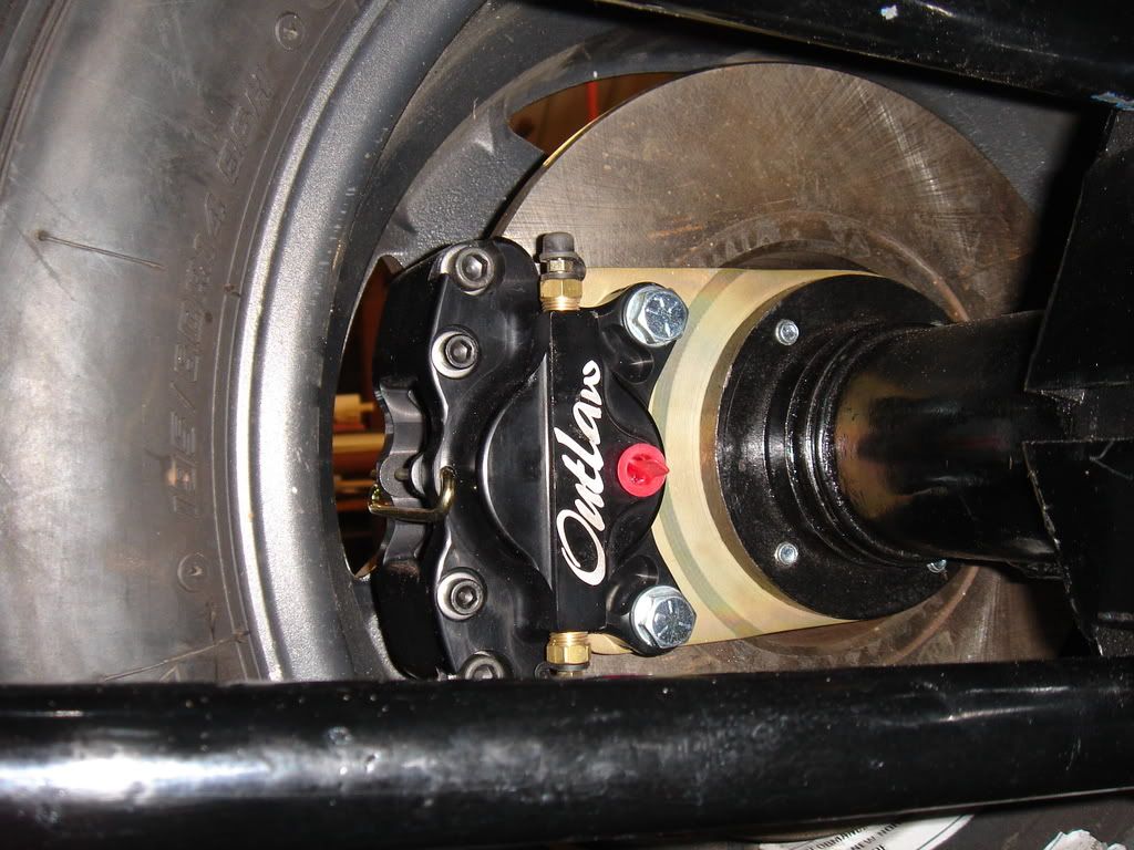

Willwood Brakes up front and new discs and calipers at rear, hydraulic handbrake

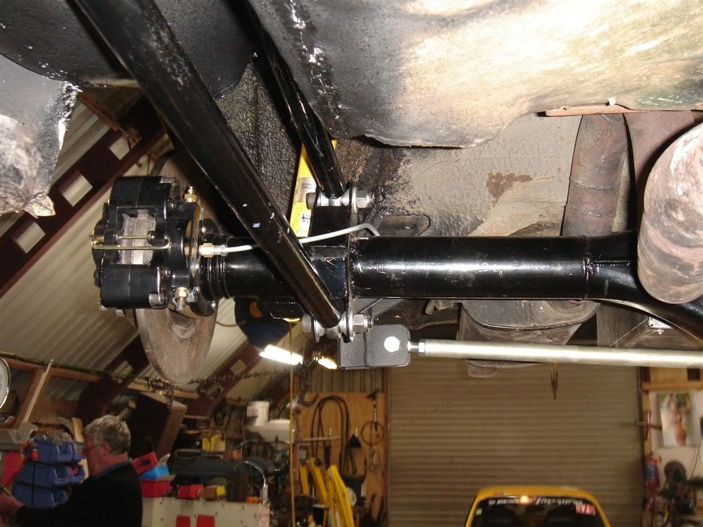

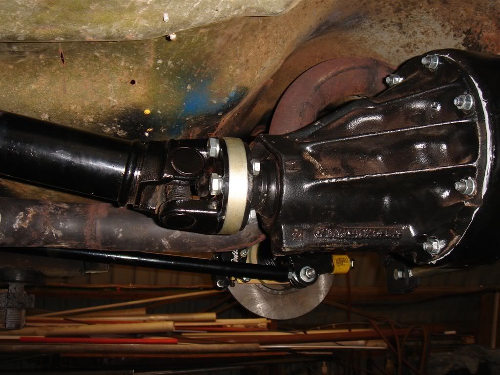

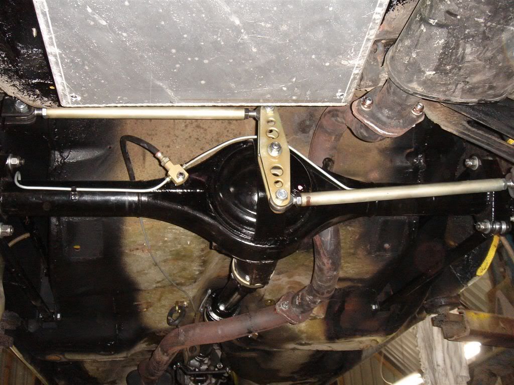

Ford Escort Diff with Quaife LSD head four linked with watts linkage

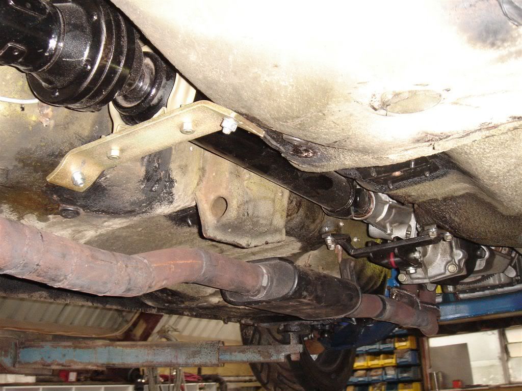

Holden two piece drive shaft

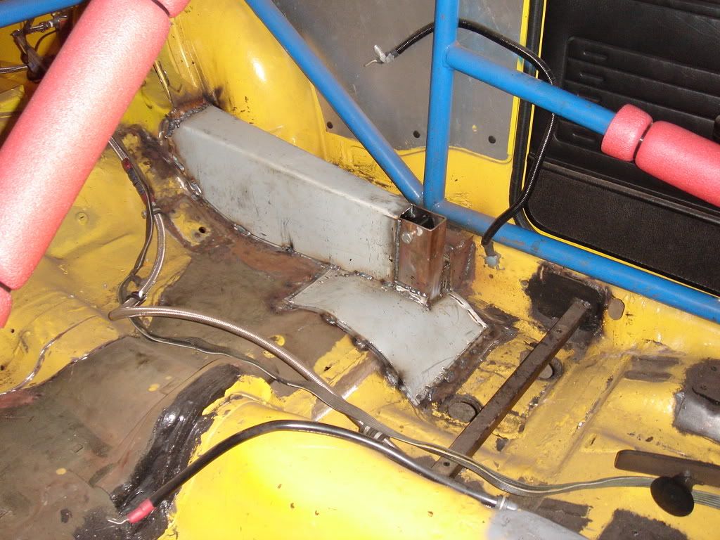

Full cage

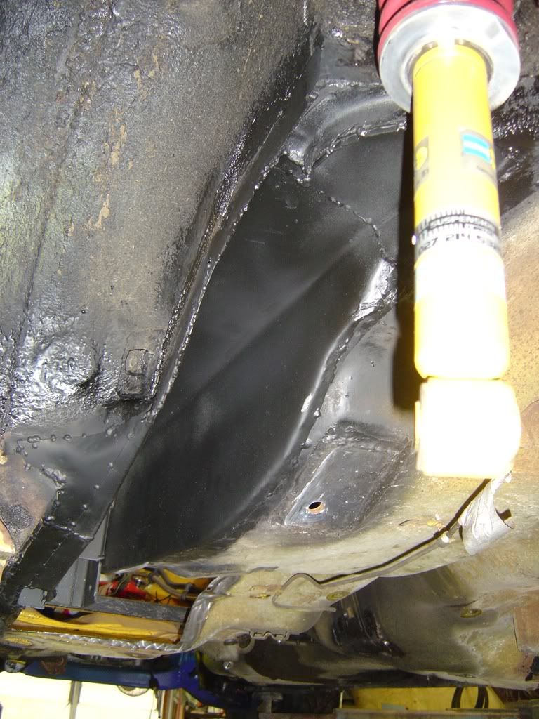

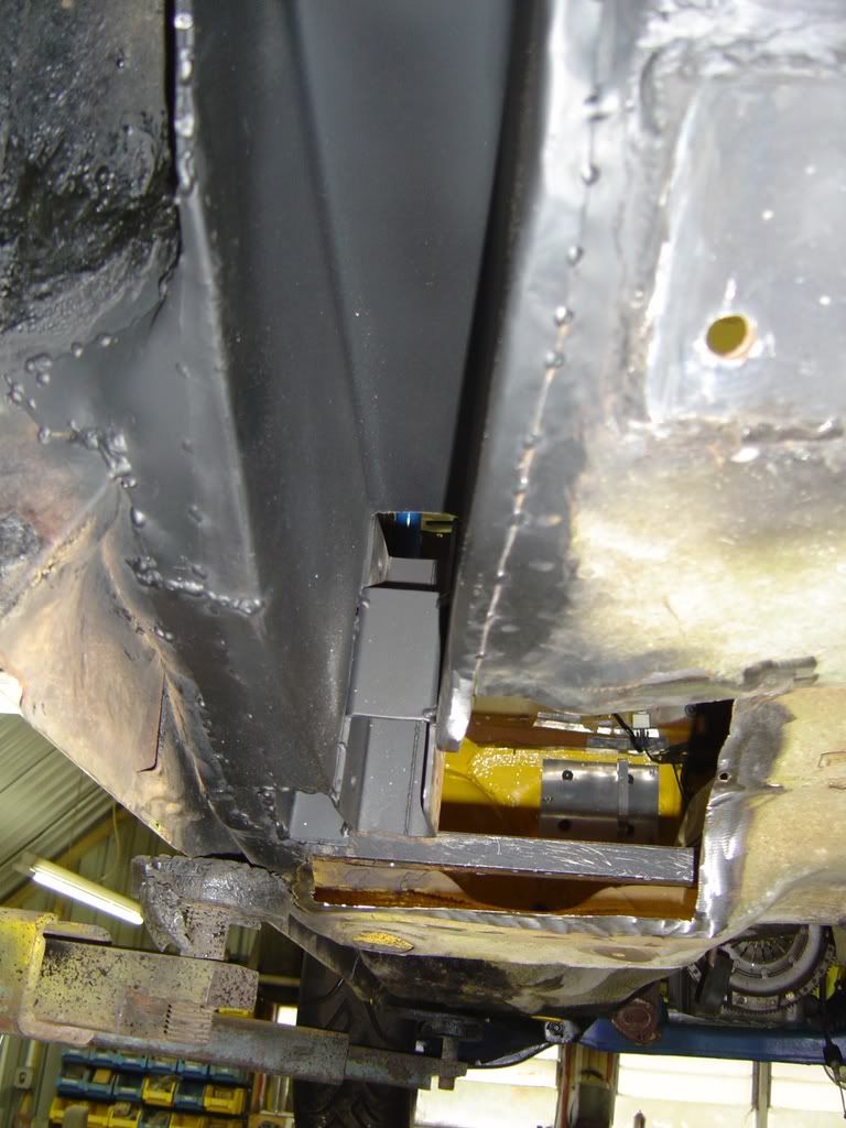

Rebuilt the channels and floor where previous owner had attacked

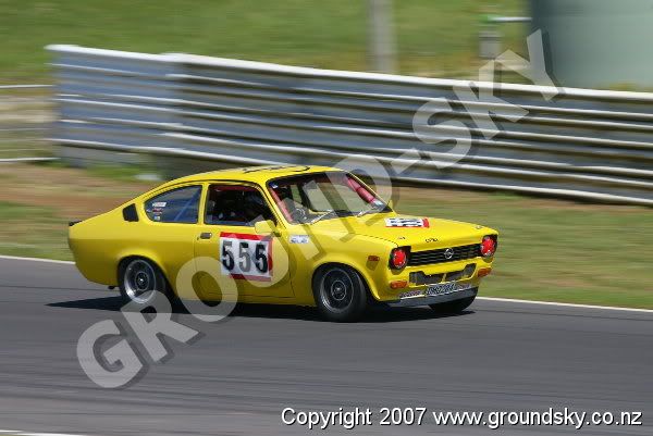

Here's a few pics of the build to date and some of the car in action at Puke last year.

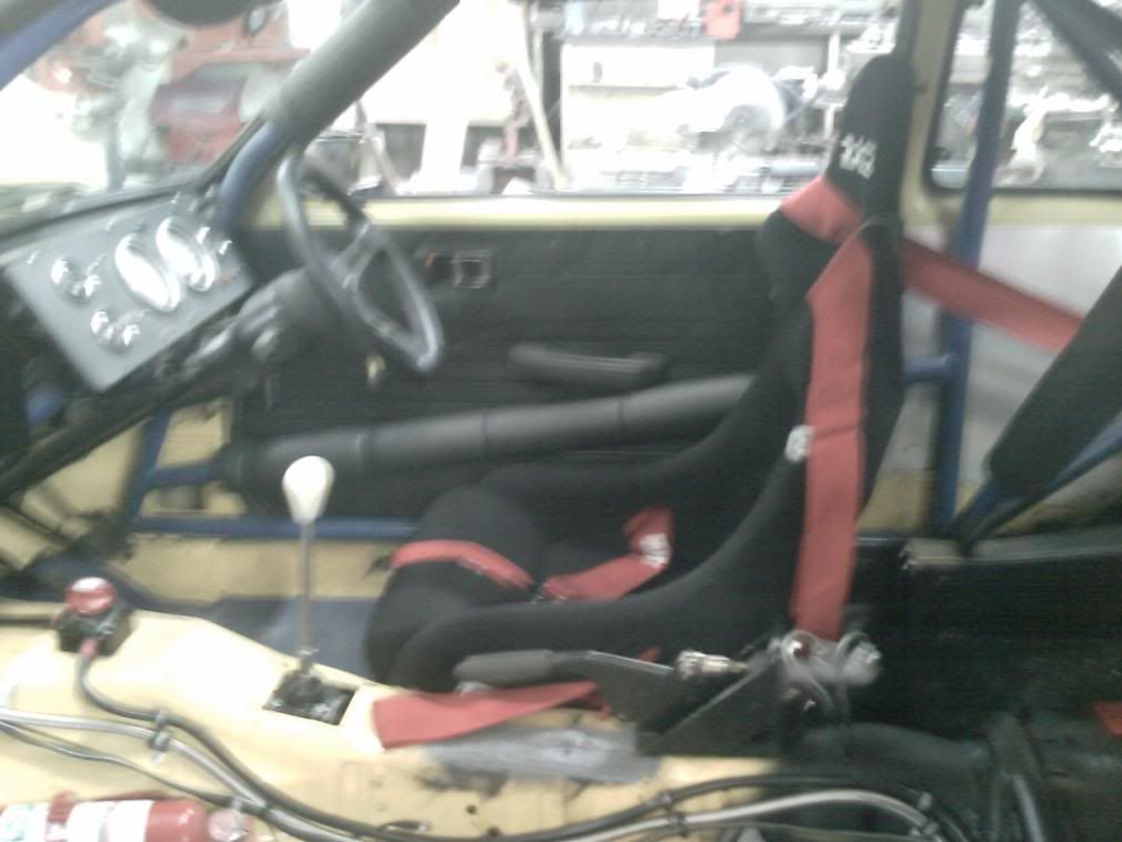

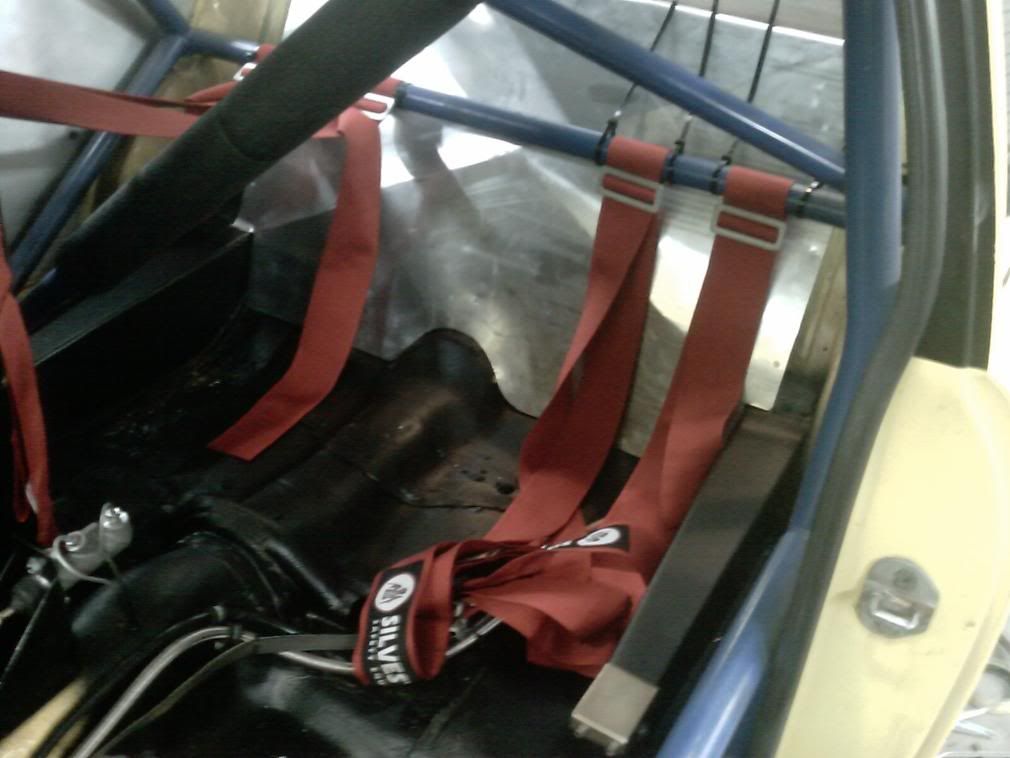

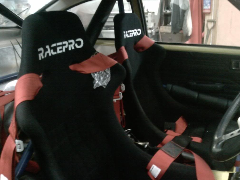

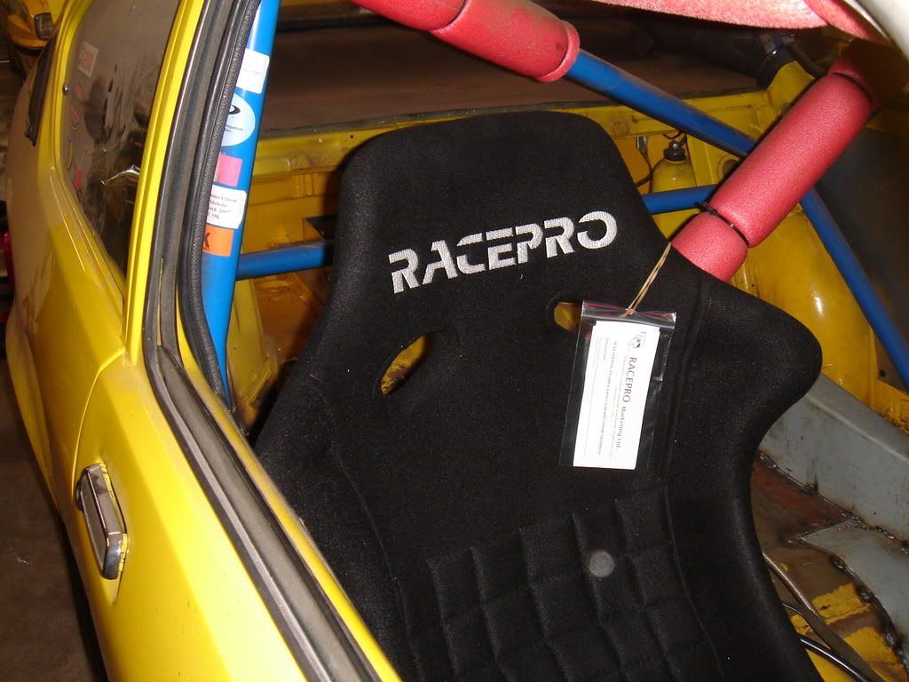

Another update lads....it's almost there. I went up for a seat position measure up.

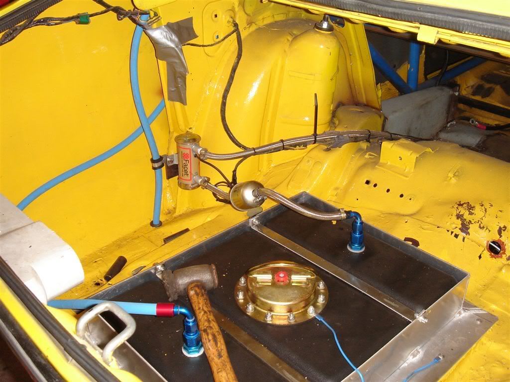

ALl suspension and floor rebuild complete, needs some paint inside.
THings to do:
Put gearbox and drive shaft back in

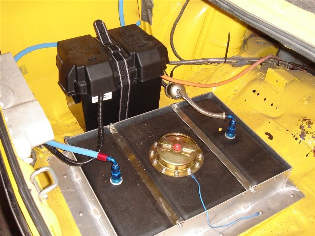

Install battery in the boot
Finish fuel cell box and connect fuel lines
Mount computer in a proper bracket and sealed container
check all the bits and bobs and hopefully fire her up for a test drive!

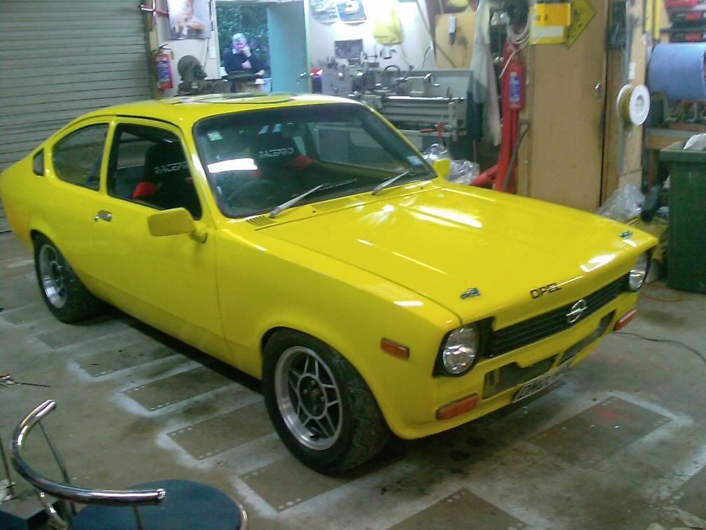

Well well well...it's been a long day but a very rewarding day indeed!
Everything is going! Everything! Simply need to mount the seats in and tidy up the welds/paint and we're laughing.
Can I just say that it sounds awesome! Think BDA escort screaming through the forests and that's kinda what it sounds like.
