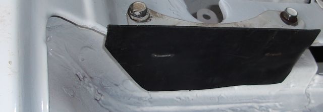

  12. Cut these little brackets out of galvanised and new rubber as the old ones were completely rusted.
