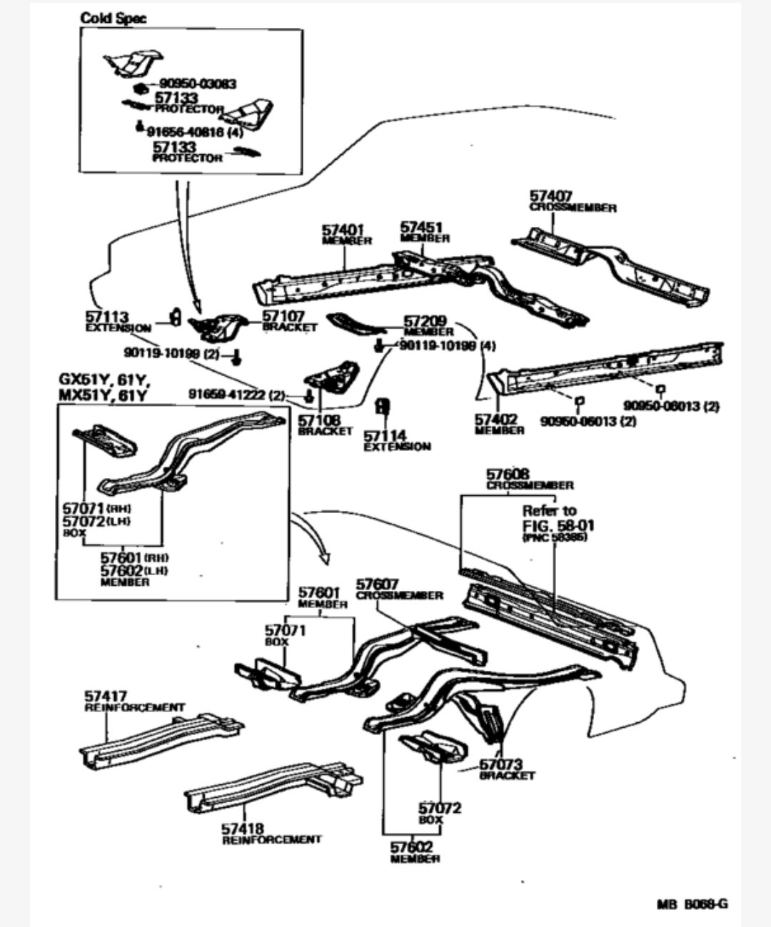

Wanting to IRS convert a low spec (solid rear) 80s toyota mark ii/chaser/cresta. They have the same floor pan and I have taken the braces between chassis rails and outer sills for the subframe pickup points from an IRS parts car. Is this a straight forward swap with regards to cert if using factory parts? 57071/2 are the braces i kept still attached to section of chassis rail and outer sill for correct placement while im here do i convert rear to take an s13 rear coilover (beef up trailing arm pickup and put strut towers in rear)
