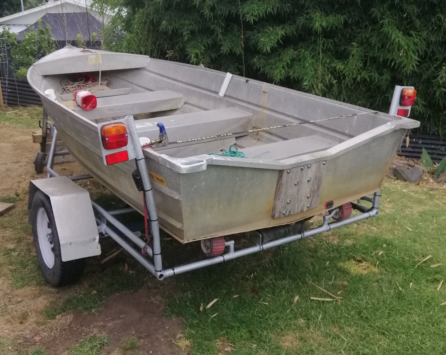

Latest little mission on this has been replacing the drain bung. Some muppet must have lost the bung out of it, and screwed a completely incorrect metal plug into it. Just horrible. Perusing TradeMe under marine drains, bilge drains, every other description under the sun didn't produce anything that was a 3 bolt mount like this had. Eventually googling 3 bolt plug (or something that it wasn't really how I'd describe it) I found a hit. It took me to a live Trademe(?!?) auction. Nairn brand from Smart Marine. Bought two, ones a spare. Installed and its ready for sea trials. Also built a rough frame and covered it up with a tarp so it doesn't fill up with leaves or water
As you can see it keeps the water out.....

Scored some 13x5 trailer wheels for $180 locally off Marketplace.
Smashed out an axle this afternoon. Unfortunately the new wheels don't go into the spare carrier. Track has increased 60mm or so, about 20mm higher than before.
Left to do.
Fabricate a new spare carrier.
Cut the old one out.
Waterblast and paint wheels and axle.
Make new wider guard mounts and fit
Touch up paint after modifications.
WOF.
Boat needs engine mounting, I've decided to bolt it on permanent until I can find a 15hp.
A complete new drain bung you can operate without a spanner.
Wish list is a screen, canopy and a depth sounder. Next year.....
