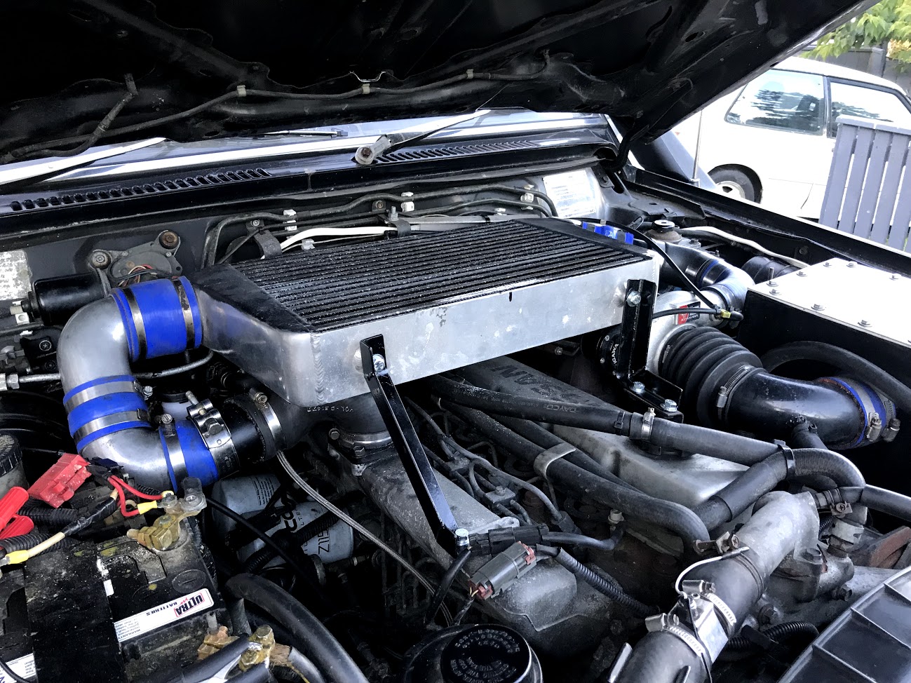

  10. Plus there is heaps of room above the engine, even on a 29deg day in a 50km zone it was cooling well, cold to the touch on the 'cold side'.
  11. Originally I fitted a water to air intercooler for the best of both worlds, but it had a leak so it got water into the intake (it was from an st205 GT4 so pretty old). I decided on top mount because I still have working aircon so bugger all room, I only just got the w2a radiator to fit. I'd have to hole saw big holes for FMIC plumbing too and didn't want to do that, technically would need to be certified again too.

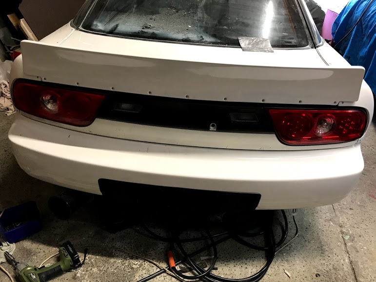

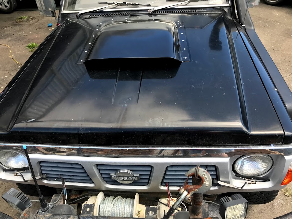

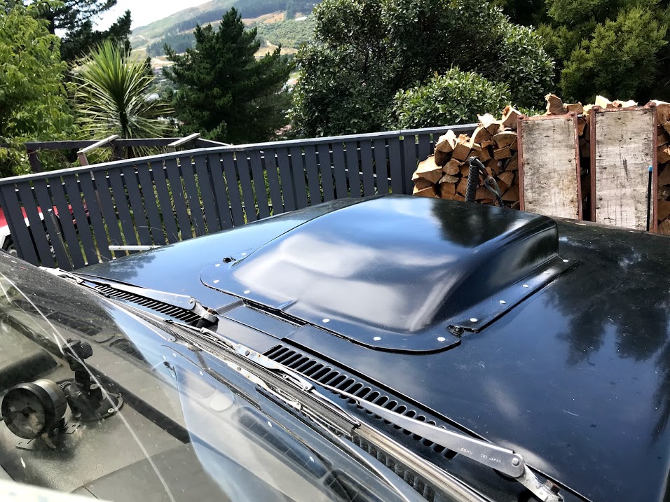

  15. Wet sanded and polished the front drivers side guard, came out nice. Fitted rear lights, I decided to try some aftermarket lights that came on the 180sx I imported. They are type x 'style' LED things, I don't really like them (they look OK... I hate aftermarket lights though)... but I'll leave them on until I get some genuine ones since I do have the genuine Type X centre and lower panel (I haven't painted this yet). Alternatively I could use some non-type x ones with the different centre and lower panel, I had intended to use those on the other project 200sx.

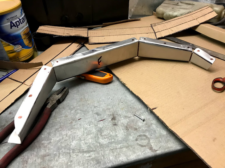

  16. Yep my thoughts too, I'm looking for a 24v fan to suit so I don't have to stuff around with 12v things like I have before (i.e. the water to air setup which drained batteries due to inverters etc).

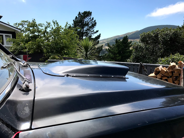

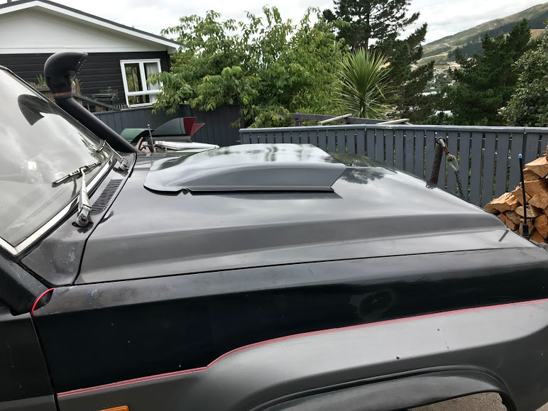

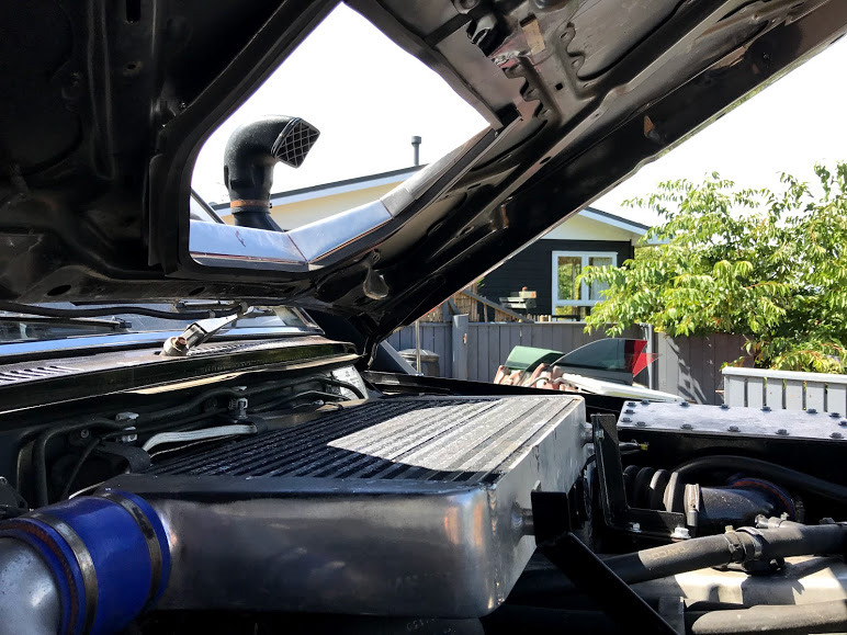

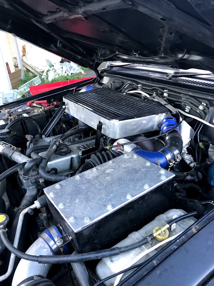

  17. Scoop fitted! I used silicon glue UV and heat resistant stuff, and some big rivets. I sealed the back in the centre with the same sealer, want as much pressure as possible to stop under bonnet hot air trying to push out (from radiator and below engine). I went for a quick test drive, it was hot as fck the thermometer read 28deg in the shade. But I took it for a drive, running over 1 bar of boost previously (pre scoop but with bonnet hole) made the whole intercooler hot. Now I can put my arm right in the scoop and feel the inlet side is hot (easy to touch) and the outlet side is cool! Might still fit a fan below it for slow moving 4wding.

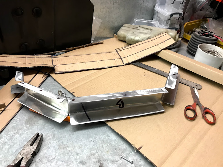

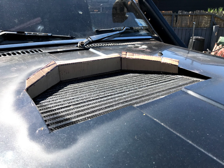

  18. Aluminium air blocker thing finished and riveted on: Top view, because I was on the deck. Inside view with rubber foam tape to seal the frame with the intercooler surface: Scoop sanded and painted. I am reminded of why rattle can spraying sucks...but it turned out ok. When the paint is dry I'll silicon glue and rivet it on:

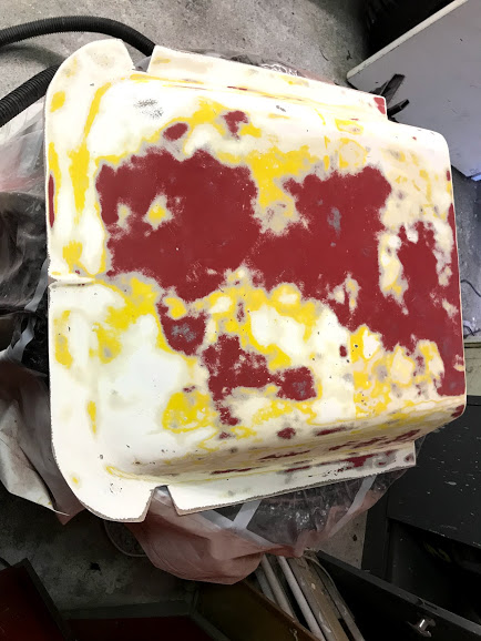

  19. Then I cut the Torana scoop a bit shorter: It's a bit rough with cracked paint etc: Sanded a bunch: High fill primered: Filler because I love sanding:

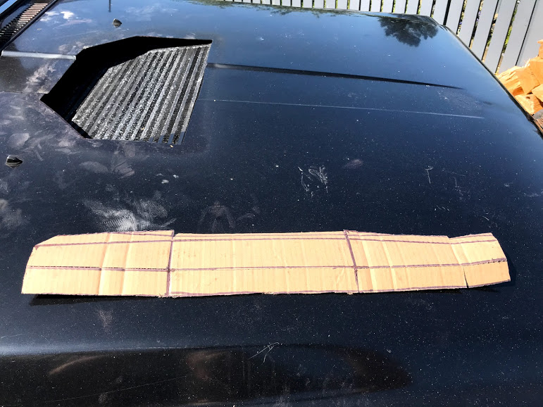

  20. Time for a bit of CAD work to close up that gap. Template: Test fit: Cut out in aluminium sheet: I'll rivet it on, then make the side bits to enclose it then some thick rubber foam tape to seal with the intercooler.

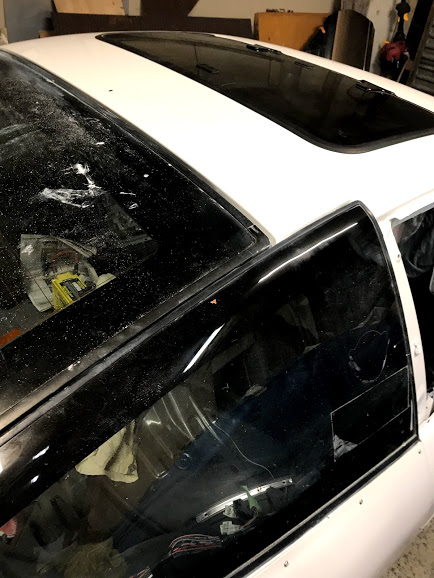

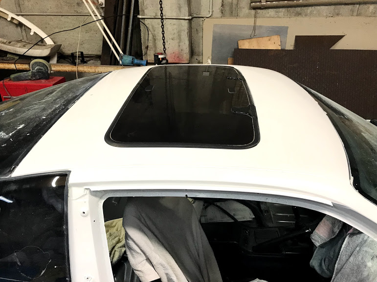

  21. Best update yet: Sun roof installed, it's a simple lift up type so I plan to try make a fibreglass or carbonfibre mould of the glass to reduce weight. The glass is pretty heavy but I just put it back in for now so I can get it going and ready for certification, still heaps more to do before then. Phwoooarrr....sunroof, being all...sun roofy.
  22. I was going to try find a Version 8 wrx scoop but then I found a Torana fibreglass scoop which is wide enough. It's way too long but if I shorten it by maybe 1/3 it'll work. Dummy fit and a rusty Triumph: After a little thought, I cut a big hole in the bonnet. Not a rectangle because I didn't want to cut too much of the frame: Now I need to figure out a way to seal the gap so the air doesn't just go straight through.

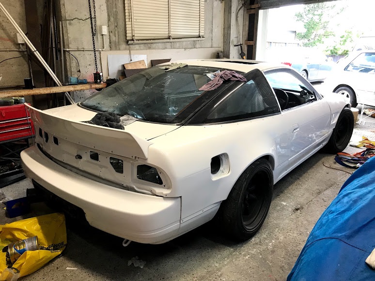

  23. Had another baby, so progress is super slow. Bumper painted and fitted: Guards and front bumper painted but still need wet sand then polish. Bonnet and headlight covers were already painted white so they are the wrong shade. Will do them at some stage.
