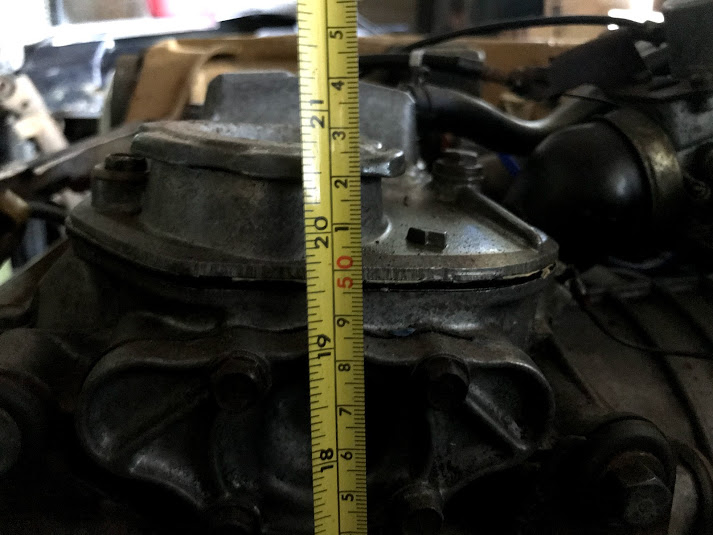

  6. Sanded this stuff and ordered some primer, then went to measure the N360 just because.

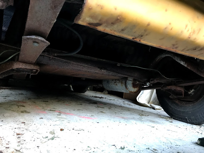

  9. The plan is to fix rust, get it running with 360cc engine and get it on the road. But I can't stop thinking about what I could do to it, the fact its so light keeps me coming back to a bike engine using the bike gbox. Ideas so far: 1. Tiny turbo RHB31 VZ21 the 360cc. 2. Tiny supercharger AMR300 the 360cc 3. FWD bike engine car (BEC) using R1 1000cc and modified Civic fwd diff and shafts (might need to cut firewall). 4. VFR800 rwd if I can move the engine far enough to the passenger side to get the output shaft close enough to the middle, then a live axle with normal diff. Problem is the ratio needs to be at or less than 3.0:1 which isn't going to happen since most small diffs are around 4:1 or 5:1 5. Semi copy that vfr800 one of youtube and use an IRS rear end (mx5 or S13), run normal prop shaft and no reverse. This would be at best 3.6:1 so it would be revving its tits off at 100kph. 6. IRS rear, modify the diff to run a sprocket like they do with the fwd ones. That way the diff ratio is open to what ever size sprocket(s) are used. This also means it would need to be a mid mounted engine for the chain and it's much further than I wanted to go with the car, not even sure it could be road legal. A sprocket diff solves the diff ratio problems and makes it easier to have electric reverse but it also has its own problems. I could possibly run an inline car gearbox but again it gets very complicated with driveshafts So..... the easiest options: FWD - leave it factory and 27hp. FWD BEC R1 (compact) and sprocket diff RWD The easiest way to make it rwd is a no reverse, live axle leaf sprung, 'normal' prop shaft, front engine (has to be compact enough to mount north south). This literally keeps me awake at night.

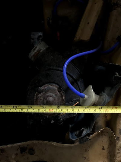

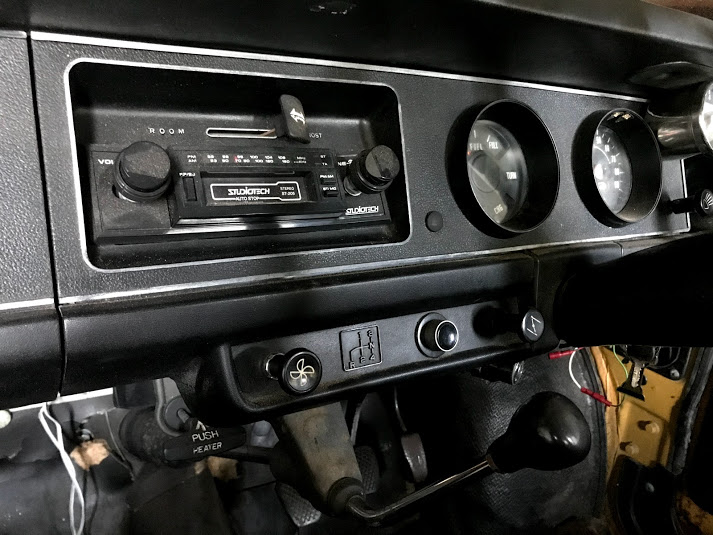

  10. The dashboard is in such good condition considering the body is so neglected: Waiting for doors and panels from Aus, the doors and some other bits should be on the way soon. Some other parts will need to wait a week or so to cut out. The doors are rust free but a bit of damage to fix, still a much better starting point. Have a lot of ideas about what I could do with this once it is fixed body wise, so I did some rough measurements of the engine bay: About 54cm from the current subframe to the top of the engine, could gain a bit from modifying the subframe and free space to the bonnet. Almost exactly 50cm from the firewall to the grill (under the support). On the passenger side there is a heater fan motor housing jobby, it doesn't look like all had this but it could give some more space. Roughly 80cm wide if I try fit a v-engine which could overlap the sides: C Live axle (well dead axle) leaf spring rear so there is the possibility of a live axle diff for rwd?
