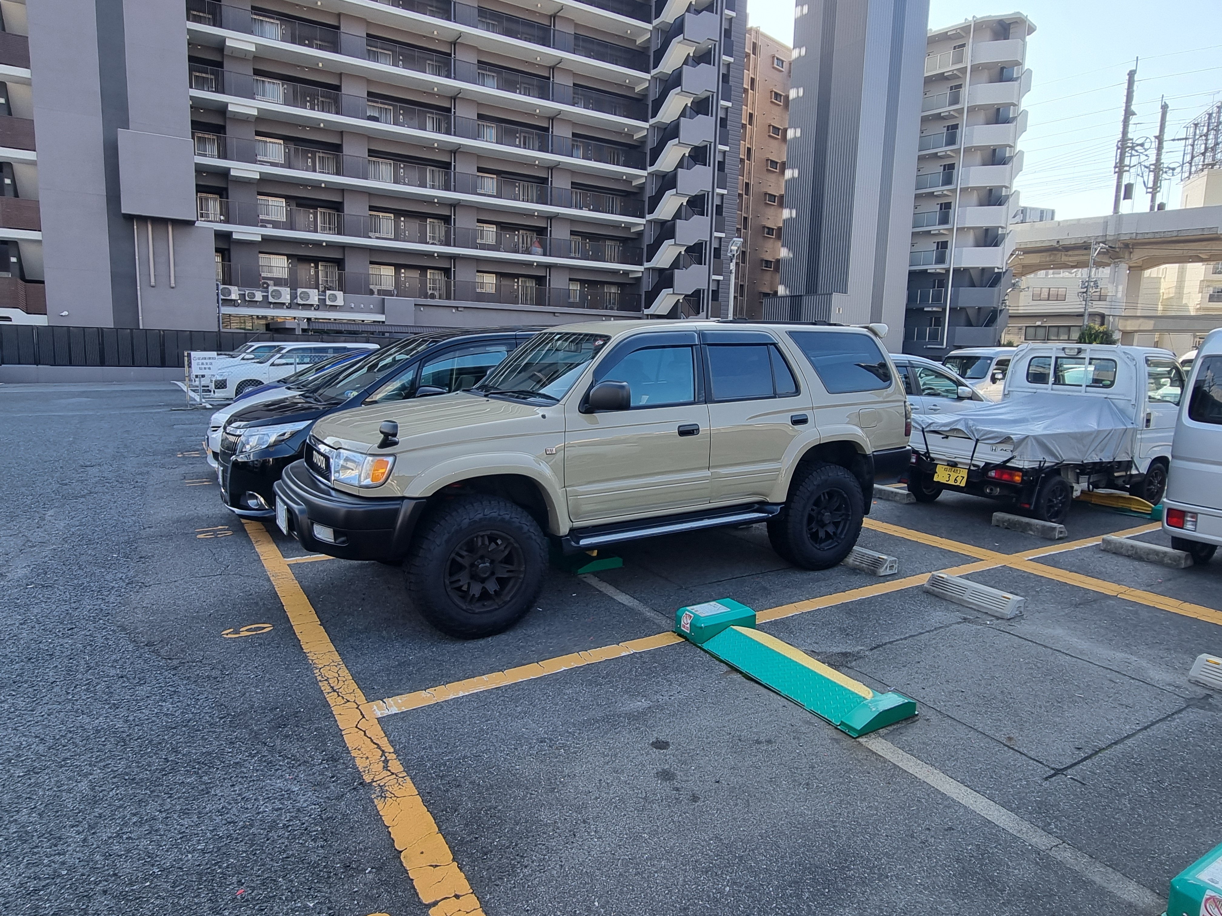

I bought (almost) all the suspension replacement parts for the front end.
Upper and lower ball joints, upper and lower inner bushes, new sway bar links, new rack ends and tie rods and sway bar bushes.
What I didn't buy was the camber adjustment cams that cannot be removed because they rust weld themselves into the bushes and you can't get them out without destroying them.
I found this out after id almost fully disassembled the left side.
So lots of parts got replaced but not the inner lower bushes. I'll order the adjustment cams and finish the job.
I didn't bother taking the drivers side apart, I'll get all the bits first.
It fought me all the way to get this far but whatever.
And a special shout out to the joker who did the lower balljoint last time and put it back together with longer bolts that bottomed in the holes so he just gave it more ugga duggas and called it good.
Both bolts broke when I tried to get them undone.
10
