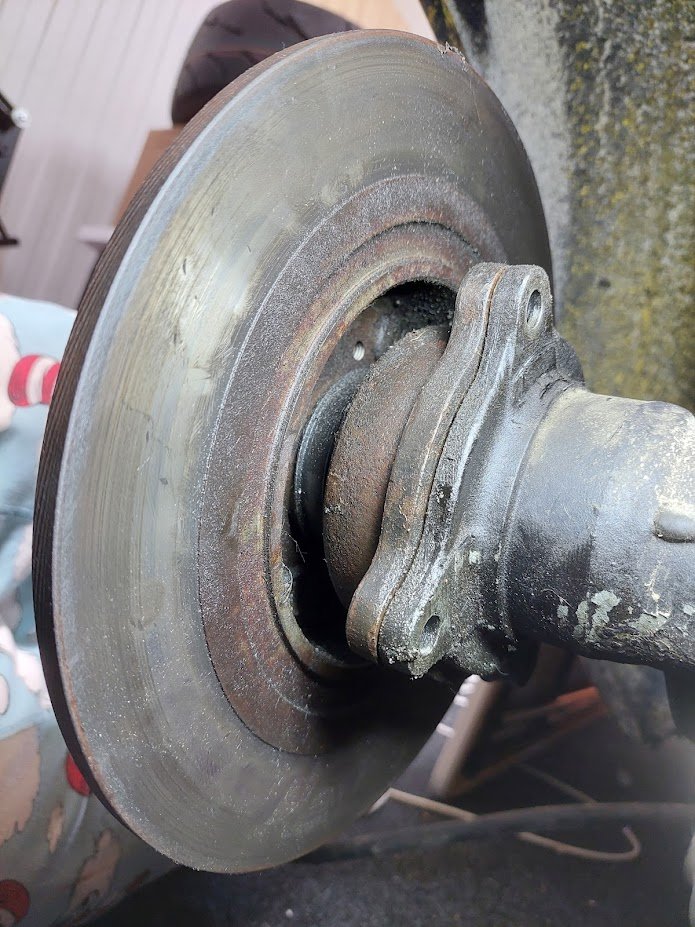

  6. I thought they were from an RN40, but I don't remember. The diff came from the deep south about 15 years ago, paid squat for it! Do you know the length of the early KUN axles? Not sure on the brakes. I've not seen AE92 ones. Here's what I have:

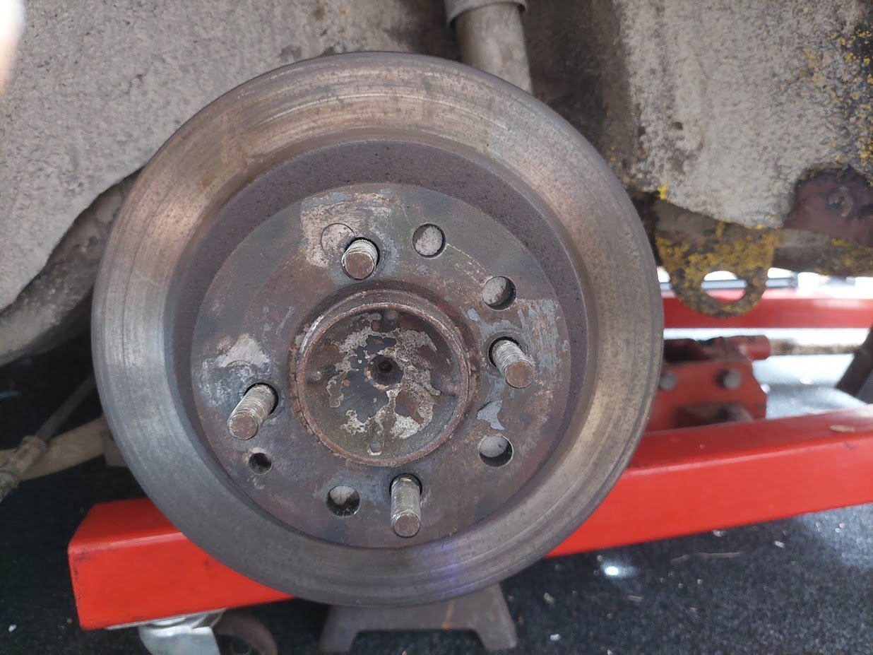

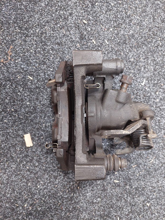

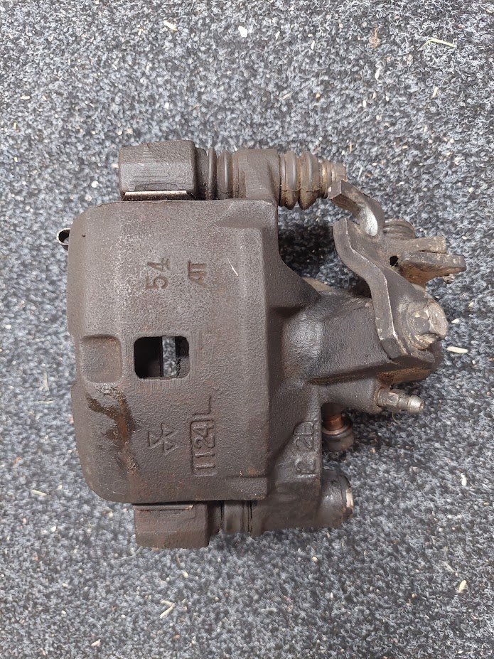

  7. Here's some pics, my brake hub register is different to both of the ones your posted. You can also see where they were welded and redrilled - originally they were 5 stud. The housing is the welded type. It's difficult - I don't think the wreckers are going to just let me pull out a bunch of axles! Might just look for KUN ones. Yep @cletus, I've factored that in. Rear calipers all seem to have massive handbrake mechanisms, or have really small pads. I think I can make the AE101 work by shifting it and mounting the coilover above it so it the turret give it the necessary clearance. Any suggestions on low pro calipers that still have a decent pad size?
  8. I need to run 4x100. Currently I have AE101 discs and calipers on the axles/housing which I have been running for years (rotor behind WMS). Not only am I wanting to shorten the axles/housing, but I'm also changing to coilover from coil/spring, and to 4 link from a 3 link ladder bar setup. Considering all this together is why I considered starting from scratch! I'd like to keep the brake setup though, it works well.

  15. Wow! Thanks @johnny.race So it's not quite as easy as I had been told. My current diff is one of the 1410mm wide ones. I'm essentially looking for axles that are the splines plus the tapered area longer, so I can cut it all off and respline at my required length. Do you think there is enough material in the mounting face centre to machine a 6 stud down to 68.3mm from the stock 101.6mm? As I mentioned above, my rotors are currently mounted behind the flange face. I need to pull them off and see how this was achieved as I didn't do it personally. Could be some machine trickery behind there. Is there any reason not to just grab an entire 6 stud hiace housing and axles then, if they are more butty? Will my existing hilux diff head work with this?
