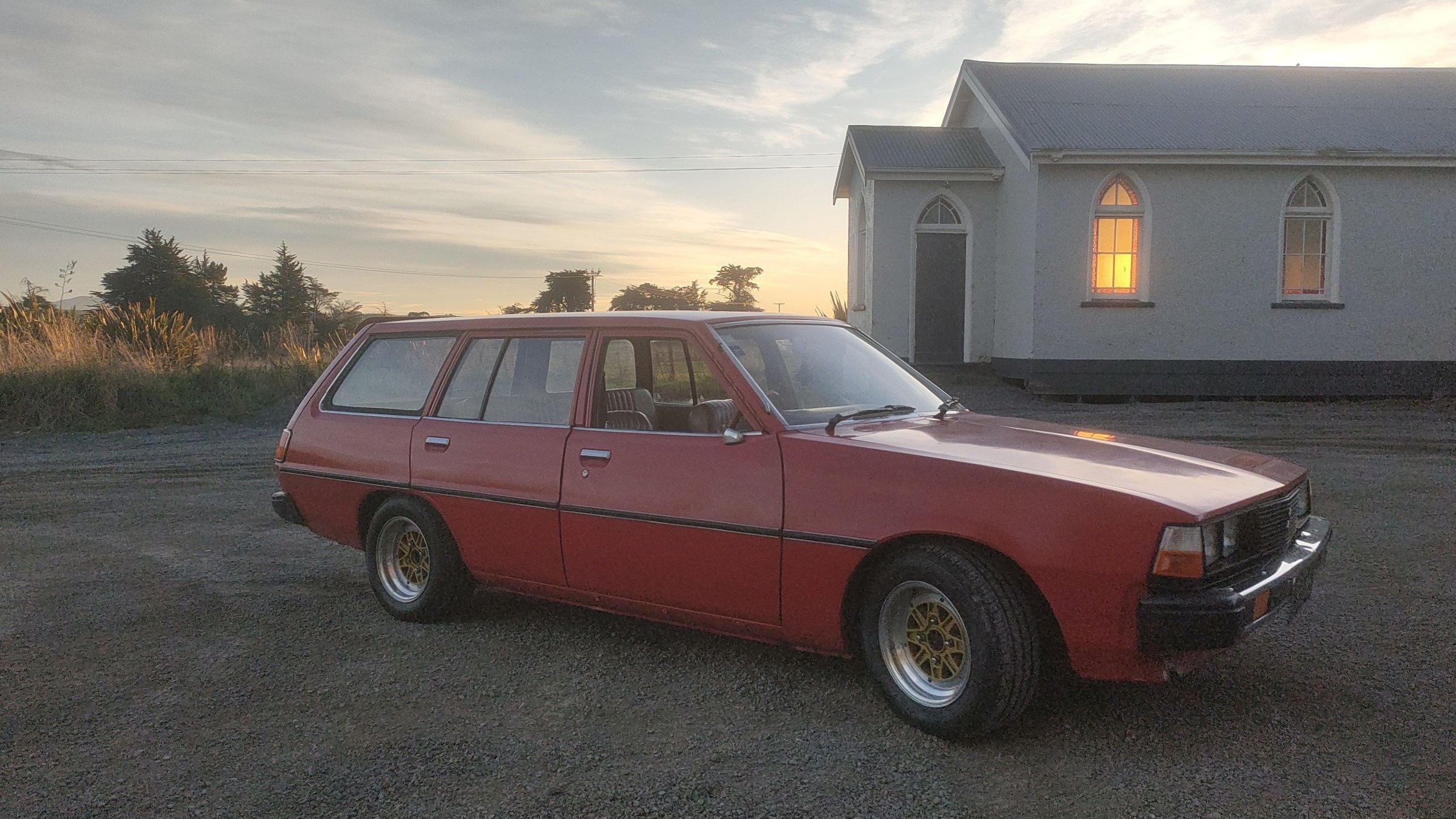

Hey oldschoolers, a very brief history on my car and then hopefully some meaningful progress
This is my Mitsubishi Express (NZ assembled Sigma??) that I've owned for about a year. There's a short thread on here by the previous owner detailing him getting it as a rolling body and putting a SOHC 4G63 out of an L200 in it and basically just getting it warrant worthy. I got it off him minus wheels and on the 90 minute drive home immediately after picking it up, one of the bolts holding this plate that contains the gear stick came loose and a piece evidently broke off:
Car wouldn't go into any gear and I had to get a mate to tow me the last 20km home at about 11 o'clock at night. Beers were definitely owed for that favour! I couldn't find a replacement plate so I welded the chip back in and fettled the edges and that's worked since.
About 2 months later I was driving home yet again and heard a horrendous screeching from the motor, pulled over to discover oil everywhere. Tracing the source to an oil seal I found I'd run a balance shaft bearing:
A couple of months of new car being broken twice depression and one Evo balance shaft delete kit later and I was back on the road.
Haven't done much actual work to the car since other than doing a UJ and wheel bearing needed for a warrant. I've just been driving it, getting groceries in it, towing my race bike around the South Island etc etc
But I don't feel like I can make a project post without some work!
Which brings me to the current day. The old girl flew through a warrant about a week ago but with the stipulation that the rust that is on the valance is growing and needs dealing with. Which I had on my list of things to do but was loathe to start due to my near zero knowledge of panel work:
