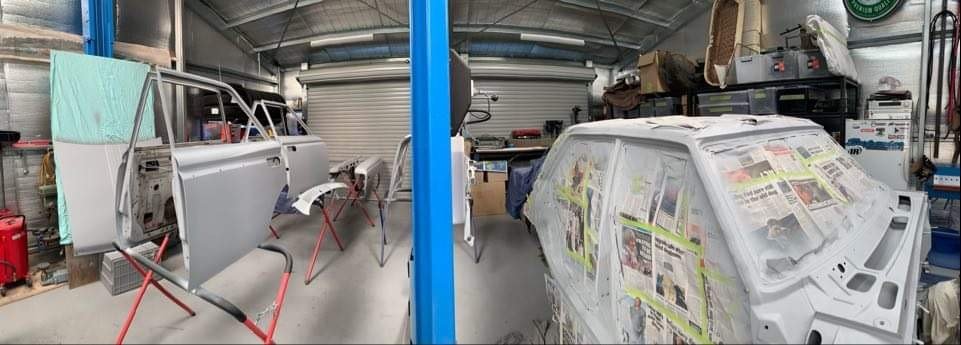

Somewhere in between painting the firewall / door jambs of the vehicle I decided that I needed to build myself a vapor blaster. A cheap secondhand sand blast booth was secured and quickly converted(quickly translates to 'I spent heaps of fucking time but lost track of it because I was hyperfocused') into a vapor (wet) blaster. First patient through the blaster was a fuel filter bowl from another vehicle. Shit yeah. Found a carby that came off a parts car (like, an actual parts car - one that I didn't try to restore) which was pretty knarly. Blasted that too. Knowing it worked pretty well, I blasted the build plate so I could chuck it back on the firewall. No 'shortly after blasting' photo available. So a photo showing it riveted onto the firewall / plenum - complete with reproduction paint code / color sticker. (before / after comparison shot because I think it's fucking cool) And then (because I jump from one thing to the next, not thinking about how the correct order should be applied) decided to wirewheel and paint the front section of the chassis. Not clean, then clean.

Welding the panels into the plenum went.. well yeah. In a brain fart moment, I decided to try and TIG the outer skin after priming the back side (and inner panel) with some weld through primer. The TIG did not like that. Not at all. Anyway, the MIG was wheeled out and the panel hot glued in. I was obviously stoked with the results - because the only image I have is this shitty photo taken just before throwing primer at it. The old boy was at a loose end, so helped rip back the remaining paint on the firewall and door jambs. At the same time the doors, bonnet and boot were all sanded back and primed. Happy enough with it all being one colour. Spent more time sanding, touching up primer and so on until I was happy to throw some colour at it. Pretty fucking happy with that considering it's the first time I've painted with something other than a rattle can! Mmmmmmmm..... Shiny....ish.

Front end stripped, engine removed. Stamps and shit on the back of the cylinder head suggest that the engine was rebuilt at some stage. The way it runs would confirm that it wasn't done too long ago. Moved the old girl off to the other side of the shed and started working on the firewall. Just about every 50 series Crown I have seen has had a rusted out plenum near where the wiper motor bolts up. This one was no different. Looking closely at the panel, there was a thicker 'reinforcement' inner panel spot welded in behind the outer skin. Strip disc on the grinder to find the spot welds which I then drilled out. Inner panel was remanufactured from less rusty steel. And the same again with the outer skin. Inner panel in situ. Outer skin fitted.
