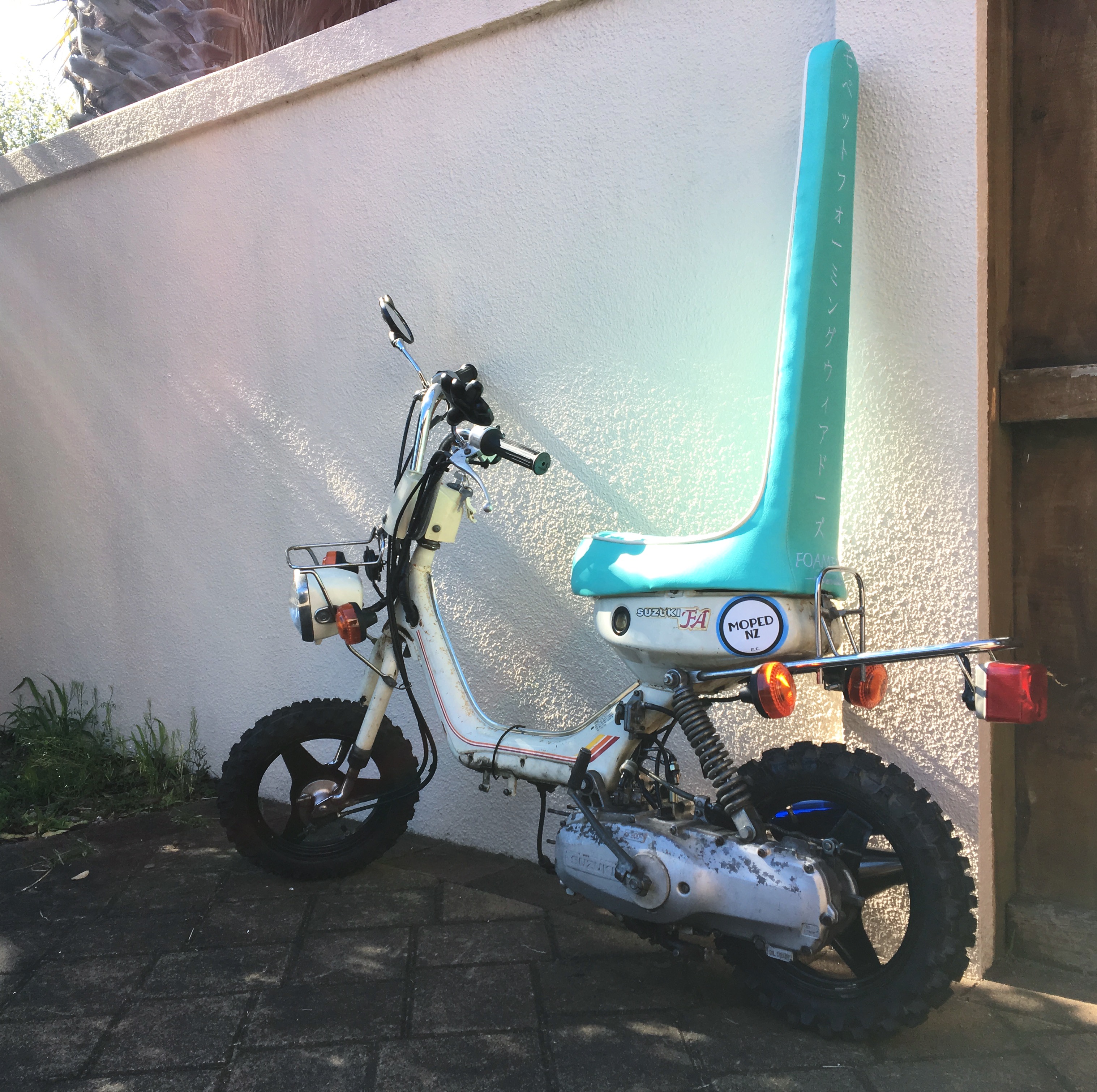

Yeah it's weird, the 3.50 x 10 has now pretty much beaded to the rear rim, I presume all the over inflation, etc has helped. The front 3.00 x 10 won't budge at all. So I'm still gonna use mud tyres.
I got a set of Yamaha 6V indicators and chucked them on today, along with the normal front wheel just to get it moving. Made up a new plate mount and took it for it's first road spin. Holds 55kph mint as, needs a bloody good tune but I'm hanging on till the expansion chamber is ready to use.
Here's how he looks today:-

Welp, the tyres are too big! They won't fit bead on the rims. Not even 120psi could manage it. Had 3.00 x 10 on the front and 3.50 x 10 on the rear, nice michelin S1's, but they will just wait their turn for the FS50 when it's the priority again.
SO! New plan is to get dirt bike tyres. Why? Because I've been following this build and love the look. This is from the U.K by a guy called Tony Gray. Introducing, Mud Slag:
and:
Lets see how this turns out...-
