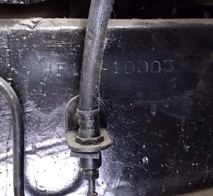

http://japanesenostalgiccar.com/kidney-anyone-the-mystery-of-the-first-toyota-2000gt/
Sounds suspiciously like a rare RHD MF12 fitted with an MF10 engine, by someone trying to make it a "proper" 2000GT, but reducing it's authenticity and value in the process?
Yeah sounds like it. TBH I didn't even notice the lack of rivets.
ill look it to it more
