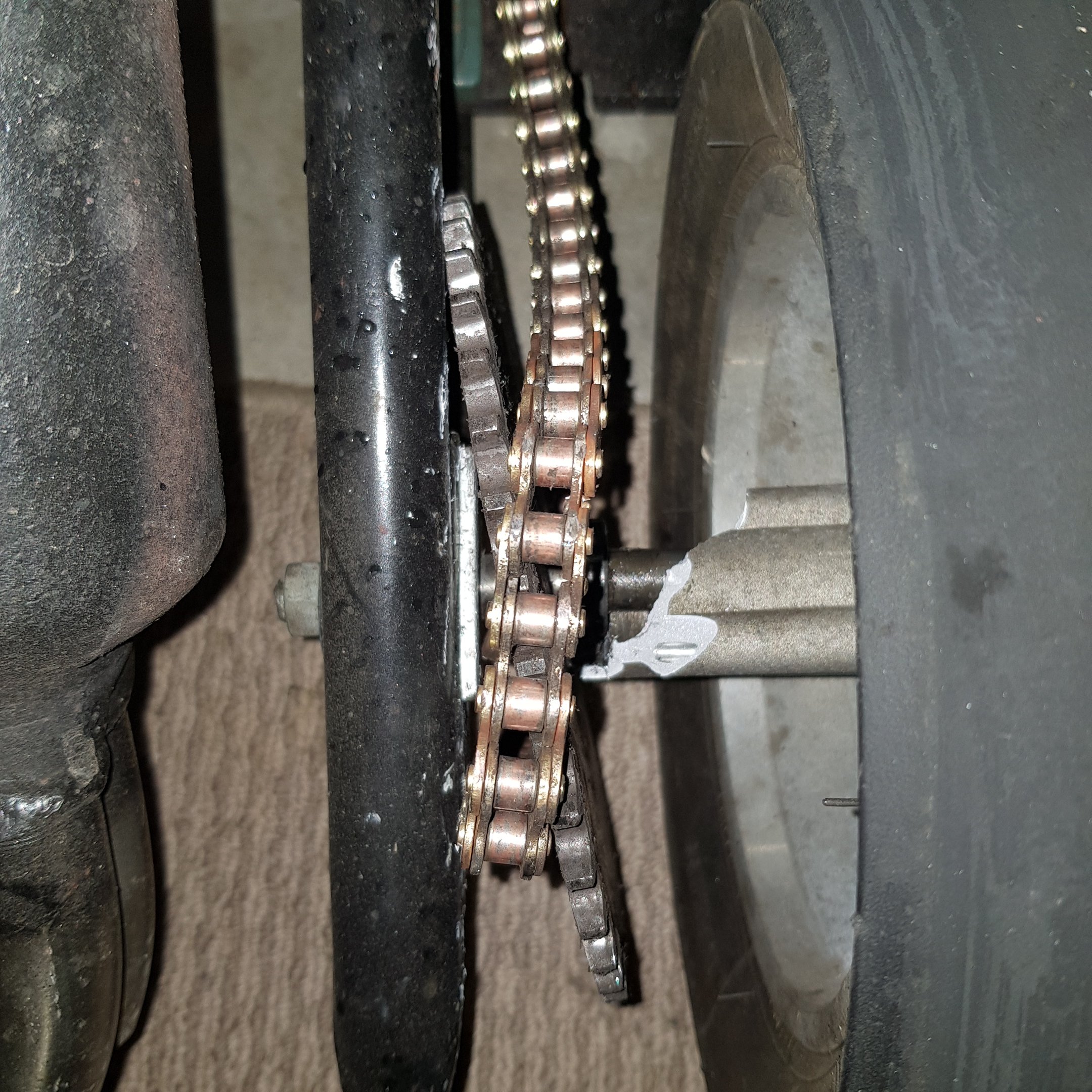

  8. Righto, managed to pick up a larger sprocket and chain for free...best day ever!
    I machined up this retainer. Then installed the chain and bigger sprocket.
    And buy installed...I mean, it went straight on! Like as in no fucking around, bolt holes all lined up, the chain was already the perfect size...truly a one in a million chance of that happening.
