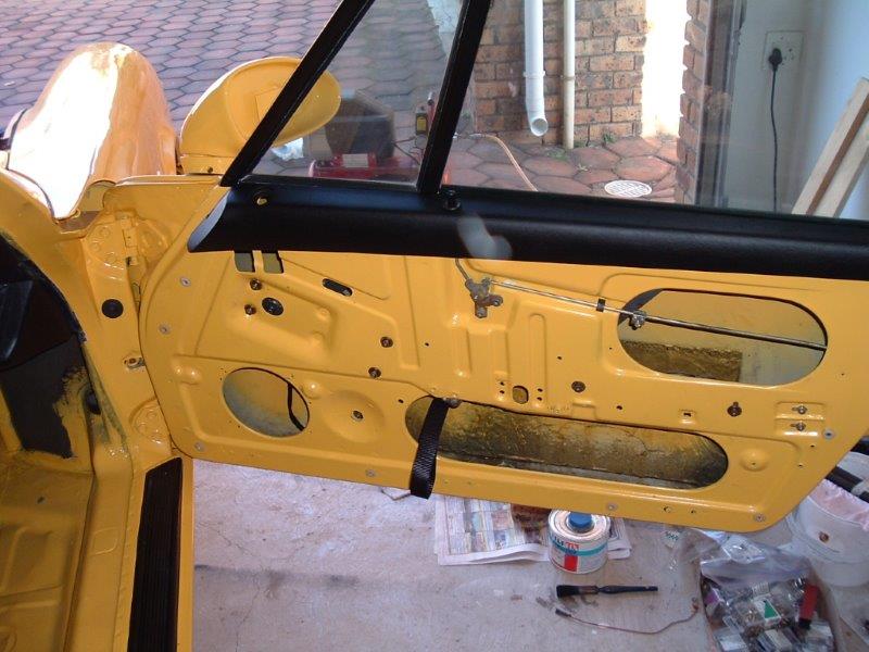

The original interior was a lovely combination of light and dark brown. The plan was to change eveything to black. We would be deleting the back seat for a lightweight black contoured carpet similar to what the original RS came out with. The heavy front door panels with storage pockets would make way for lightweight RS replic panels with original RS door pulls. We had also sourced a set of period correct Recaro sport seats with the extra side bolsters that were a factory option at the time. The dash, rear side panels and back parcel shelf cover were redyed and a lightweight fabric roof lining was installed.

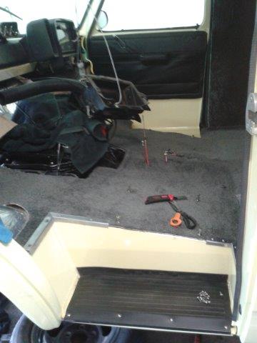

With the panel work all sorted we headed down to a local carpet shop and scored a luscious off cut from a thick pile carpet. I used the old marine carpeting from the side panels to cut a template and then dived into the good stuff. It was a bit of a bugger cutting all of the openings for the seat belts, seat mountings, gear shift etc, but with a good dose of patience it came out pretty well. I covered the storage drawer front with a bit of the same carpeting. We then removed the carpet and took it along to a professional upholsterer that stitched on a beading around the exposed edges. My little helper gave the new carpet a big thumbs up.

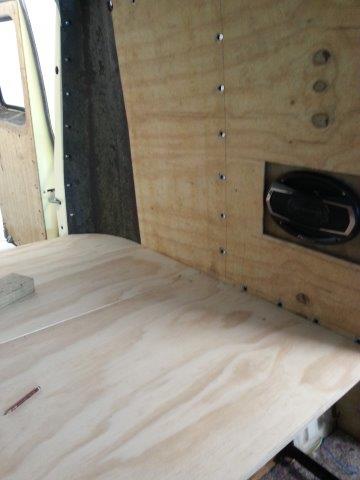

With the panels all in position the next step was to build the fixed day bed. I initially used 13mm ply, but some boisterous activity on our first overnight trip proved that the ply wasn't up to the task and this has now been replaced with 18mm ply. The images below show the day bed base, the under bed storage space that is accessed via the rear barn doors and the pull out storage drawer that is accessed from inside the van.
