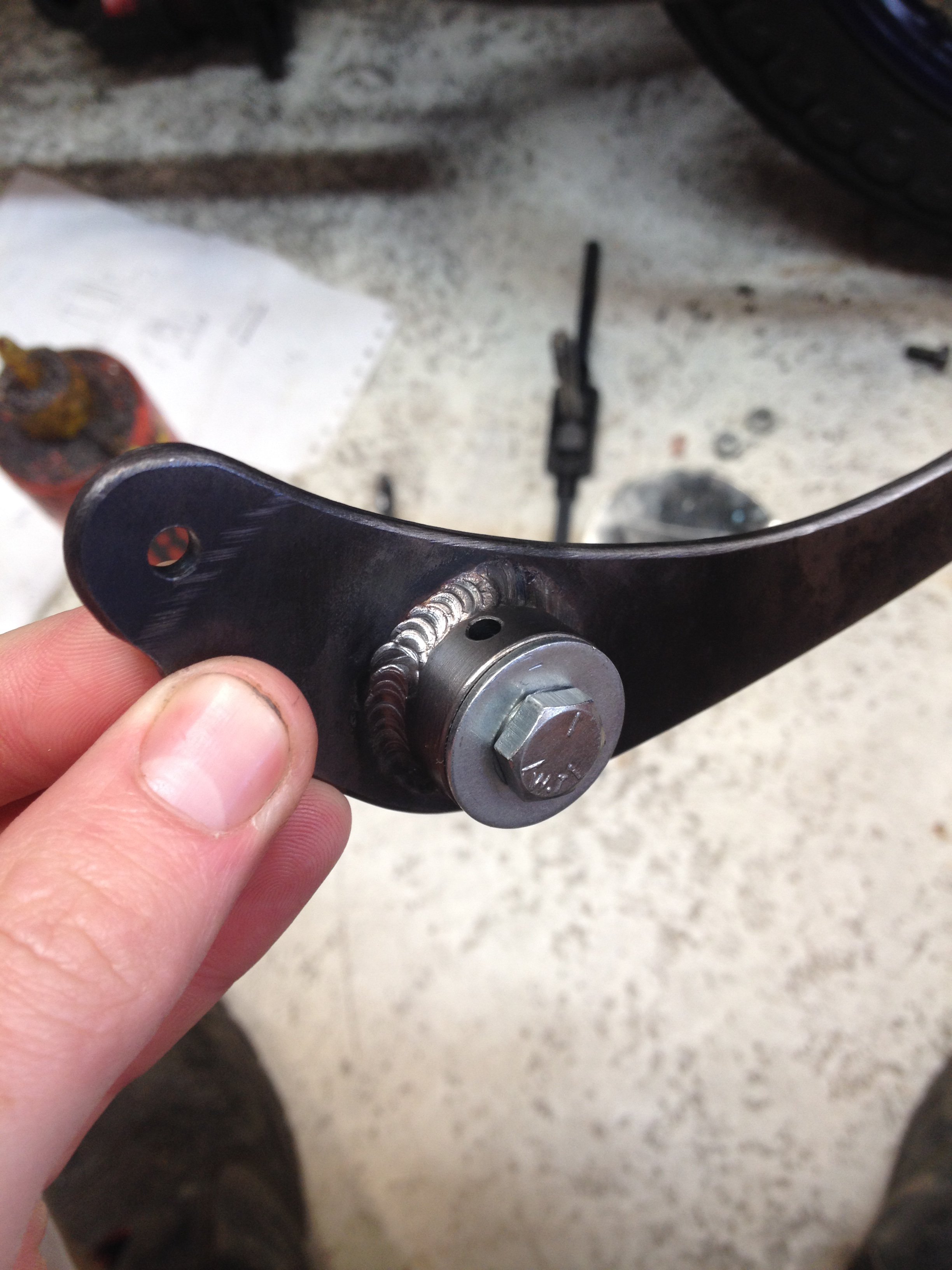

The last big thing that had to be sorted out was the front brake, my original plan a few years ago was to use this super sweet Benelli item
With my plan now to try make a period style racer it was a bit out of place, i remember finding a picture once of a bantam racer from the 50s that had a twin front drum made out of bantam hubs, i think this would look pretty cool as well as hopefully adding a bit of braking performance. A friend sent me a couple of spare hubs he had..
Bit of hacksaw action
Faced true
Clamped and tacked, I turned up a tube to go through the center of the 2 half's to ensure good alignment before welding
Should do the trick
