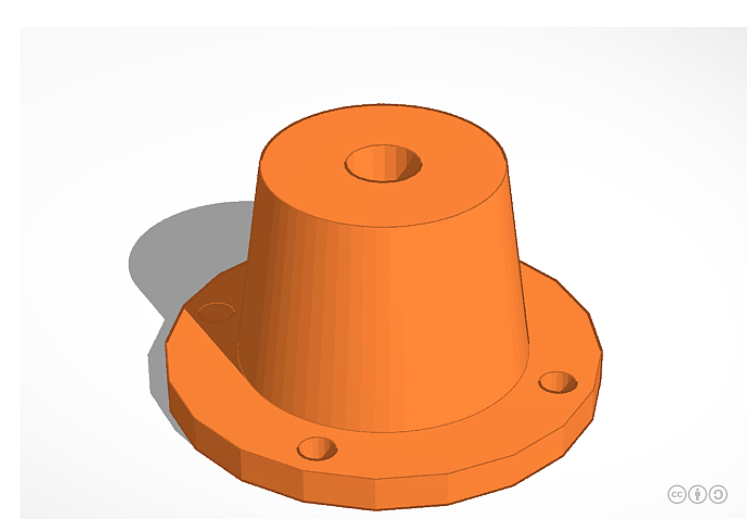

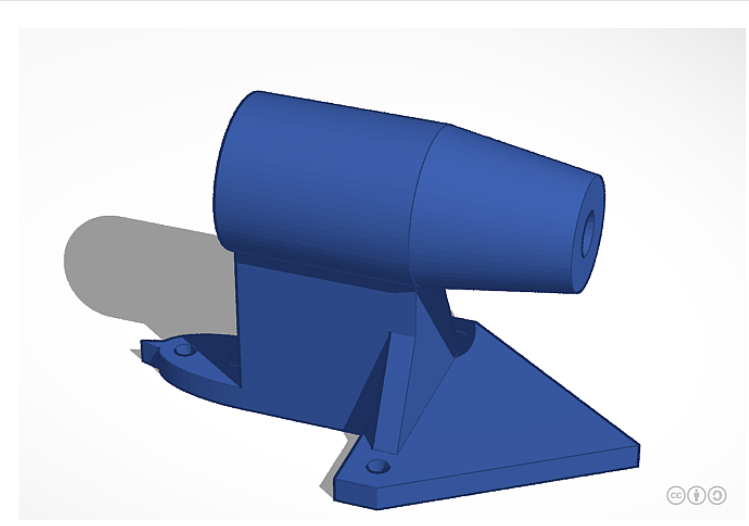

  20. Oh yeah, I forgot to mention that. The jig parts are 3d printed. Means I can sit by the fire inside while I "make" a thing in the shed hahaha. I am thinking it will probably be a single use jig, we will have to see how they come out after the frame has been in and out a few times.

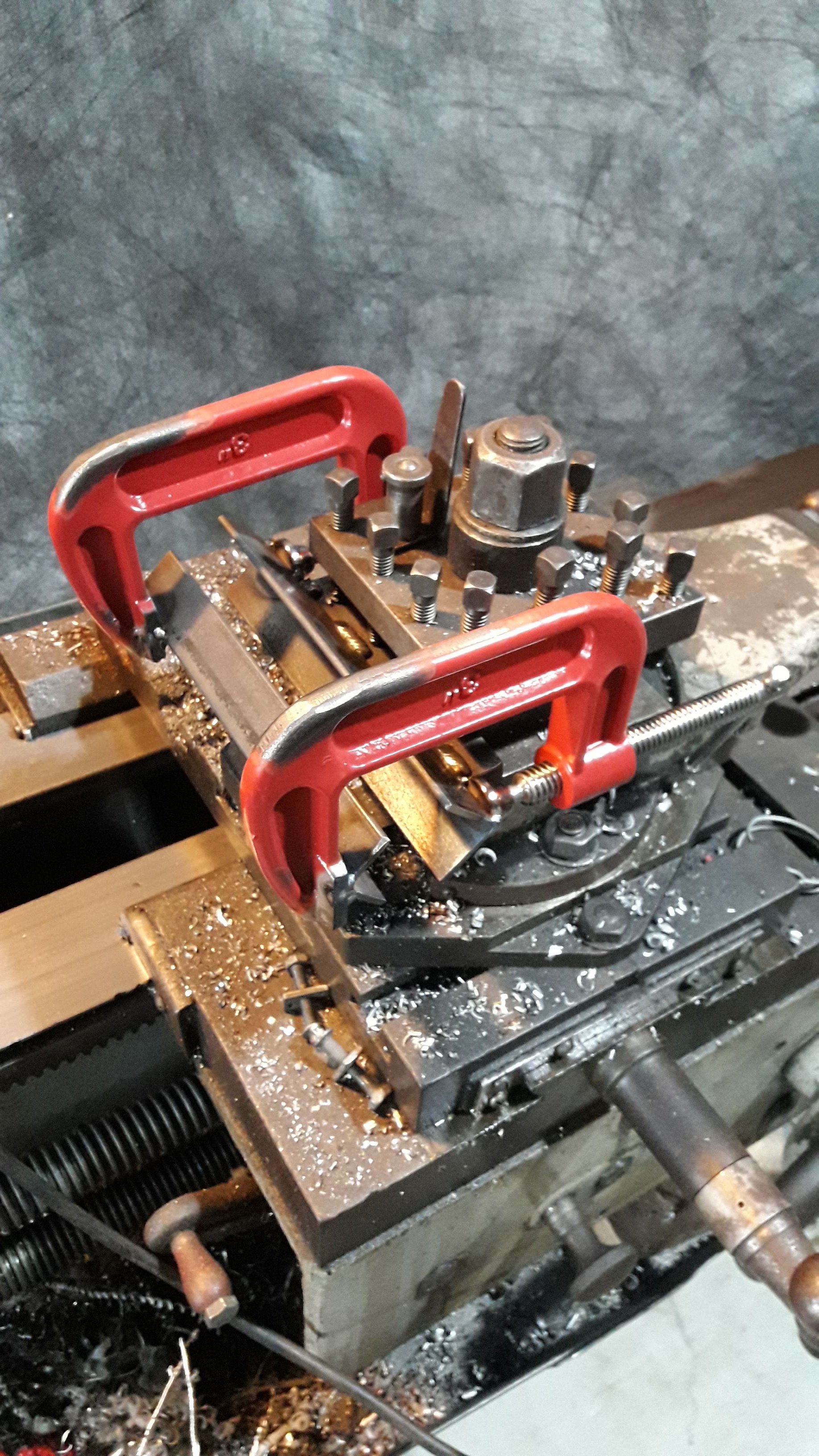

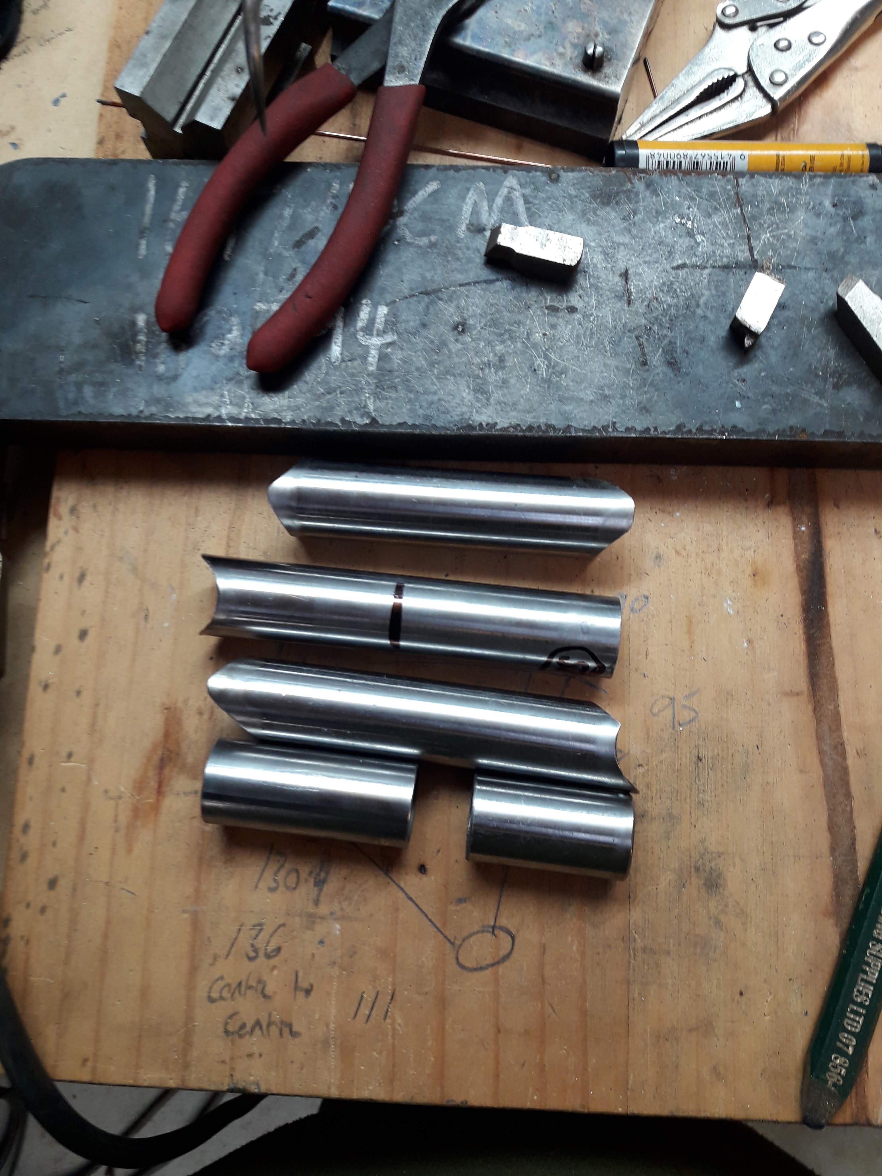

  22. Spun up the tube with some sandpaper on the lathe, it is mildly terrifying contemplating what would happen if it comes flying out and stabbed you in the hand or something. I guess not being complacent is good! popped it in the jig and found I need to make an adjustment to my end piece as the cone is slightly too small for the ID of this tube. Spent a bit of time filing the coping to try get a nice tight fit. And thats about where I am up to at the moment. I need to practice Tig welding on thinwall on tube before I can get much further so I have ordered the recommended tungstens and consumables for my torch. Might have to get a lesson or 2 from @Geophy hahaha
