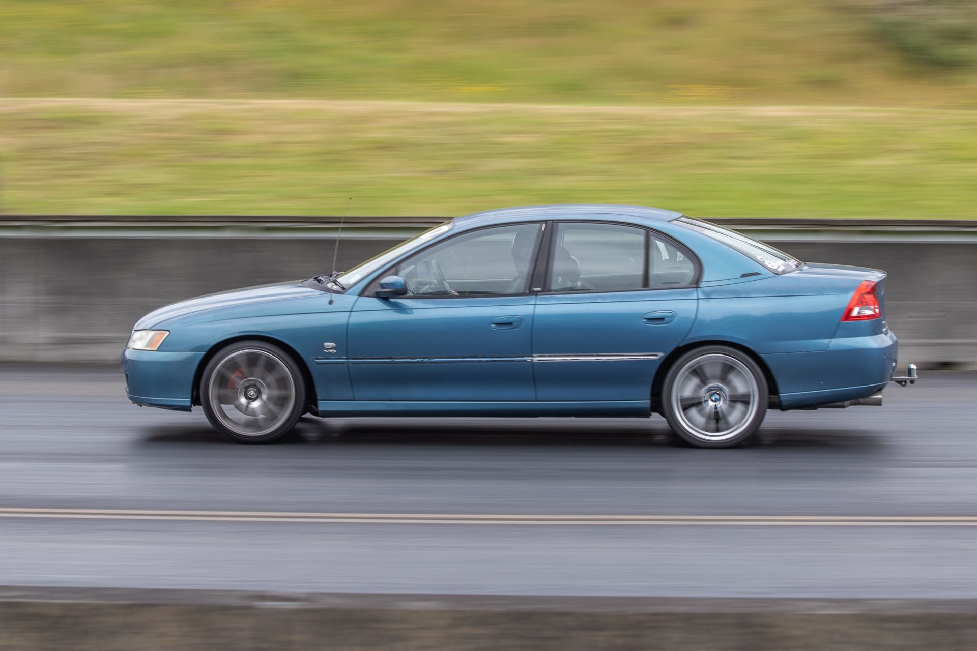

Finally got around to post Drag day check over, all in all this thing took an absolute hiding seems to come off relatively unhurt. The good things- Lifter tick went away It survived having the boost at 9psi The driveline liked the mods done in PCM, all of that worked it shifted well and trans didn't get hot- i should probably service it now. New to me adjustable rear shocks worked but I need to figure out how to set them up better. The bad things- The TPS has jammed itself at 100% so i need to investigate that, i wouldn't mind betting the solder where i extended the wiring loom has let go with the massive under bonnet temps when beating the snot out of it Wheel spin, I struggled to do much on day other than drive through it till it found grip. With the helmet on i couldn't hear the engine at all so maybe some more gauges (yuck) might help give me some cues. Massive manifold leak on drivers side, It could be crack or in need of machining flat. Rust under paint in rear guard, the paint in general is a bit shit now having lived outside for 5 years with me. It does get a little hot like 6/10's on dash if you beat on it repeatedly but it can shed the heat really quickly. Plan for new year is to sort the above things, and also move towards getting the cert done fit hoops to driveshaft etc and a smaller intercooler so I can fit a stock crash bar. New radiator is probably a good idea and also an oil cooler would be good to help keep the oil alive. I also need to plumb in water cooling on turbo. I'm going to fit a VK reverse cowl scoop to help with under bonnet temps and go nuts with more heat wrap, I'll paint that at same time as most of car will try do that during summer just get it nice again. I need to decide if I'm going lower or higher and if I want to fit my set of wide wheels and pump the guards. Or just throw money at it and get some Simmons in the sizes and offset I want to fit the with tyres I'd like. Decisions...... then there's building a new engine however I am pretty happy with power as is so I can scale that back to a less expensive build with just ARP fasteners and new pistons in my l67 block that will see it too 500hp if i want to go there.- 742 replies

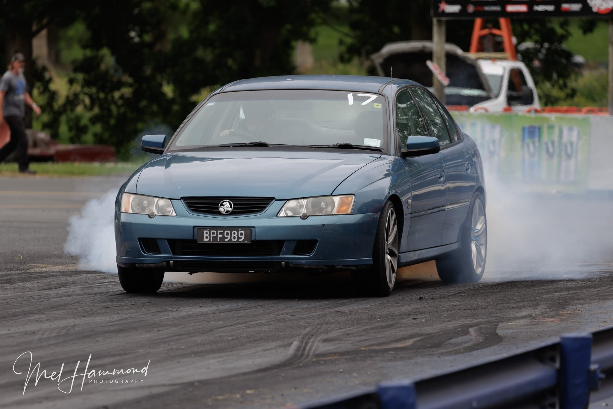

My Personal drag challenge went Well I smoked almost everything I raced today the one race I lost was to a beautiful mustang track car i forgot I was in 2nd after burnouts so hit the 6400rpm rev limiter going through traps. Now has a horrible exhaust leak but seems unscathed otherwise even after towing a heavy trailer there and back. Didn't crack a 13 second but over moon regardless, needs a high stall for transmission to get much faster as its now scrambling for traction even with slicks.- 742 replies
