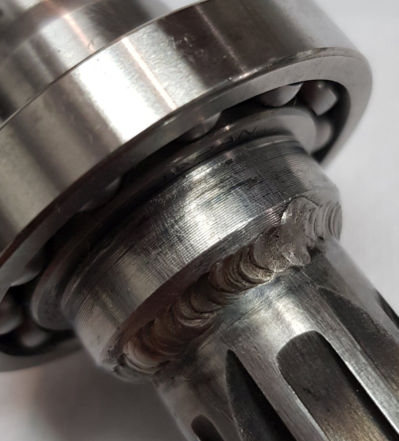

  11. Yes the hobby car manual (which I presume is superseded by ccm?) states that that internal components within a rack and pinion steering assy fitted to a LVV must not incorporate any welding but the previous discussion on this thread appears that power steering delete is allowed if done (I don't know if this involves) by a reputable shop. Regardless, if NDT shows no defect, shouldn't it be good (in theory, at least)?
  12. Hi @cletus I've read through the thread and there were a few queries regarding power steering delete ages ago. The answers then were: either - non-power steering equivalent fitted or - rack modified by a reputable place Would it be certable if NDT shows a welded pinion to be good even if it is done by other than a reputable place, i.e. a competent welder? If so, what NDT would be required - FPI crack check? X-ray for porosity? I ask this because I had a pinion welded up a while ago (which was well before I read up on this thread) based on what is supposedly a common mod amongst MX5 crowds overseas. Here are a couple of photos for reference. Thanks in advance.
