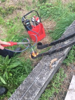

Managed to get a bit more done over the past week in between work and other projects. On Saturday removed the old rubber spring bushes from the good leaf springs, replacing them with nolathane bushes since the whole front end has already been done in nolathane. The rear bushes basically fell out but the fronts were in there so well they required fire so there's now a nice burnt rubber patch on the grass at the workshop! Last night I got stuck back into removing the saggy old springs to install the good ones back in, replace the shackle bushes in the rear with nolathanes and swapping out the old tired rear shocks in favour of some Monroe replacements. Finished the passengers side and decided to leave the drivers for another night, All going well I should receive my lowering blocks today and can finish and road test when I get home!
