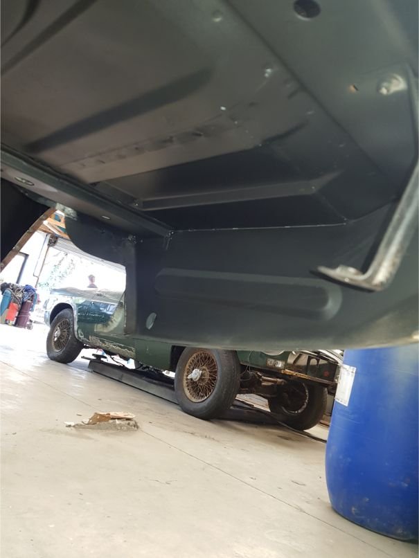

  2. Blasted and painted anything I could. Pretty tedious work bit real happy with the result. Think from memory I replaced the bottoms of those inner guard things because they were all rust fucked too

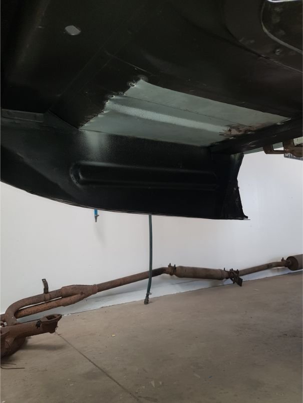

  4. all out of order bit found more photos of rust repairs to boot floor , inner and outer rear guards, just everywhere really

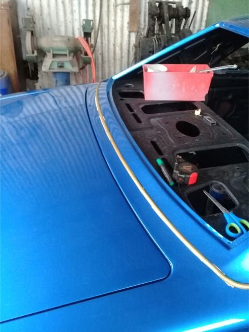

  11. And back to those brass strip things i made for the roof, so stoked with how they came out

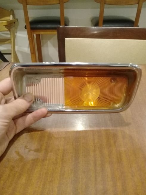

  13. Front indicator lenses were rubbish, got talking to gc in aussie who was kind enough to sell me a mint spare set he had

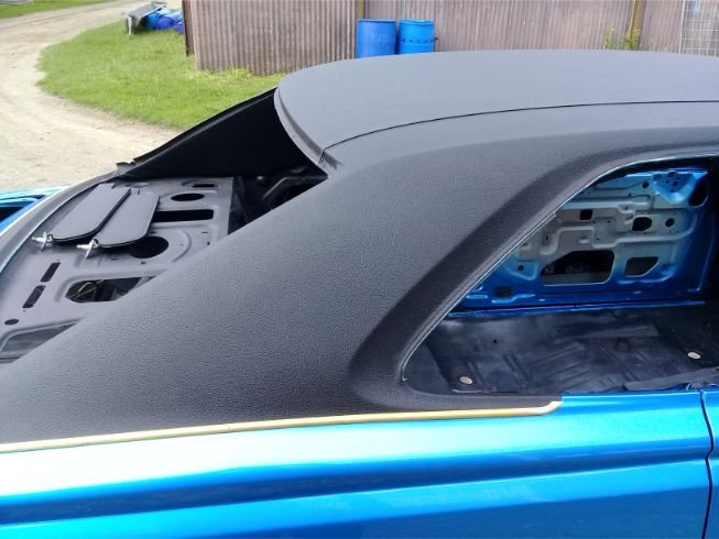

  17. And because Im impatant I had to make the vinyl roof trim on the car after it was painted which is definately a dumb thing to do. Managed without any scratches which really surprised me Used brass this time , heeps easier to work with and came out real well

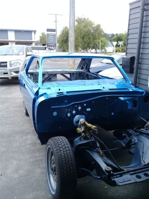

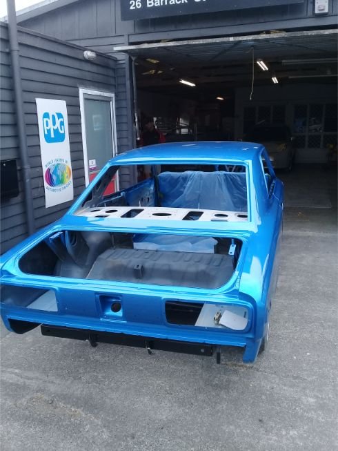

  22. Car went off the panel beaters and I was blown away at how quick things happened. Usually would take me a year or more to sort all this mess out bit not three weeks later I get a call asking what colour I want it

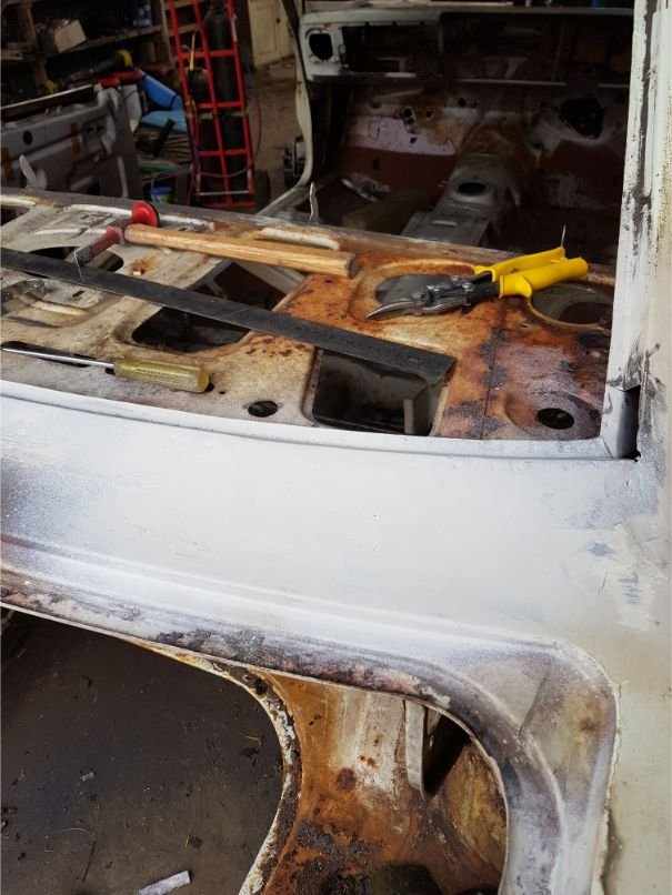

  24. Surprised myself and had a few weeks left so started into the rust repairs Came up pretty well, no filler needed

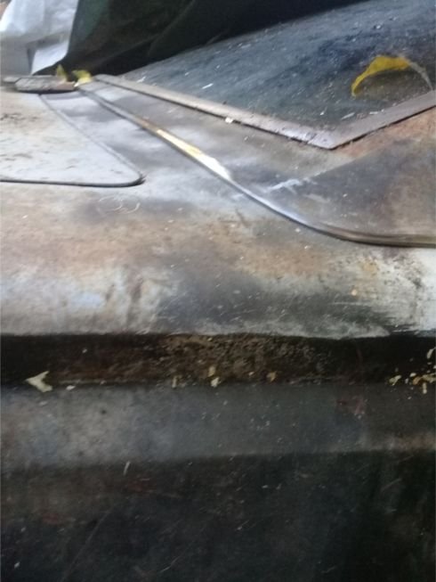

  25. So did something I never do and went and booked in a panel beater. Was due in a months time so I had a deadline which is the only way im likely to get things done. Stripped car down, plenty of rust
