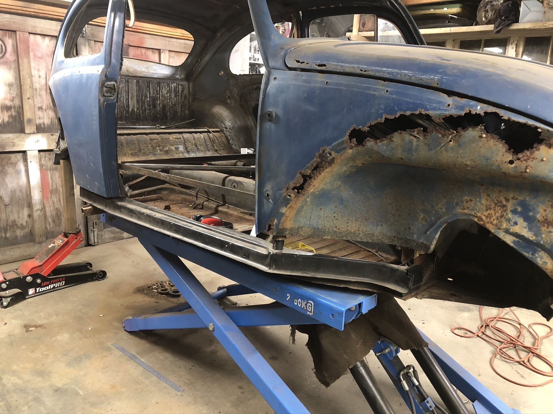

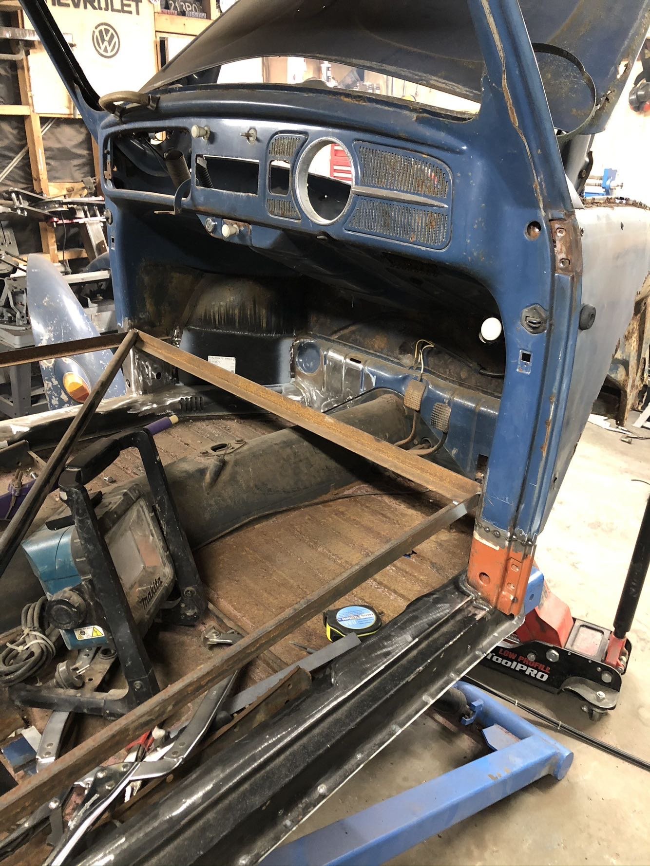

Popular Post Timk Posted January 4, 2025 Author Popular Post Posted January 4, 2025 Rigggggght here we go ! Successfully file reduced - found a user friendly app.. thank for the help there! Anyway, back to rusty Volkswagen tale’s here she is dragged back via workshop, quick waterblast to reveal the cool blue ratty paint I bought the car for… From here, carried on home, and got to work bracing the body up in prep for cutting heater channels out. 22 Quote

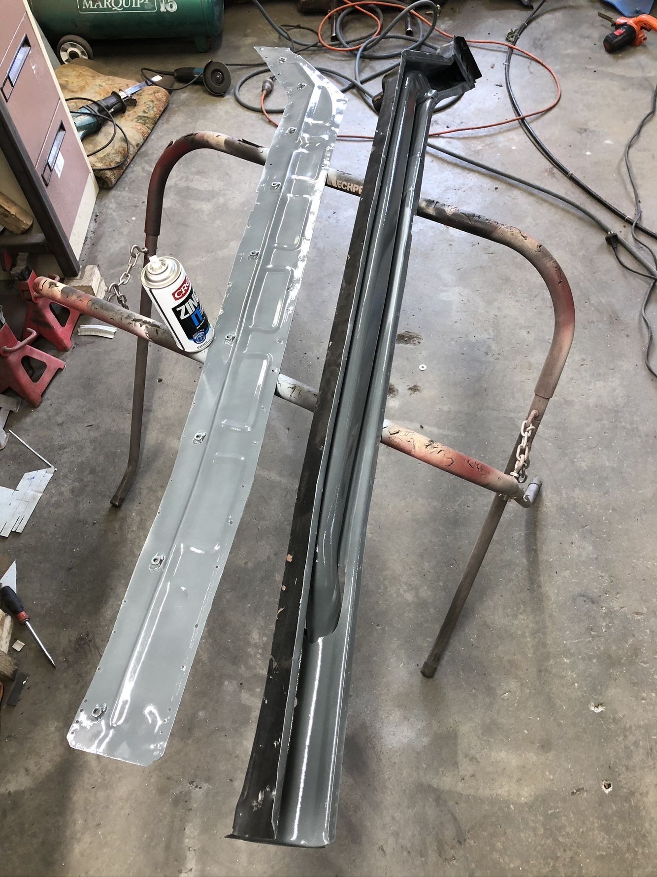

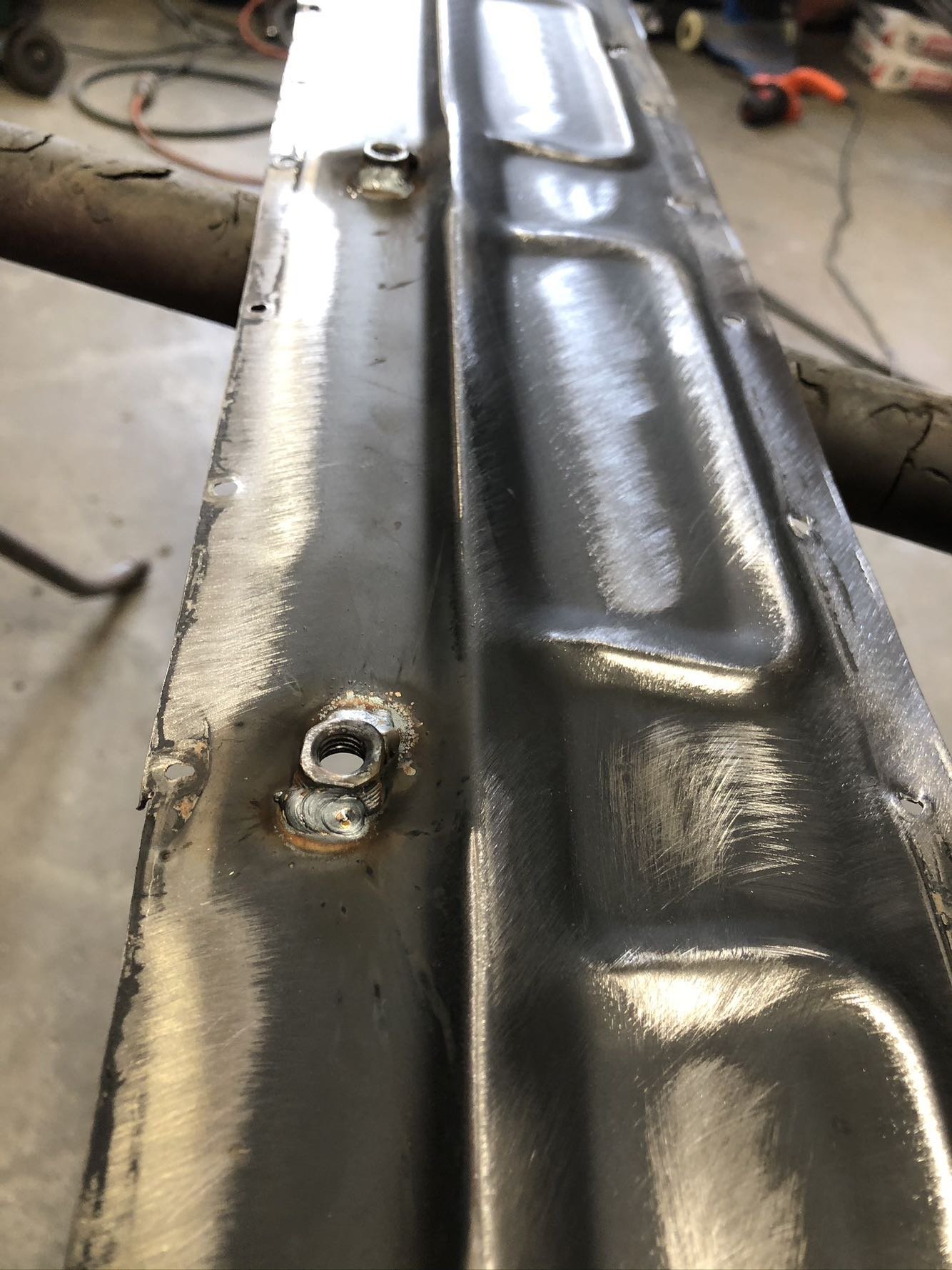

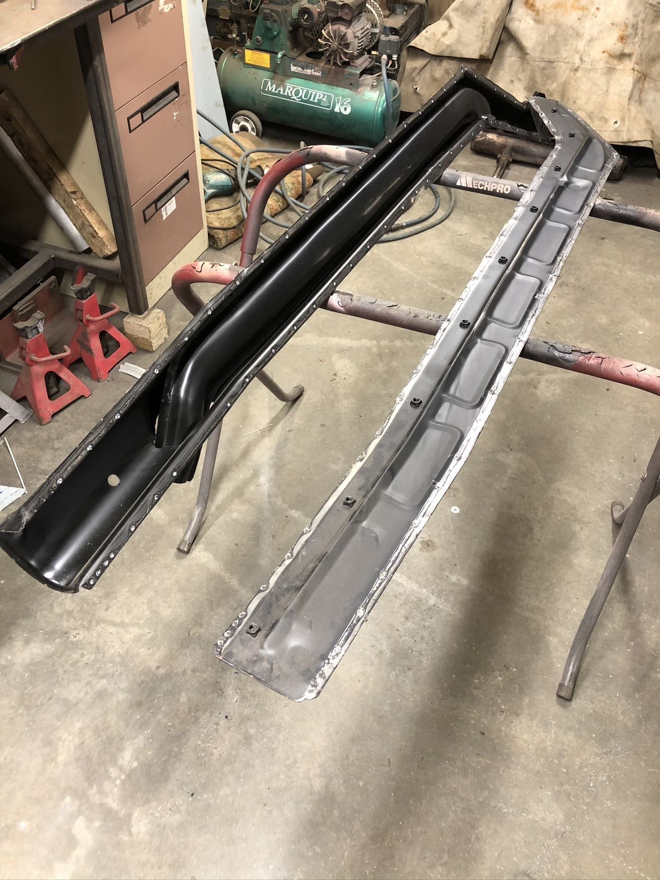

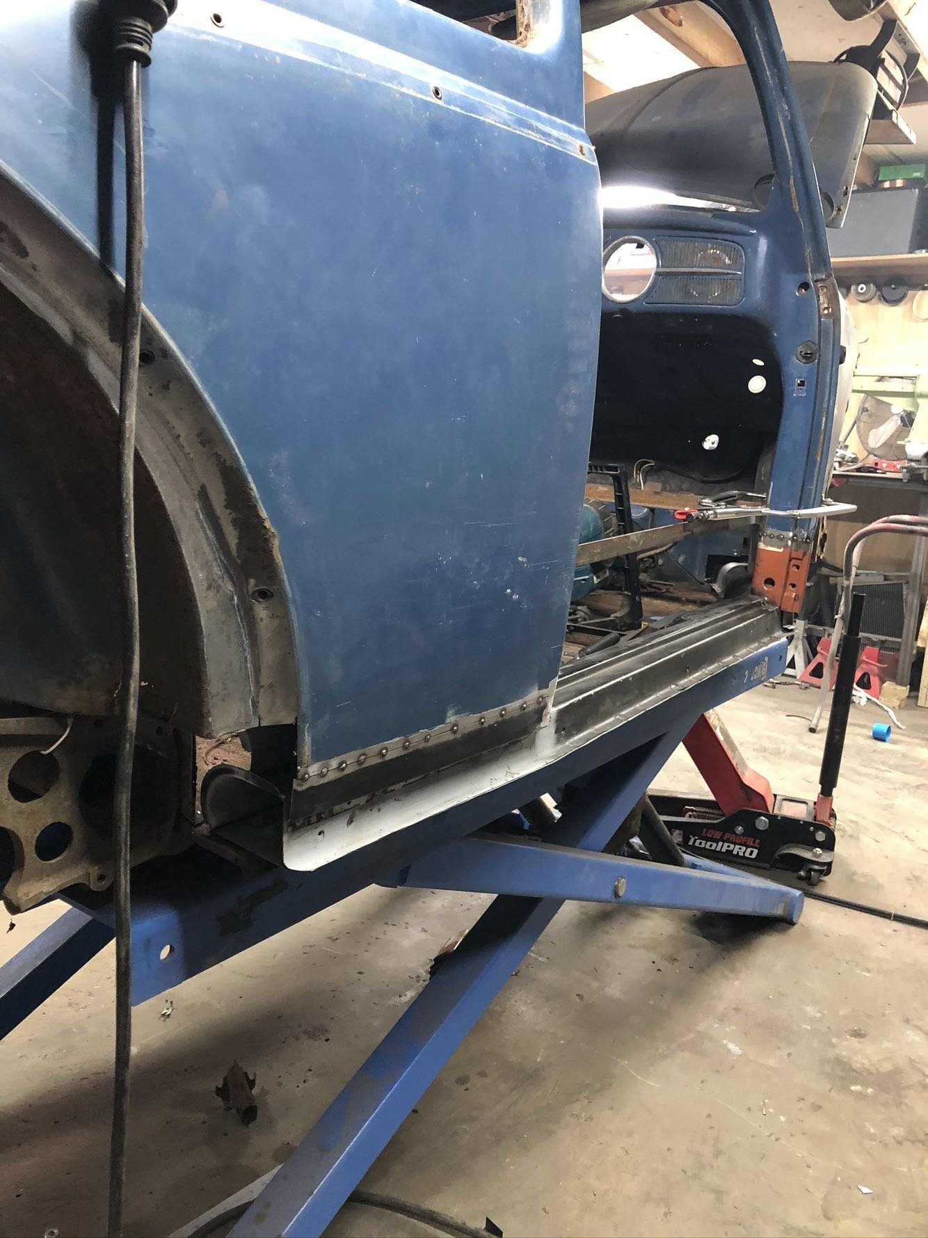

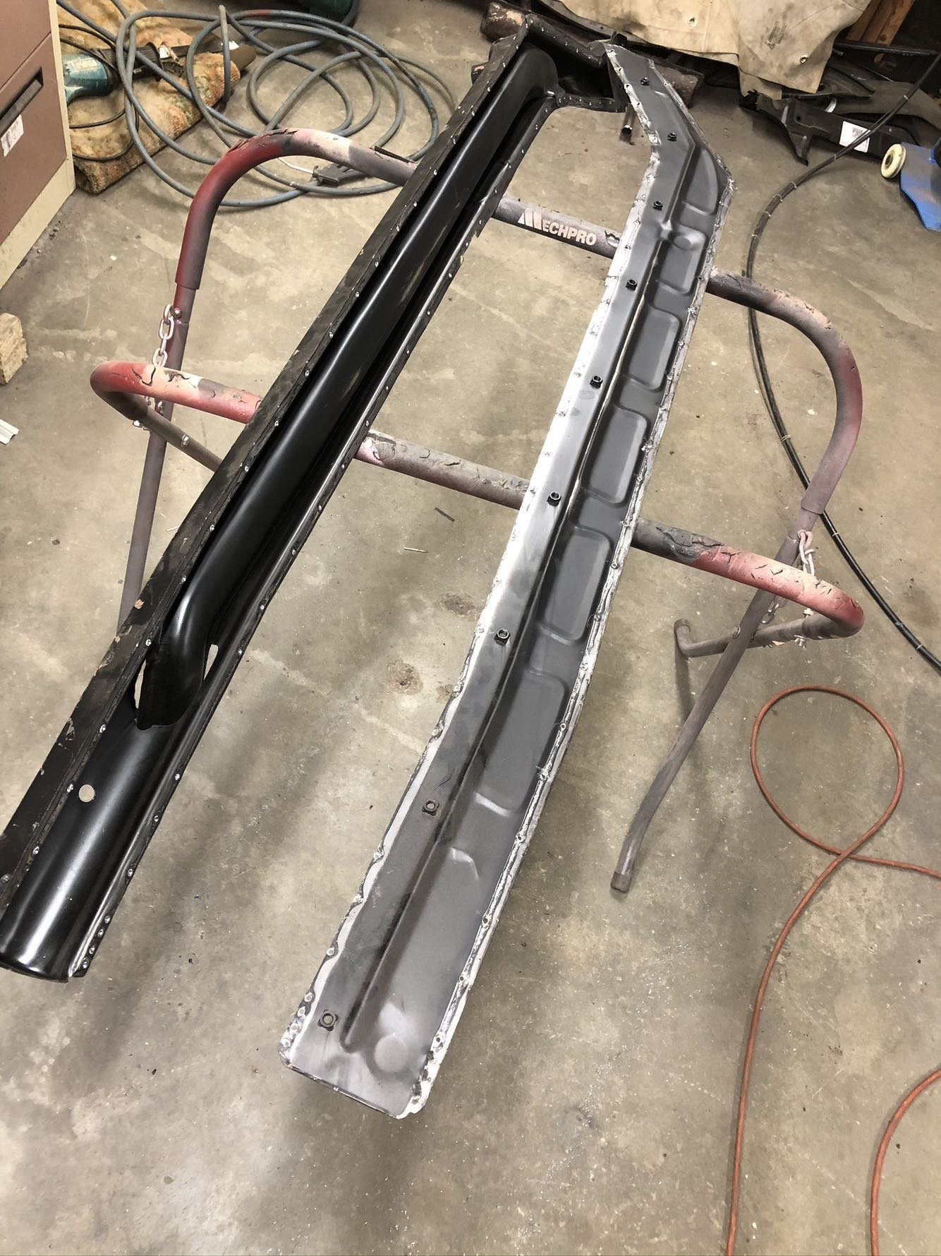

Popular Post Timk Posted January 4, 2025 Author Popular Post Posted January 4, 2025 Right so moving on from bracing the body up, and setting door gaps/ widths- Cut the sill out on Left hand side. Not before taking a heap of witness measurements/ marks/ etc. Lower firewall section (front being the firewall?) also cut out. Now onto test fitting the new repro sills, which are ok for quality, certainly not amazing, as they make them for 50-70s cars which varied in profile/ shape etc but the black panels are ok for the “non purist” restoration. Certainly would feel criminal fitting to an Oval beetle 😀 From There, drilled the spot welds out and split the heater channel (heater channel/ sill - I’ll alternate the name 😆) And then properly welded the captive nuts inside the lower plate. They are known to spin free 😬 Thats it for another days update- this was 26th March, 2020 19 Quote
Popular Post Timk Posted January 6, 2025 Author Popular Post Posted January 6, 2025 Right soooo after welding the nuts in properly, and running a m8 tap through all the holes , I properly painted inside with some epoxy primer, then welded the two halves back together and ground welds back. The replacement A pillar was next- same deal, replace the junk captive bolt plate for an OG one and replace the strap that holds it in there to move around to adjust your doors And then after some fiddling and such, ready to tack and test measure the heights and things, comparing to my red beetle (handy having a car to measure off) 15 Quote

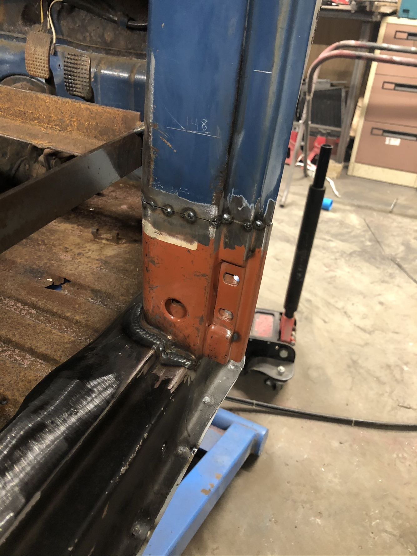

Popular Post Timk Posted January 6, 2025 Author Popular Post Posted January 6, 2025 A pillar tacked in Then the lower firewall section. ((Only have photo of this fully welded in ))After that, it was onto the inner wheel well where it meets the A pillar.. another low quality black repair panel 🙄And that’s the A pillar welded up. 32 Quote
