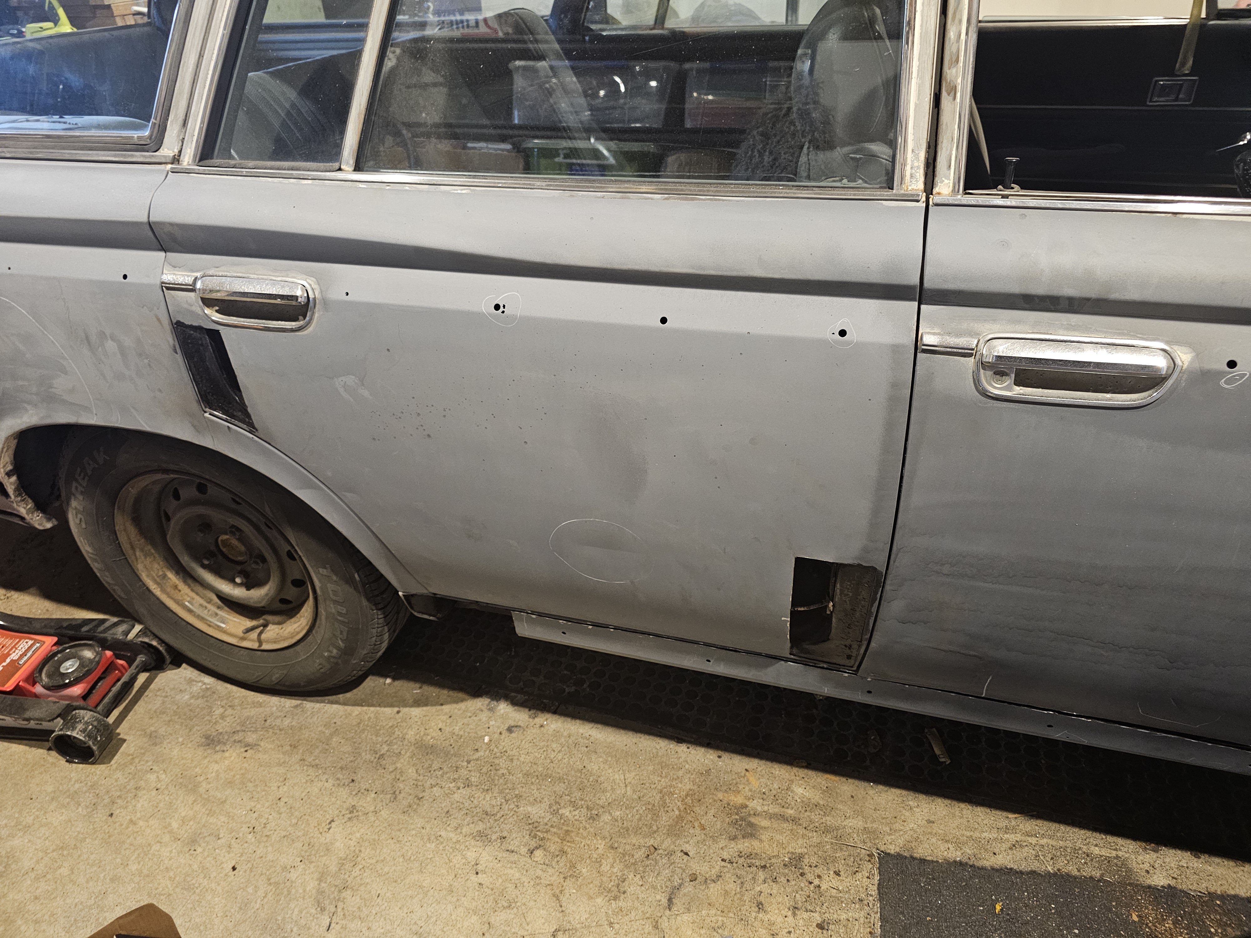

BigA Posted November 24, 2024 Author Posted November 24, 2024 Passenger side lower sill is pretty much shot for about half the length of the wagon so will have to replace those. 9 Quote

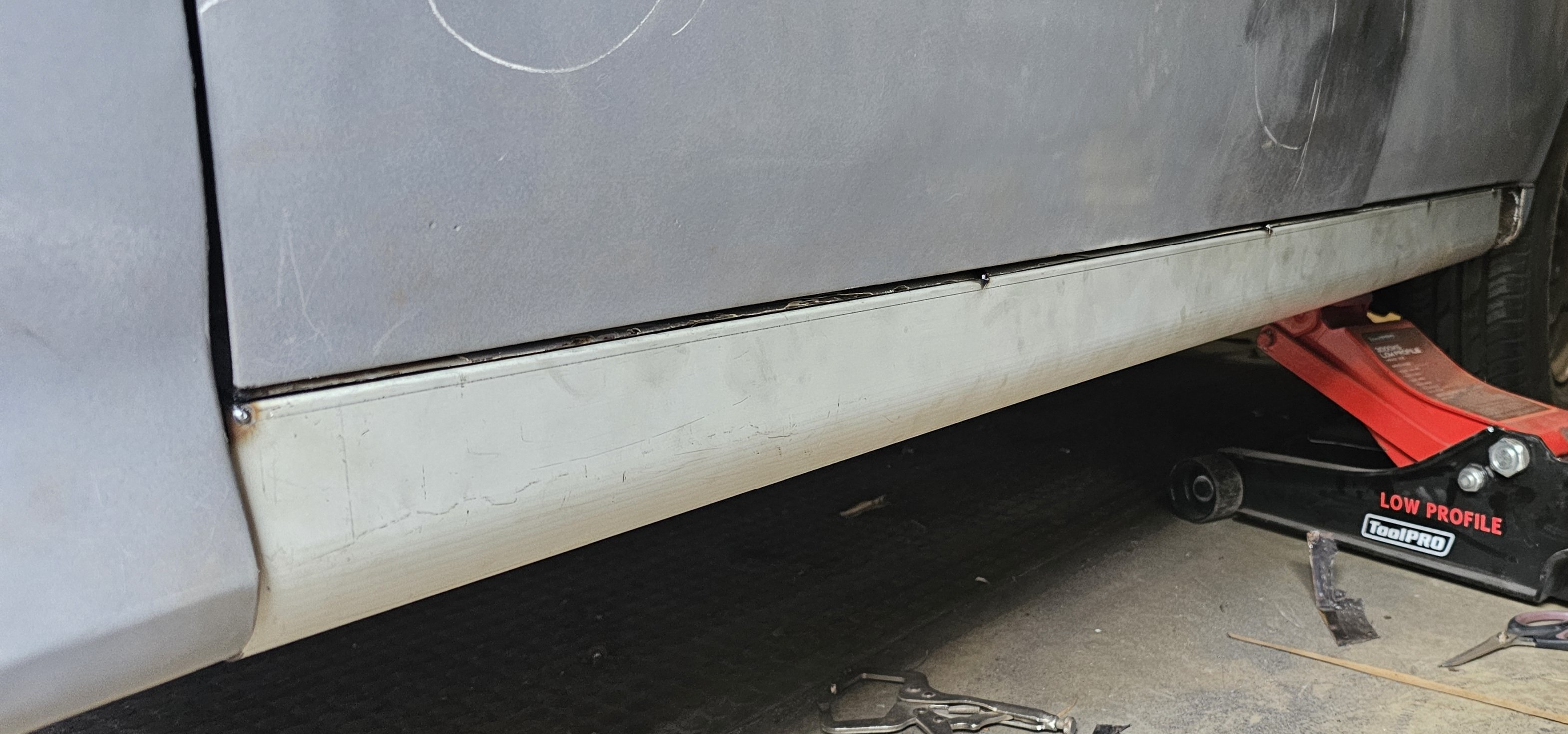

Popular Post BigA Posted December 14, 2024 Author Popular Post Posted December 14, 2024 I have made the decision to replace both lower side sills rather than just patch where the rust is as they are looking pretty sad on the inside and I don't want to have rust bubbling through in a couple of years. 11 1 Quote

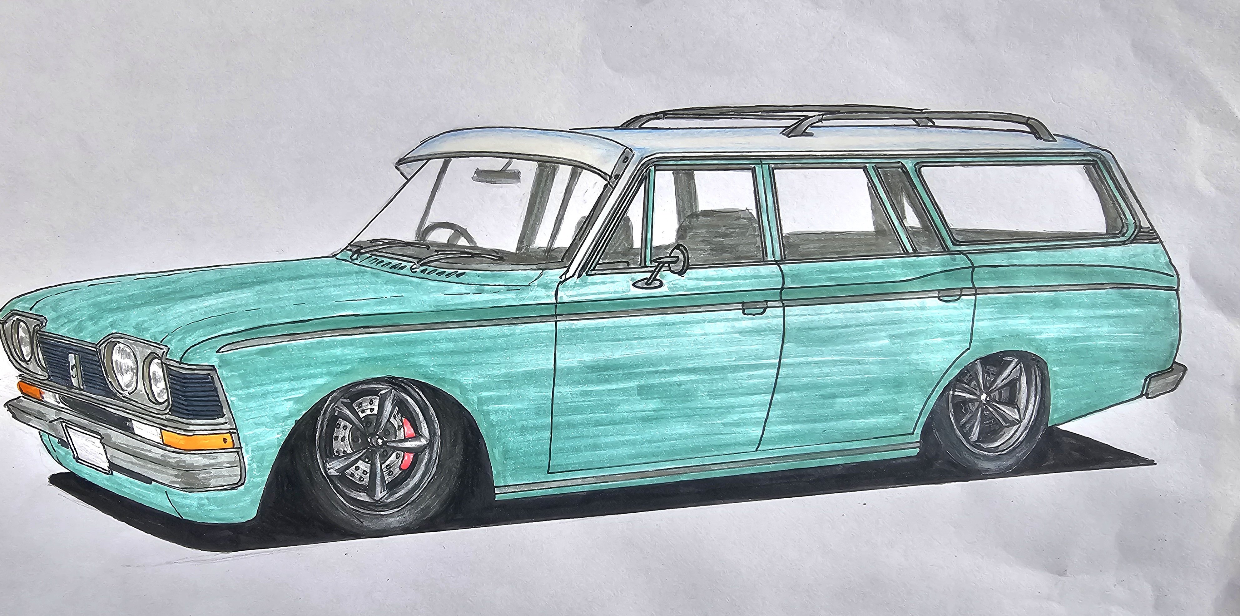

Popular Post BigA Posted December 31, 2024 Author Popular Post Posted December 31, 2024 So just finished doing my rendering of what the wagon will look like in the end. Going to do a split colour combination which will be a white with blue pearl roof and the base colour will be this nice icey blue metallic I found online. Colour is representative of what it will look like as it was hard to find an exact match. 21 Quote
Popular Post BigA Posted December 31, 2024 Author Popular Post Posted December 31, 2024 Been cutting out the awful repair job that was previously done on one of the doors. Will be moving onto the other doors over the new years break. Had been thinking about buying some doors out of Japan for all 4 doors as it might save some costs but that was if I was going to get a panel beater to fix them. $150 per door was a pretty good deal but then add shipping and tax and possibly would cost the same as repairing them. 13 Quote

Popular Post BigA Posted January 21, 2025 Author Popular Post Posted January 21, 2025 Just got my lower sills come back from the metal fabrication guys. Very pleased in the way they turned out. 19 Quote

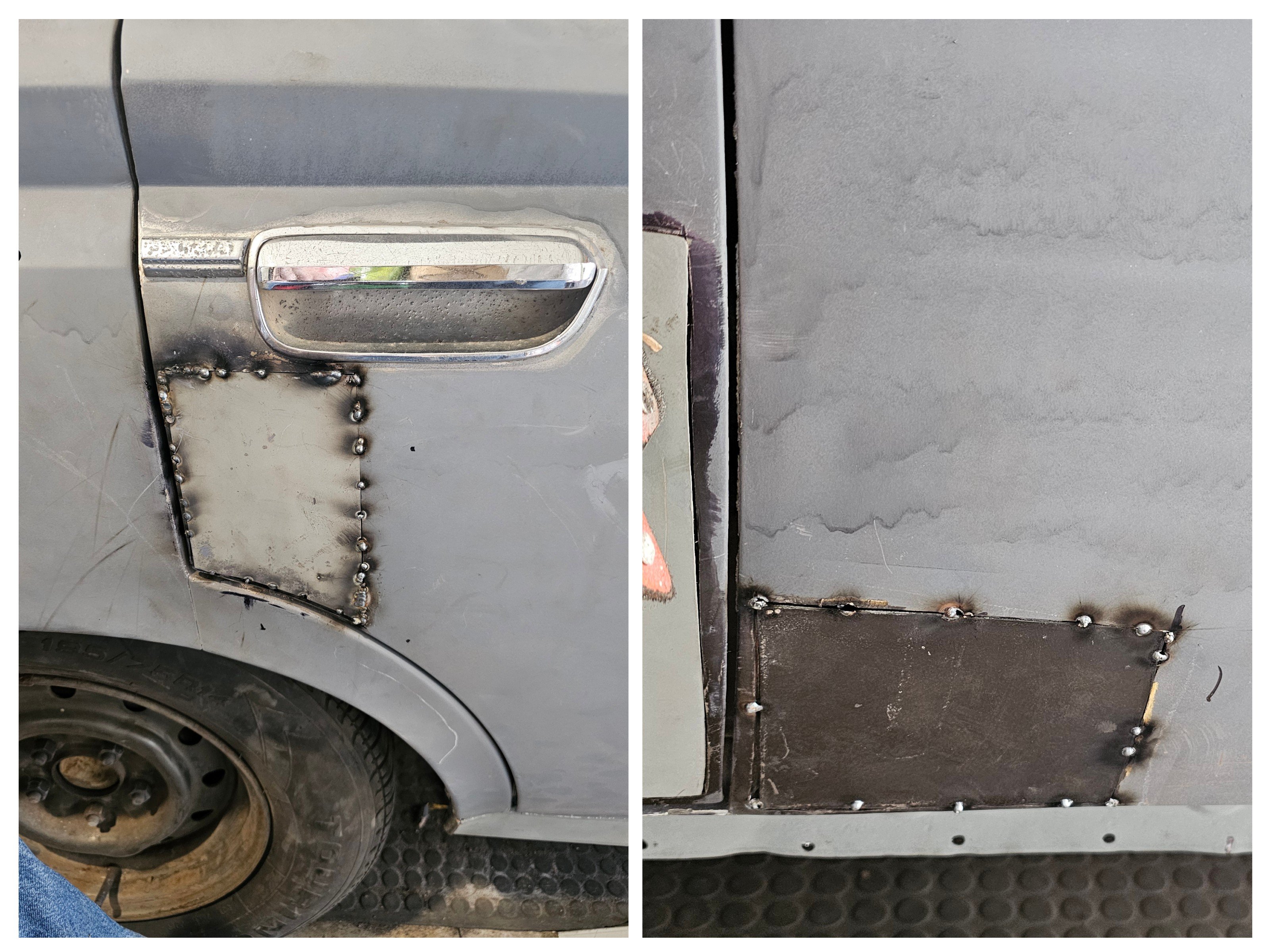

Popular Post BigA Posted January 27, 2025 Author Popular Post Posted January 27, 2025 Been busy cutting out inner structure rust issues and making up replacement patches. Was going to weld the patch in place but ran out of time. Next weekends work. Once I have that in place I will make up the small inner structure for the lower guard which I will make up in 2 pieces as I don't have all the tools to make it as 1 but hoping it will come out as planned. 14 Quote

Popular Post BigA Posted February 16, 2025 Author Popular Post Posted February 16, 2025 Tacked in one of the new lower side sills today after replacing some more inner structure on the passengers side. Some more fitment refining to do but I think it's going to look really good once done. 19 Quote
BigA Posted February 22, 2025 Author Posted February 22, 2025 More patch work done today in the doors. Had to redo the rear door as I did a silly thing by putting to much heat into the panel and warped it. Just tacked in place for now and will gradually weld it this time to get even distribution of heat. 7 Quote

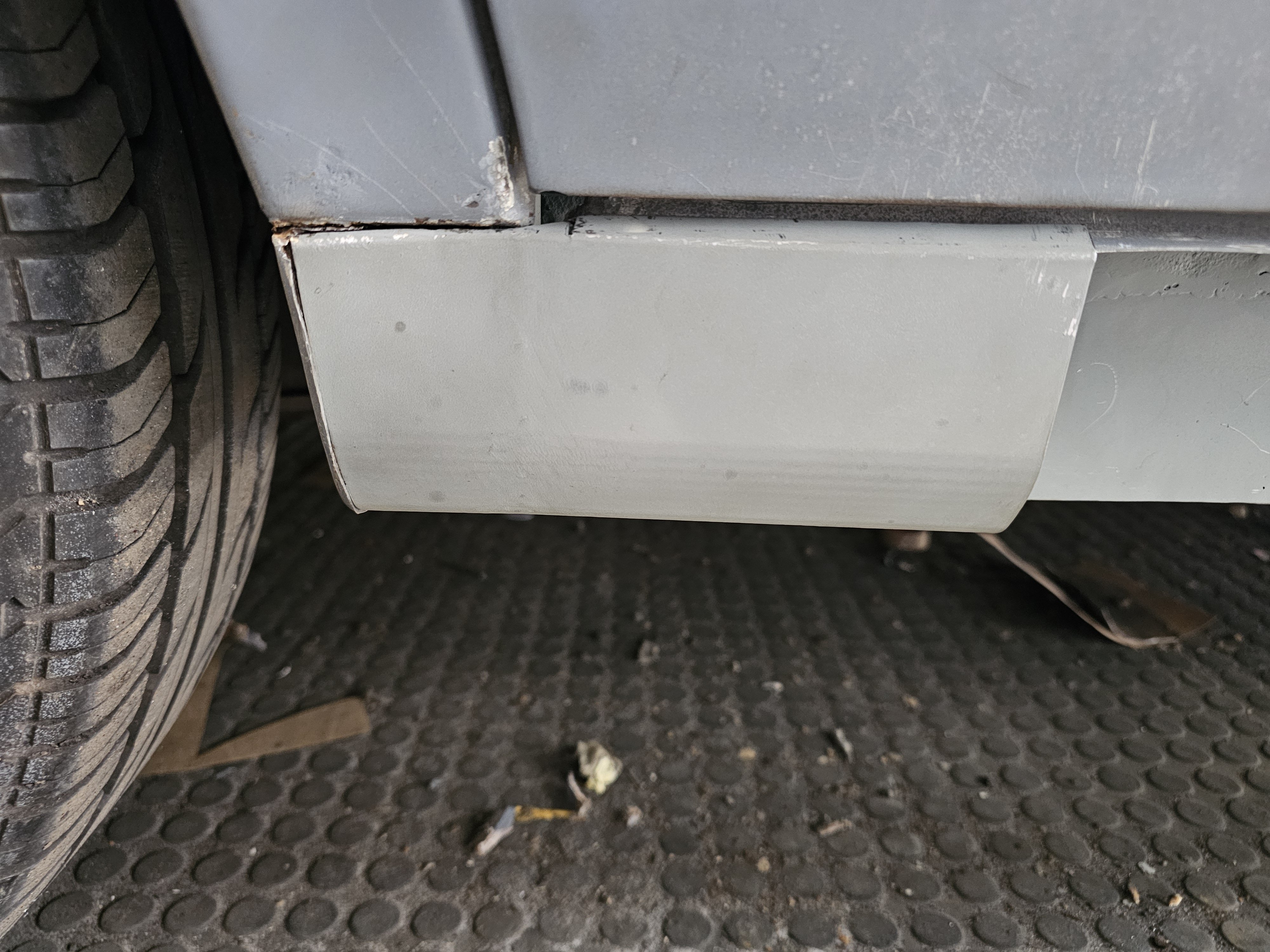

Popular Post BigA Posted February 22, 2025 Author Popular Post Posted February 22, 2025 Also created the rear lower sill including the inner structure which I will also have to replicate on the other side. 13 Quote
