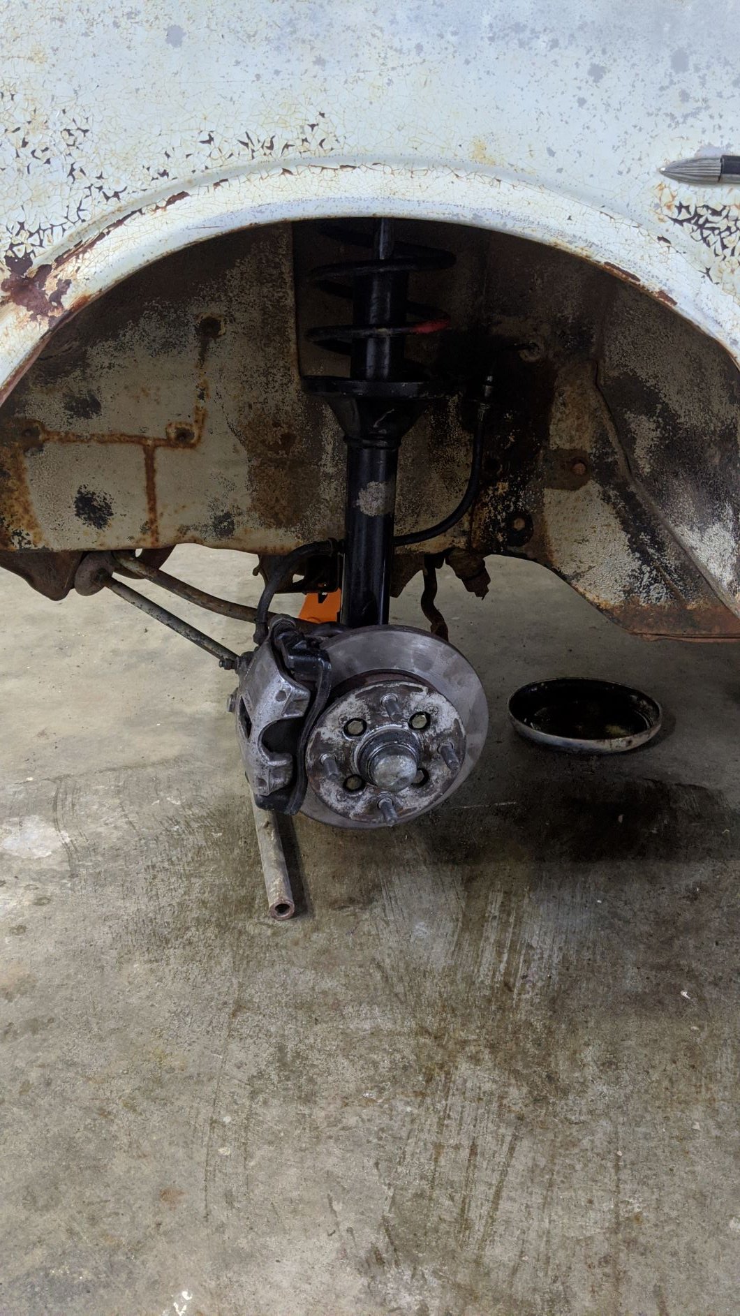

lownslow Posted November 2, 2020 Author Posted November 2, 2020 Small wheel update. I ended up buying my mates 13x7 superlites off him. These will do until i find some decent SSR's in 4x110. Took the balloons off and gave them a quick clean up. Will polish them on the brake lathe at work this week. Sat them on the car and had a measure up. Looks like ill have to go with 165/55r13 tyres, rather than the 175/50r13's that i wanted, just so they tuck inside the guards a bit better. Suspension will be getting a drop of 4.5 inches in the rear, and 3.5 inches in the front. Still undecided what short shock cartridge ill go with in the front. I have the Mk1 VW golf ones in my datsun, so might do the same with this. Also found some tail lights on eBay, so bought them and got them sent over from England. Front brakes finally installed too. 4 Quote

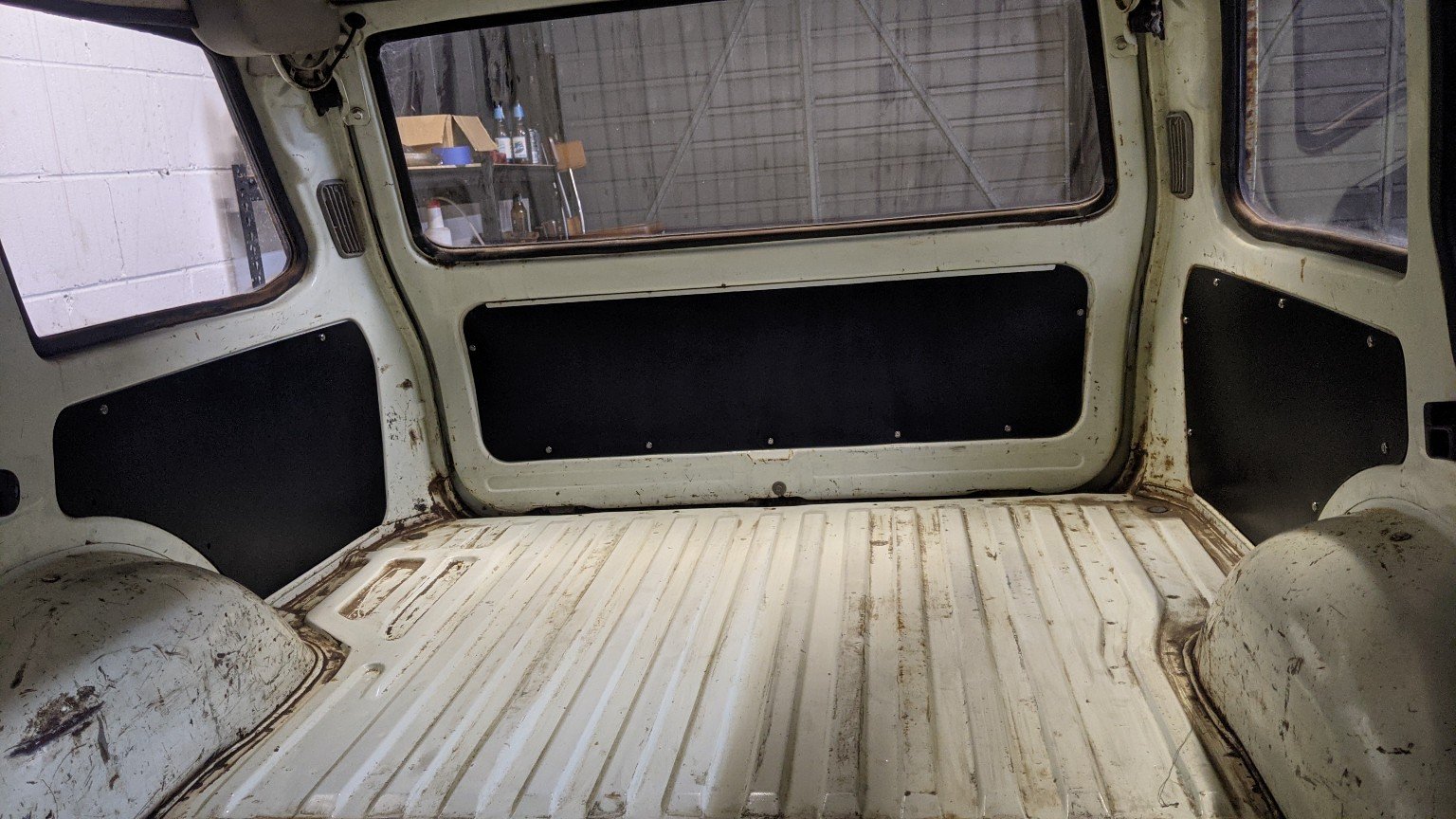

Popular Post lownslow Posted December 14, 2020 Author Popular Post Posted December 14, 2020 So I got a tyre fitted up today. Pretty stoked on the profile. 175/50r13 nankangs. Very cheap as well. Will fit the rest up tomorrow, and hopefully get some proper photos. Also bought some masonite in the weekend and finally made some boot interior panels, as they were missing. Has tidied the interior up tenfold. Highly recommend masonite over MDF. Much stiffer and easier to work with. Still need to get some speed nuts for the RH side. My front indicators showed up too. Genuine fakes from Thailand. Pretty happy with the quality though. Can't complain for $50 all up. 14 Quote

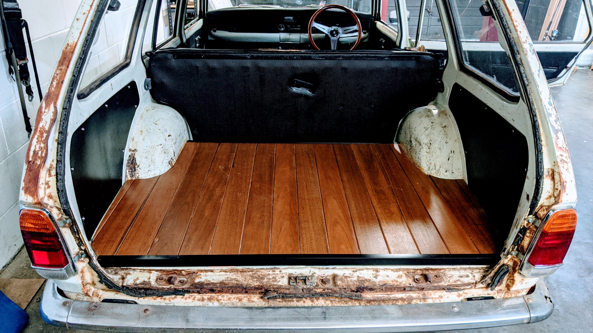

Popular Post lownslow Posted January 4, 2021 Author Popular Post Posted January 4, 2021 Finally finished the boot this past weekend. Won't be everyone's cup of tea, but decided to do a spotted gum floor. 27 Quote

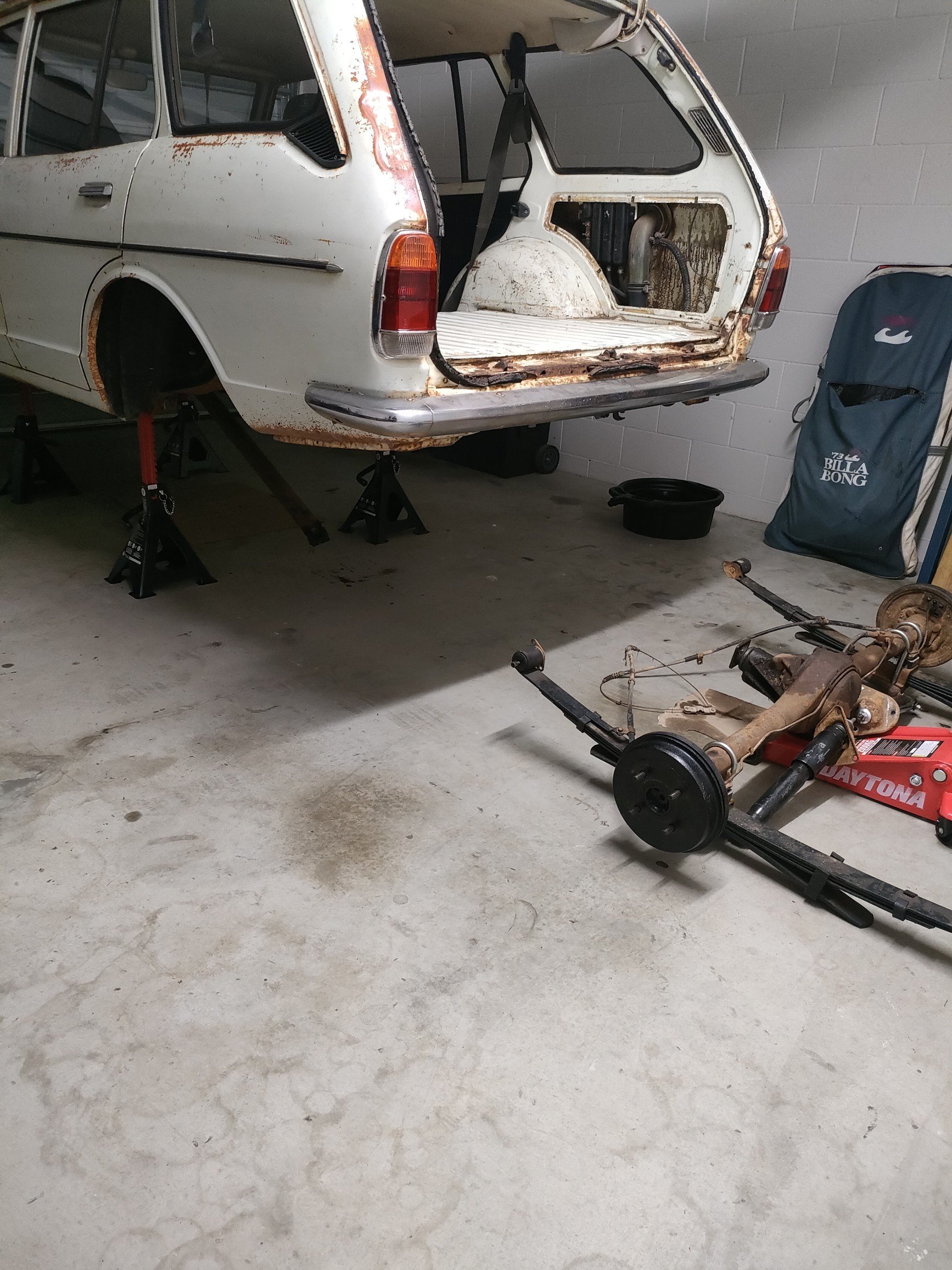

Popular Post lownslow Posted November 23, 2021 Author Popular Post Posted November 23, 2021 So after driving this for a bit, I really found it way too rough. Maybe I'm getting old. Diff hitting floor etc. Was going to cut out where it's hitting and modify it etc, but want new wheels as well. If I'm doing that all that, I might as well 4 link it, and if I'm doing that, I might as well change to 4x114, and if I'm doing that I'll have to stuff around and shorten the diff to fit the wheels I want. Long story short, shit snowballed and now I'm the owner of a shortened MX5 rear end. (And still have to change to 4x114) Will build some new rails for the frame to sit under, and run them from the back to the rear seat area, and try tie them in with the original rails. Really wanting to use 40x40x3 SHS, to keep the subframe as high as possible under the boot floor, but everyone seems to use 50x50 for this sort of thing. If anyone has experience in this, will 40x40 be enough? The original rear "rails" are only monocoque, so surely 40x40x3 will be more than enough for a subframe to sit under. I won't be cutting much out of the originals. 15 Quote

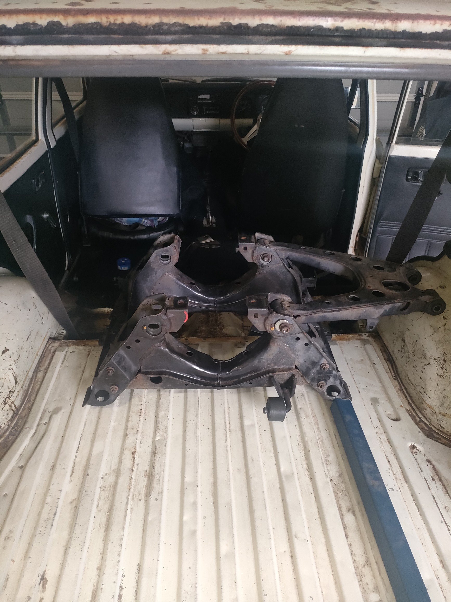

Popular Post lownslow Posted November 26, 2021 Author Popular Post Posted November 26, 2021 Got the diff and fuel tank out tonight, so started having a quick mock up of things. Seems like everything will be pretty well placed, and not hang too low. It will be getting raised another 20mm from these photos, as haven't cut anything yet. Will be about 10mm above sill height, so pretty happy. Would have to channel the boot floor if I wanted to raise it any higher. Also should be able to squeeze some 13x8.5 wheels under the guards too. Last photo is the look I'll be aiming for. (Different model, I know) 17 Quote

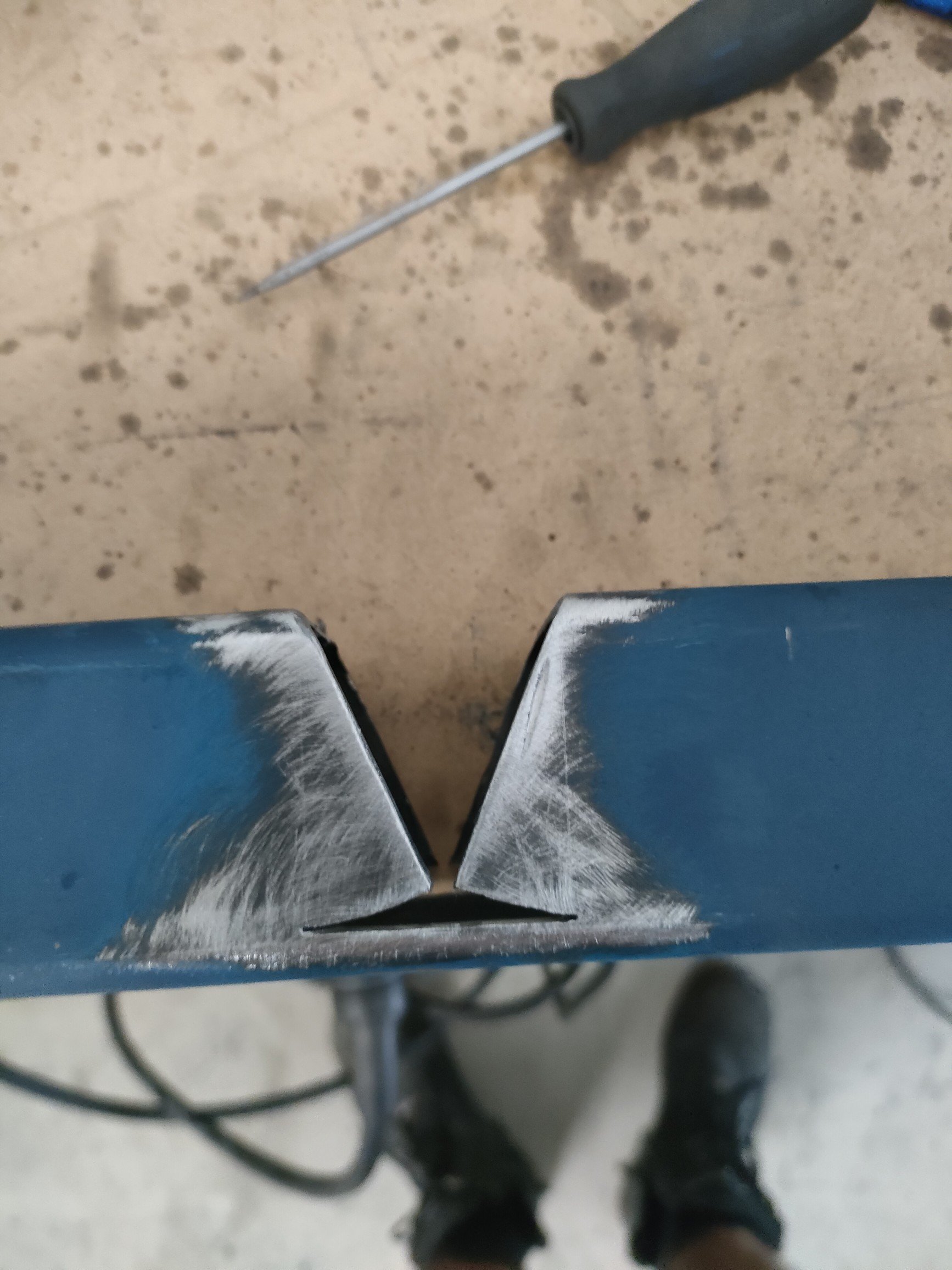

Popular Post lownslow Posted January 10, 2022 Author Popular Post Posted January 10, 2022 Started on the frame rails over the Christmas break. Ended up using 50x50x2.5mm SHS. Should be plenty strong enough. Especially considering that I can lift the whole rear of the car by hand, with the diff removed. Finally decided on how to do the bends. Was going to get them bent, but have heard horror stories about bending square tube. The mitre cuts turned out pretty good, and both rails are exactly the same. Also plated the existing crossmember. This is tied into the original front leaf spring mounts underneath. 25 1 Quote
