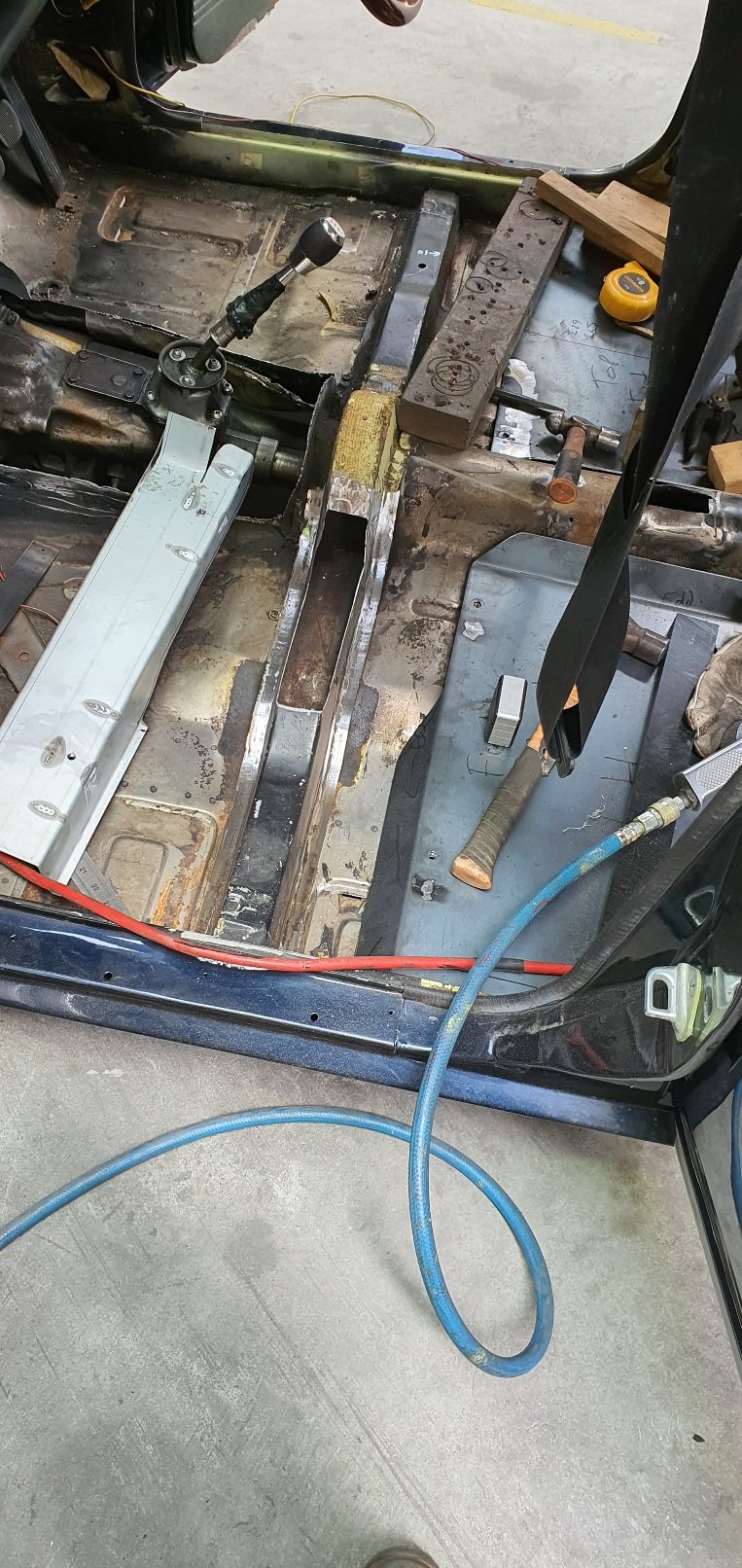

Mattt Posted August 20, 2020 Author Posted August 20, 2020 So I’ve been waiting for weeks now to get my grill, mirrors trims and stuff back from the painters before taking the car home but he’s been flat out and I’m getting it done for free so I’ve decided while the cars sitting at work to get into the main fabrication work. Pulled everything out to start dry icing the floor tomorrow after work. Then the plan is to cut the entire gearbox and driveshaft tunnel out, fit all new stuff done properly and that gives extra clearance for the driveshaft when I drop it lower. Then I’m cutting the channel out that runs the width of the car and I’ll fold up a 3mm plate that welds straight to the floor for the seat rails to bolt to which will give me about 60-70mm drop in seat height so my head won’t touch the roof and also stiffen the floor back up since I’ve taken the stiffener out. Wish me luck 6 Quote
Mattt Posted August 22, 2020 Author Posted August 22, 2020 Got this started yesterday. Decided to start with the plates for the seats. So I can tack them in to stiffen things up when I take out the top hat stiffener. Much better seating position now for someone of 6’3” however the mrs might not be able to drive it anymore... 6 Quote

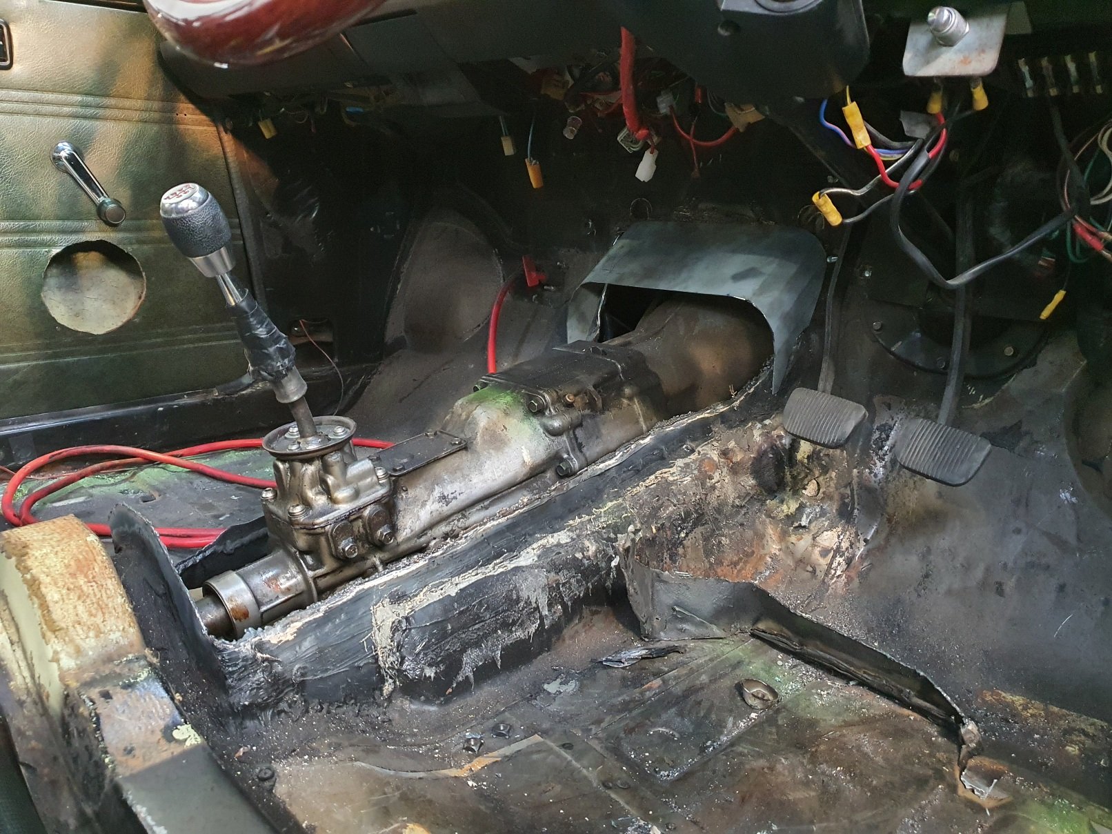

Mattt Posted September 30, 2020 Author Posted September 30, 2020 Started on the tunnel and finally got some trim parts painted! 4 Quote

Popular Post Mattt Posted December 31, 2020 Author Popular Post Posted December 31, 2020 Well after staring at this in the workshop for the last 3 months while we've been massively busy at work and I've been caught up on the weekends entertaining my son I finally managed to get a couple of days to spend on this so I managed to mount my seats and get my tunnel fab'd up. I had to change my plan for the seats as my original design ended up too low and too far back surprisingly. Also the cert man wasn't happy with me removing the stiffer running the width of the car. So, I went back to the drawing board and came with this Then I made up a cardboard gearbox tunnel. And decided I better turn it into steel Happy to have those big jobs ticked off. I do still have to pull the engine and box to weld underneath but the hard work is done for the tunnel fabrication which is great 16 Quote

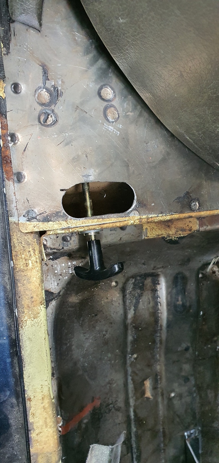

Popular Post Mattt Posted January 9, 2021 Author Popular Post Posted January 9, 2021 Boring update but will add it for my own records Got drivers window sorted Got headlights working Got seatbelts, rear 1/4 interior pieces and rear seats back in. Spent forever getting the boot popper in and working properly. Probably could have done a engine rebuild in the time it took to get that thing working smoothly. A couple of photos of the boot popper for storytelling appeal. Then I got it out and went for a dodgy, green stickered, no wof, no cert drive around the local industrial area for about 15 minutes to iron out any issues and get a real feel for it rather then 30 seconds up the road and back. Everything went really smoothly. The last noise left seems to be universal joints in the driveshaft. Will dig into those shortly. When I first bought it and put the engine in the brakes were absolutely useless, I couldn't fit in the car, the fan belt slipped and kept throwing itself off, everything mechanical was hitting the body, the handbrake cables were rubbing on the driveshaft, there were no window rubbers, the boot popper only worked occasionally, the steering wheel was so small it was a struggle to turn at slow speeds, the accelerator pedal linkage was a disaster and wouldn't pull secondaries and the trim paintwork was all falling apart. When I remind myself of all this I realize how far I've come in a fairly short time. The car is now really comfortable to drive for an old girl and although far from perfect I'm not scared to drive it. Anyway, enough of this. I'll keep moving forward with things slowly and hope to have it legal for next summer. 19 Quote
