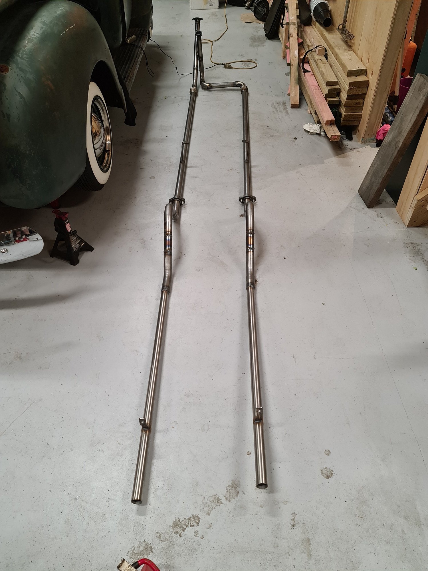

Popular Post MRWEST Posted October 29, 2020 Author Popular Post Posted October 29, 2020 double update tonight ^ Got the factory intake and exhaust manifold off and prepped it for the fenton style split manifold Got the manifolds on and all the parts from sticky flanges to make a twin 44mm to 38mm tail pipes exhaust to get some rapping going on . Also got the leaves in the front reset 2" to get it sitting a bit better. Bit of a before and after, looks much better i think! Finish exhaust, mount the siren and we are good to go to beach hop. 19 Quote
Popular Post MRWEST Posted November 17, 2020 Author Popular Post Posted November 17, 2020 Last minute missions for beach hop. Built the exhaust with no mufflers, Was so loud, had the bomb rap going on but bit too loud haha. So chucked a couple of mufflers in last night. Gave the old siren a bit of a birthday before it goes in the truck. Mount that and we are good to go for beach hop next week. 19 Quote
