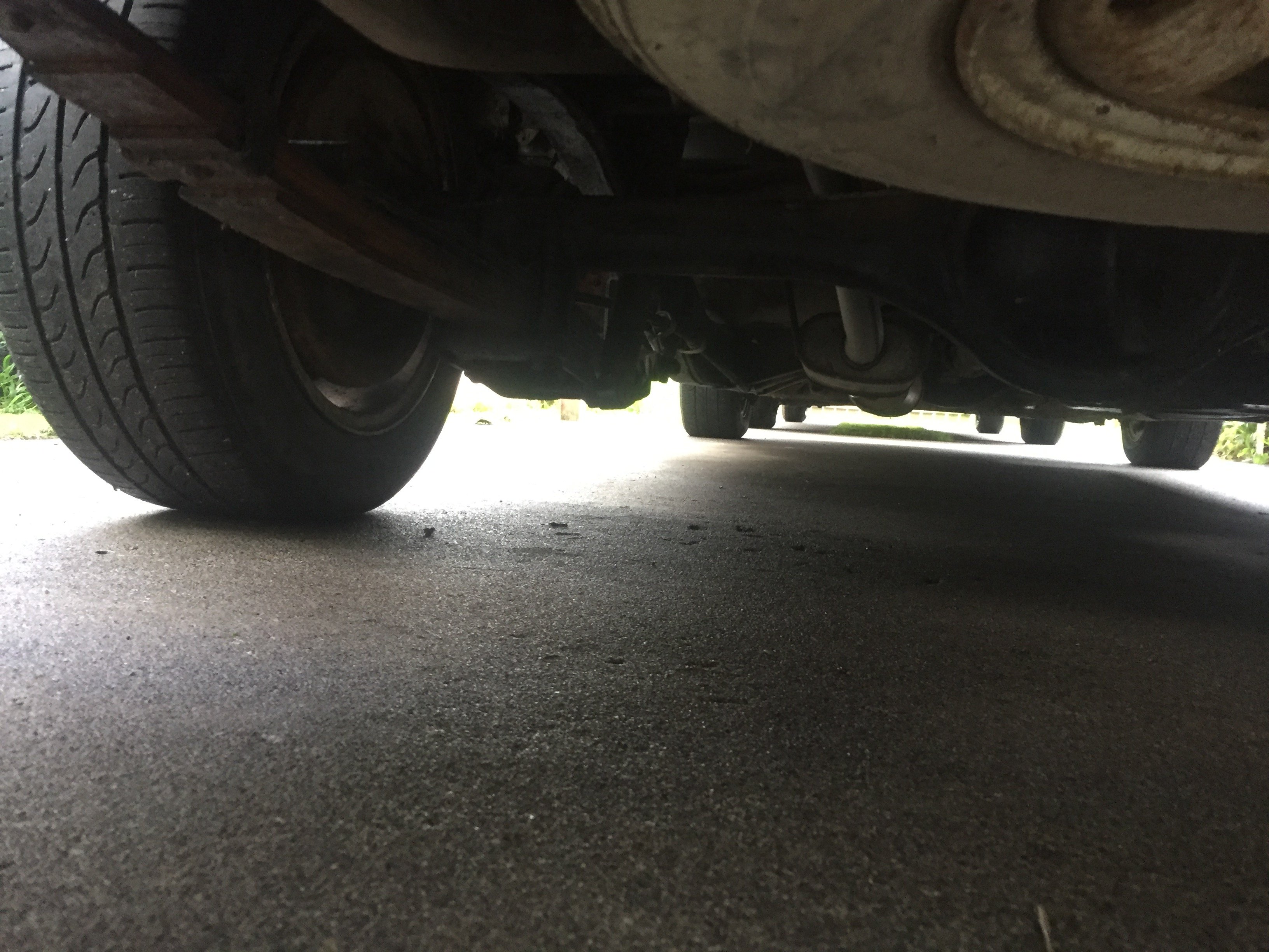

Suspension done. She’s sitting kinda high considering she’s on 2” blocks. So I figure reset leafs is on the cards in the future.
Full brake rebuild done with new slaves and shoes in the rear and rebuilt calipers and pads in the front.
Rocking the black steelies on the front and an alignment has sorted out the geometry issues.

It's less than a week overdue on it's wof. I knew it wasn't going to pass on the rims and tires it was on out back.
And I've noticed something I don't quite like in the rear brakes under heavy braking. So I need to get them looked at.  Again crud in the lines is the high suspect here. Everything else is pretty much new.
Ass end is stiff as fuck. and still sitting high despite being on 2" blocks.  I'm wondering if the leaves being from a single cab make a difference. Slightly longer possibly.
Wondering if pulling a leaf out of the pack is an option.
