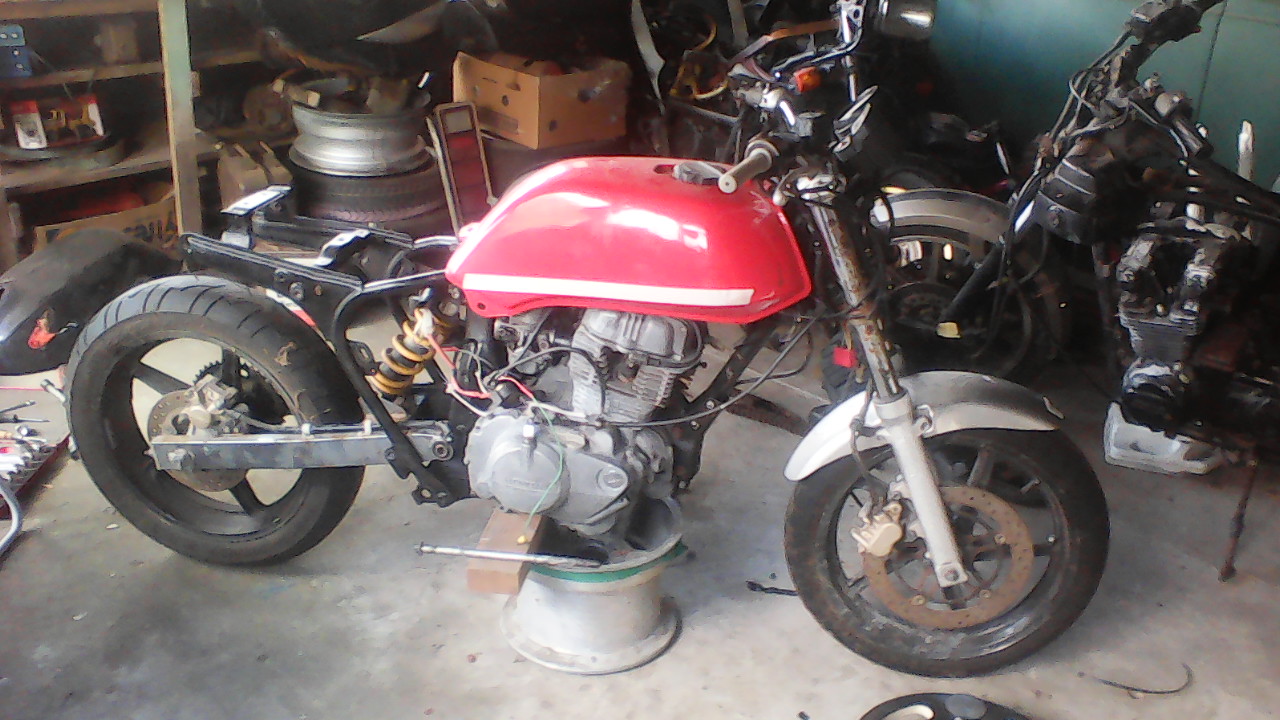

Hillbillyracing Posted February 4, 2018 Posted February 4, 2018 I picked up this cb400 real cheap hoping to just resell and make a few $$$ but after looking at it and run a tape over it. I found that the forks and swing arm from the VTR250 very close fit to the CB400 .So i put the gt750 aside and got busy pulling both bikes apart. Sill not sold on the tank tho 3 Quote
Hillbillyracing Posted February 4, 2018 Author Posted February 4, 2018 The forks are a good fit and just have to change the bearing .but the swingarm is a tight fit and will have to make some new bushs Quote
Hillbillyracing Posted April 13, 2019 Author Posted April 13, 2019 It was time to show some love and fit the mono shock. Could have made a better bracket Thinking of fitting this. any pro's and con's? Dont quite line up 5 Quote
