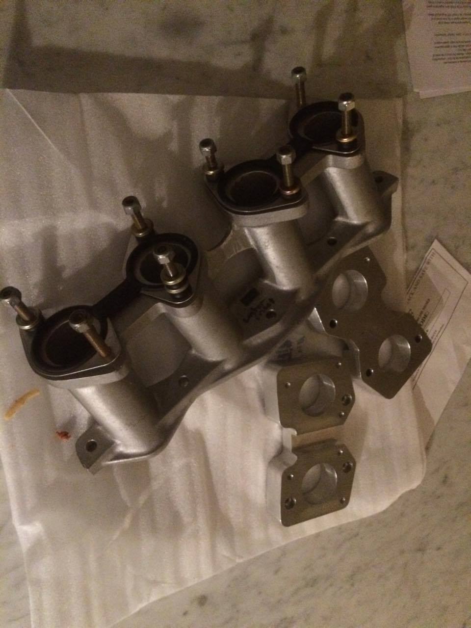

Bought these today which are soooooper cool. Twin 36 dellorto downdrafts, such an awesome set up. unfortunately never got to run on my car but ran on a friends car and ran super mint, sounded the bees knees.

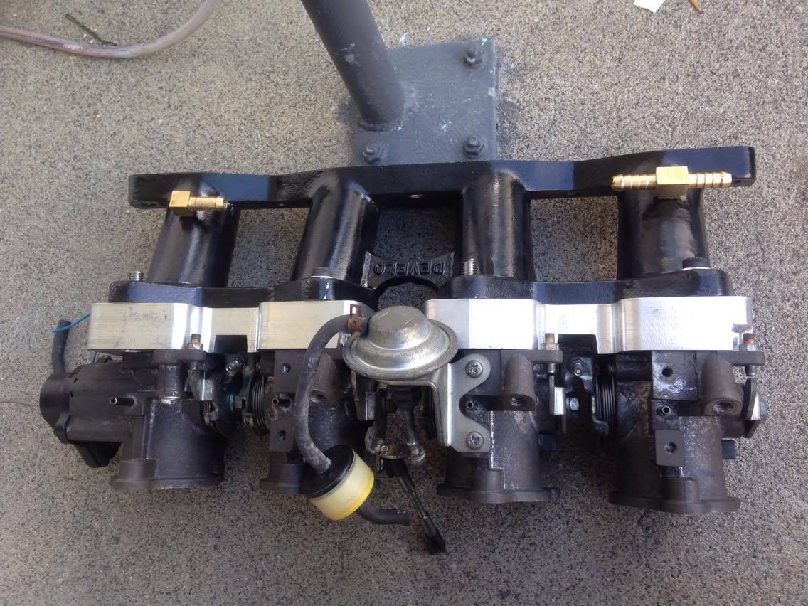

So originally I was planning to run side drafts BUT I didn't want to be the typical escort, so I ended up buying most of the things to a fuel injection set up using
-4 age itbs
-link ecu
-(bought these on my own but Ford KA coil packs)
and a couple other bits and pieces necessary.
So my good friend Ashton, who puts up with all my shit and questions (thx g) kindly offered while he was on acc was to bolt these all up and sort them out and the end result was suppppper pleasing to see so thanks to the man

Got the motor in and the throttle bodies hit on the firewall and brake booster, so back to square run and now to this day I'm still running the dinky di little 32/36 which isn't enough for the 11-1 compression ratio under full go.
Got there in the end after about 3 months of set backs.
