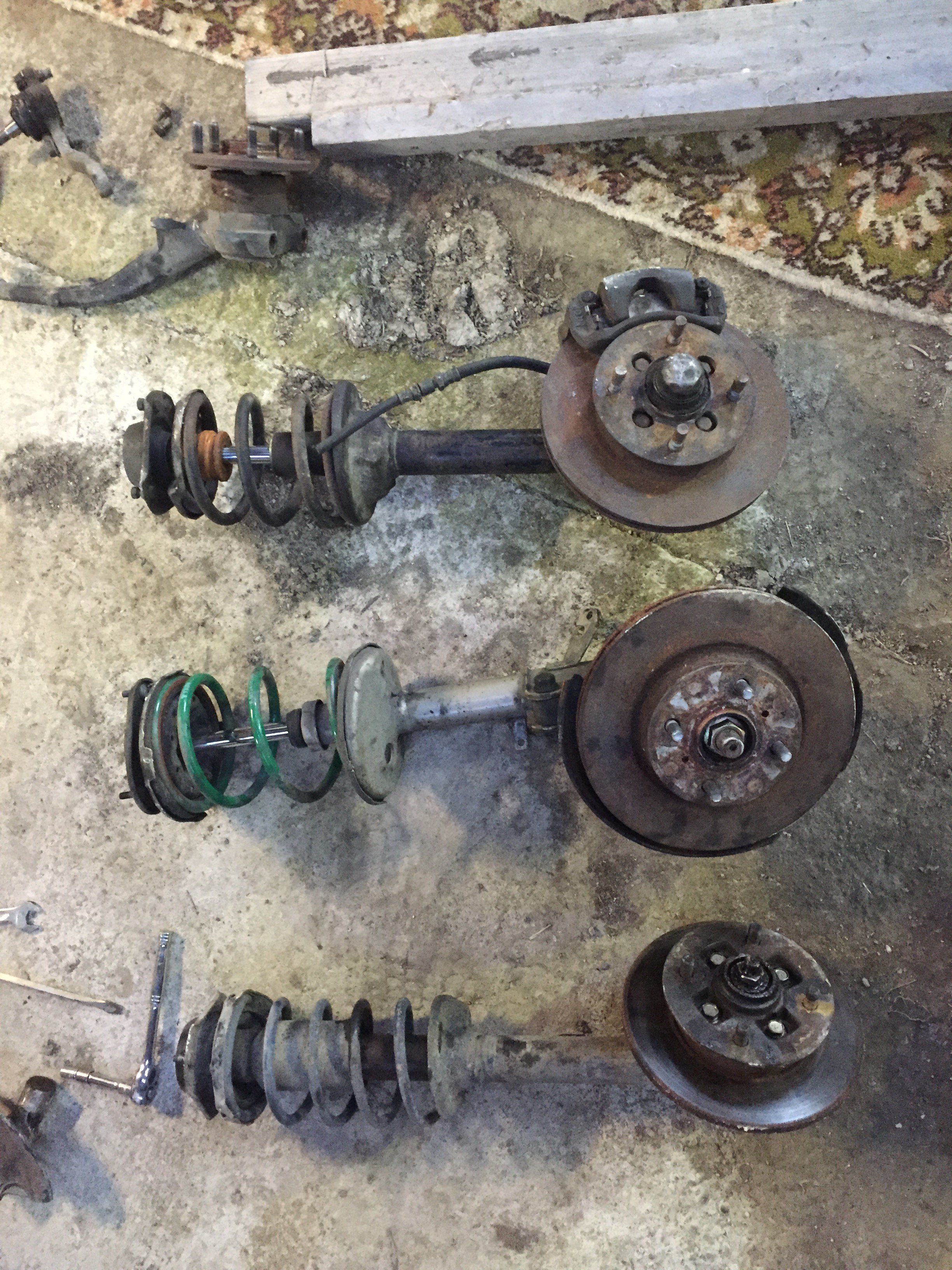

Dstaar Posted October 12, 2017 Posted October 12, 2017 Third time lucky, sorted the front suspension problem last night! Paid off purchase from trade me, ready to start work on tran’s tunnel next. Will upload all photos to a photo bucket album today 1 Quote

Dstaar Posted February 11, 2018 Posted February 11, 2018 Have not updated for a while but Front suspension is sorted, still deciding on 4 stud or 5 stud Quote
