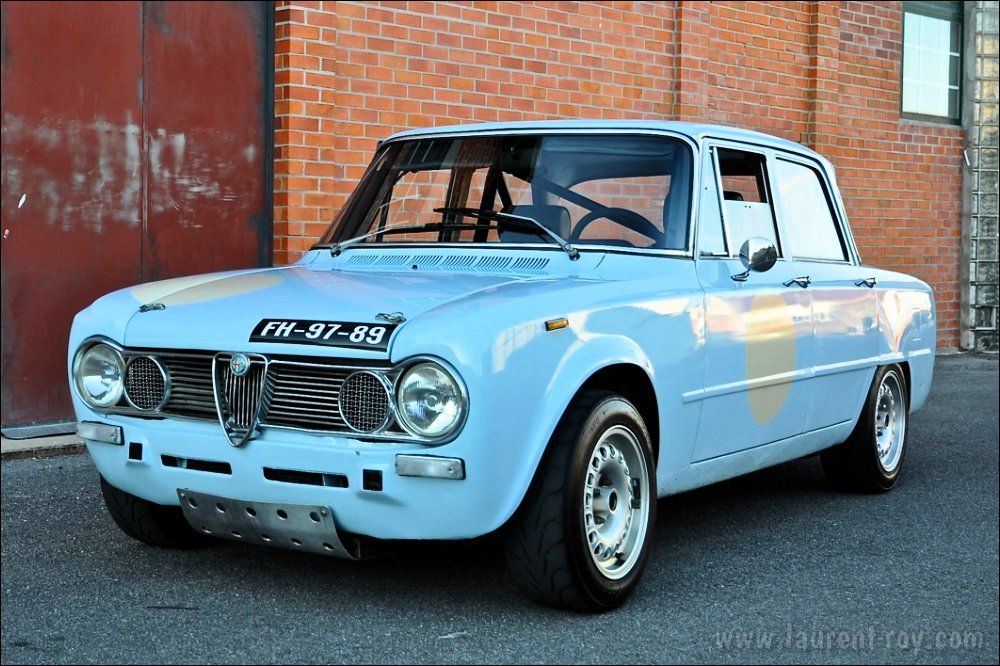

Popular Post Krupkee Posted December 16, 2016 Popular Post Posted December 16, 2016 Bellett I recently purchased to replace my aw11 i sold bought unseen on trademe, bit of a risk but pretty happy with the result, runs and drives well, had a wof 2011, reg on hold bad points -Doors -Guards -3x small bits of rust to weld patches in, boot shut, top of one sill and passenger floorpan, overall not bad though -wayyy too high -paint to do -either find better doors and guards or repair current ones -strip paint to bare metal, started already -paint, will do myself, thinking gulf blue or similar at this stage, maybe black bonnet -low -interior re-trim -misc trim bits, seals etc -in future g161z from holden/isuzu gemini but current g150 will stay for a while Delivery Interior, all gauges work, some bits to remove, wheel to be re-done after removing front trim bits, started stripping paint after this ass shot worst rust to repair (apart from FL guard, and its not even a bit hole More bog than guard paint has 2-3 layers so a lot of places look way worse in photos, rear arches are mint, nothing under carpets except for small hole Inspiration colour I am thinking 20 Quote
