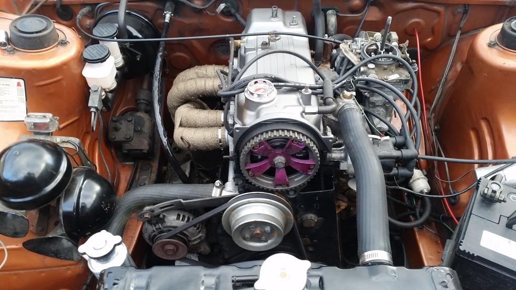

After having her for about 2 weeks i decided the old 4g32 had to go so i was on the hunt for a cheap 4g63 then only after another 2 weeks i had one ready to drop in.
once i had the cam belt off i noticed the cam pully had a crack in it so off it came and i had a dohc one (they are wider so i cant fit the timing cover back on) that is adjustable so on that went and then just a general tidy up before it went back in the hole.
Here is some for pics from the swap.
the other thing i needed was a longer speedo cable but every thing was just a bolt in.

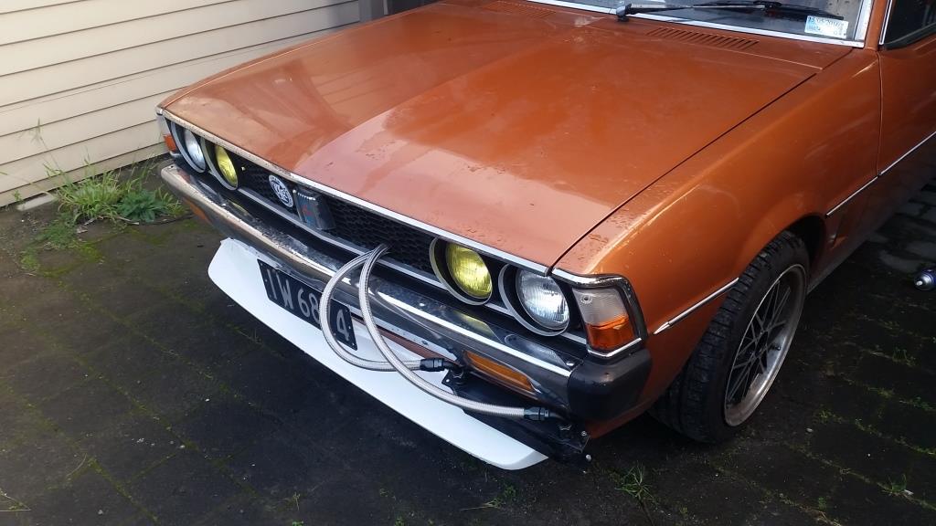

Not much of an update but i picked up a chin spoiler the other night so then decided to mock up how it would look on the car, and it didn't turn out too bad. i am still yet to make up metal tabs to secure it on but i don't want to drill extra holes into the body but then again i don't think i will take it off so drilling holes may not be such a big deal.

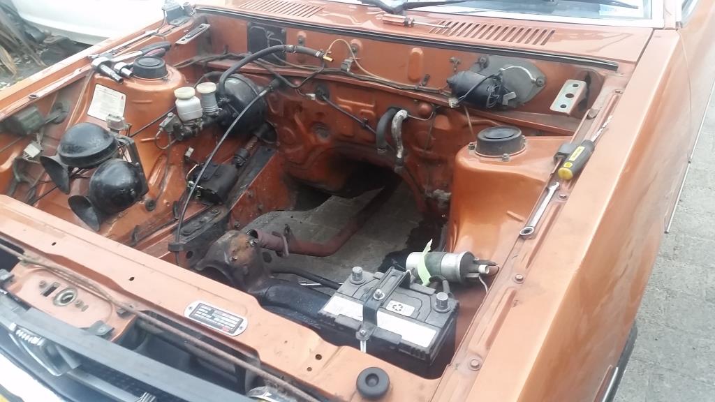

so i decided it was about time to pull the 4g63 out and either fix the alternator and carby problem and replace the release bearing or drop in the 4g54 i had lying around, after taking out the driveshaft and taking off all the wires so all i had to do was hook up the crane and then unbolt motor and gearbox i looked at the 4g54 and noticed the teeth on the flywheel had hit something in the past, so i decided to fix the 4g63 as i have put a new clutch, new starter motor and new timing gear inc water pump so to do that to the 4g54 would just be a waste of money (yes 2.6 would = bigger skids) so i waited until i could find a carb and alternator, about a day passed and i got offered another 63 for $100 so ill pull the bits off that and put on my motor then back in the hole. while i was looking at the starion sitting in the driveway i decided it was time to pull out the front suspension and put that into the sigma, and that's when the engine swap weekend turned into a front suspension swap weekend, all was well until the front control arm bolts were too big to fit the starion control arms after getting them machined down they went back in and now i have starion struts, control arms and brakes on the sigma maybe ill get the motor out next weekend.
while i was putting the brakes in i decided it was a good idea to clean everything up so the backing plate is black along with the arms then new rotors from japan now just to bleed the whole system

i did it  :) lol finally had the engine swap weekend last weekend motor out, change carb and release bearing and back in only 1 problem the alternator didnt fit so i need to get another one but that's not a biggie this weekend it driveshaft in, radiator in and wire up, while the gearbox shifter was out i decided to change it for my starion one i had lying around and it was about 25mm shorter than the L200 one (not a short shift but i am looking at one) it was mainly because the new shifter boot was too short and you could see the shifter so the starion one is short enough that it fits nicely in the boot.
After looking at the hoses i decided it was time for the 33 year old hoses to get replaced and upgraded so i sent the old ones to one of my suppliers and the next day my new braided hoses turned up and looking too flash for the car lol so they will go in this weekend then bleed the system, then the only thing to sort out is the height as the starion springs raised it about 30mm from where it was sitting then sort out is the alignment as the starion struts gave it crazy toe out, but that cant be too hard to sort out (famous last words) also i painted a spare rocker cover and extractors with VHT Cast Iron then wraped the extractors in lava rock exhaust wrap to try and keep the temp down and to tidy up the engine bay a little more.
