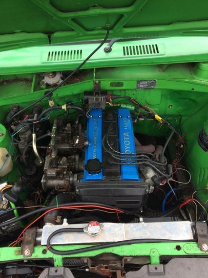

The wiring is shall we say creative it works but umm how.

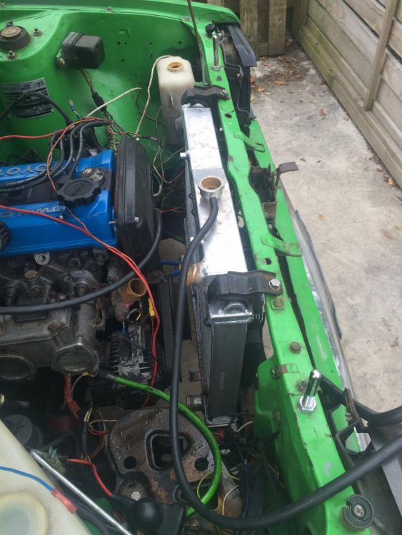

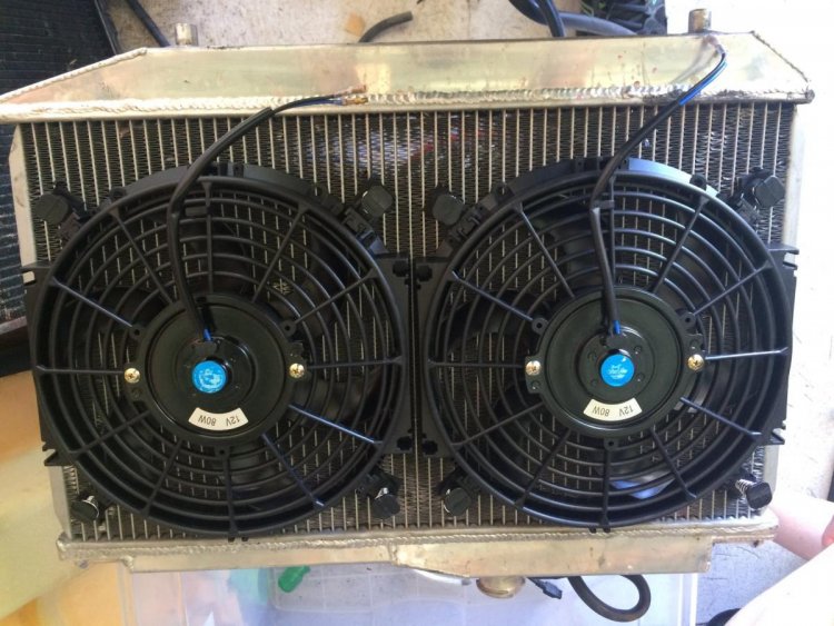

2 x 10 inch radiator fans
also discovered the radiator was cable tied in on the bottom so will make up a mount to fix it to.
also ordered a hyperpak ignition module for the timing.
seemed a better option to converting to K dizzy.
ok so this weeks mission was sorting the radiator.
The fans arrived and fit on very well.  With no instructions on mounting with the kit provided I made best practice guesses. - happy with the result.

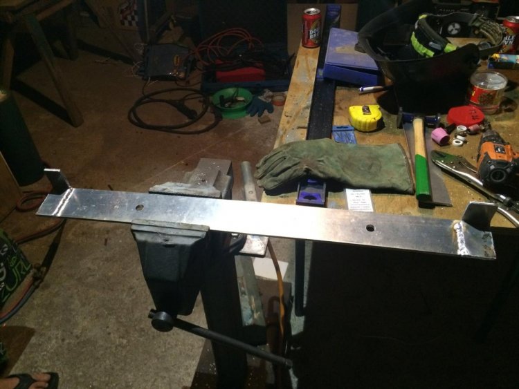

Next was to build a bracket to hold the bottom of the radiator.  The normal mounting point for these cars is a radiator with taps on the sides and you bolt it to the verticals that sit either side of the radiator.  I didnt want to get a new radiator as there is nothing wrong with the rest of this so I got some ali and went and visited a few mates.  I dont have a complete photo of it and I still need to get a two new gromets for the holes but it worked a treat and now the radiator isnt moving an inch.

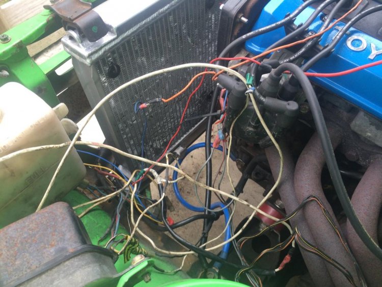

Spoke to Marc at Marcs Auto Electrical he is the guy that will lead me on the re wiring of it and installing the hyper pack.

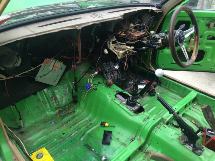

he is coming around next week to get started.so I figured I might as well start making room for us to work and unwrap the silly amounts of wires that go every where. straight away found 2 wires that were about 2M long that were not connected at either end.
I also hate working under dashes and seeing as taking one out of these is a minor job did that to help with the future.
wired up the engine bay . amazing how fast someone works that has done it for a living.
Marc from Marcs Autoelectrical makes short work of looming it.
next week we will do the interior and the hyperpak pics to come when the job is all done

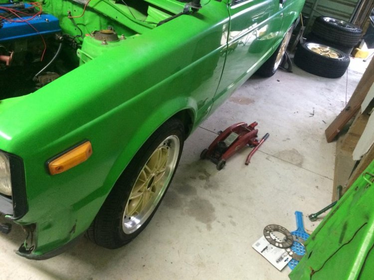

got some new shoes
15x7 +25p
they were alarmingly cheap with tires so I got them so it would be with in its cert until I can decide what to do next.
They look better than I thought pretty happy with the result.
fitment looks great and with out driving it looks like it shouldn't rub.

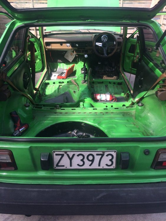

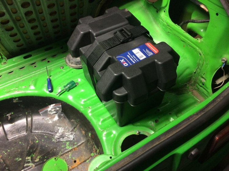

Last night dropped my fuel tank and fitted the battery box.

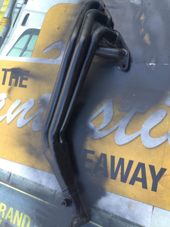

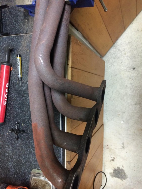

got some heat proof satin black and gave the extractors (with fitting for wide band) a buff up and a paint.
trying to do something every night so I can get it all going asap

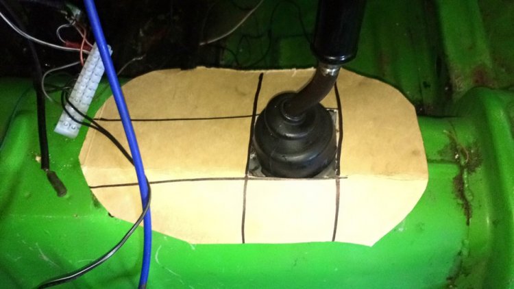

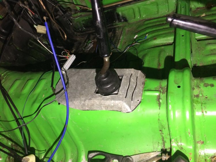

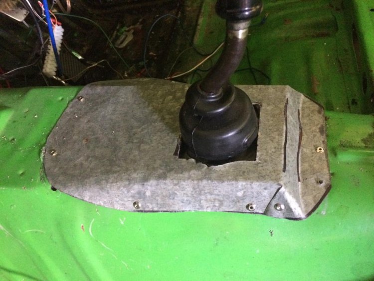

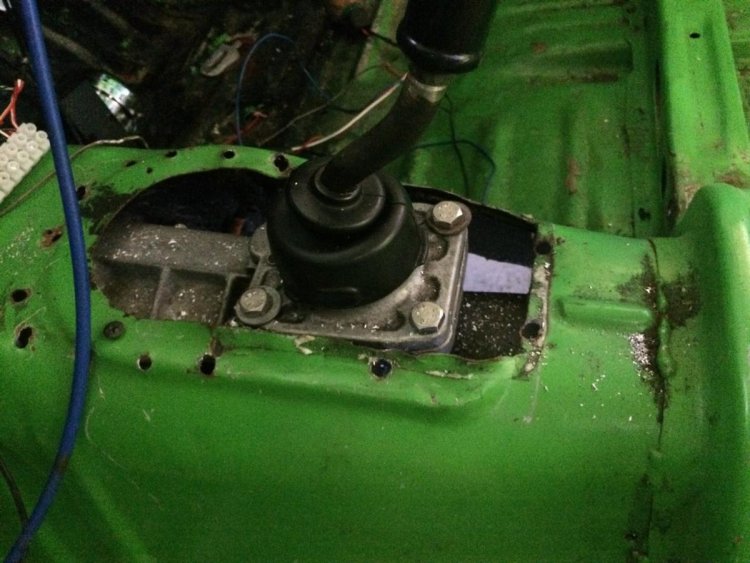

Now I'm no sheepers with his magical glue gun and im a function over form type.
here is my way of covering the hole cut in my gear box tunnel im very happy with the result
also baring in mind there will be underseal, underlay and carpet on this so it will probably never see the light of day

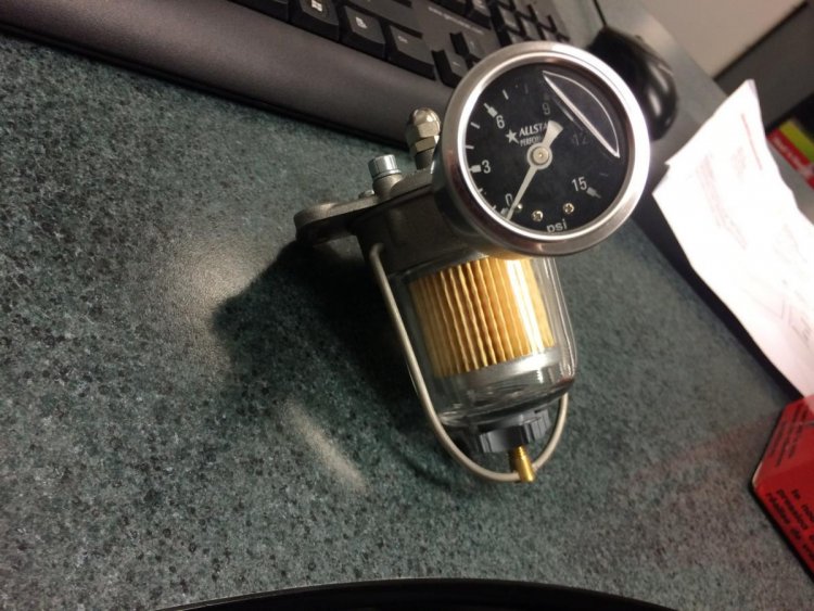

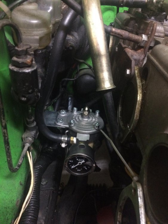

Fuel Pressure Reg.
as mentioned above had no puel pressure reg.  Did some hunting and Malpassi have a pretty good rep.
Webber Specs seemed a good local place to get one so after a quick discussion with the guy there I got this.

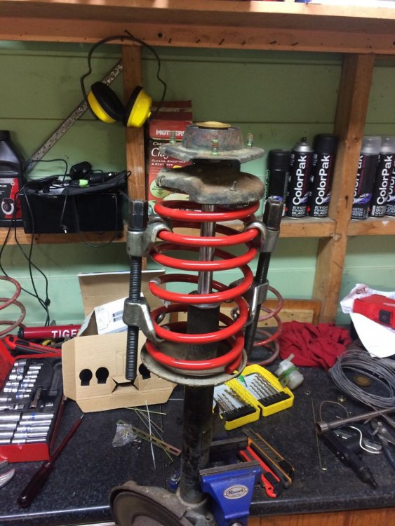

Suspension.

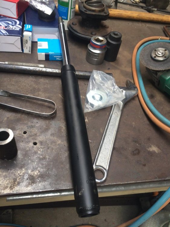

Went with cobra super lows got a stupid good deal through a family member.
Front shocks went to SAS and found some that fitted but god knows what they are out of.
very happy with the new practicable ride height.

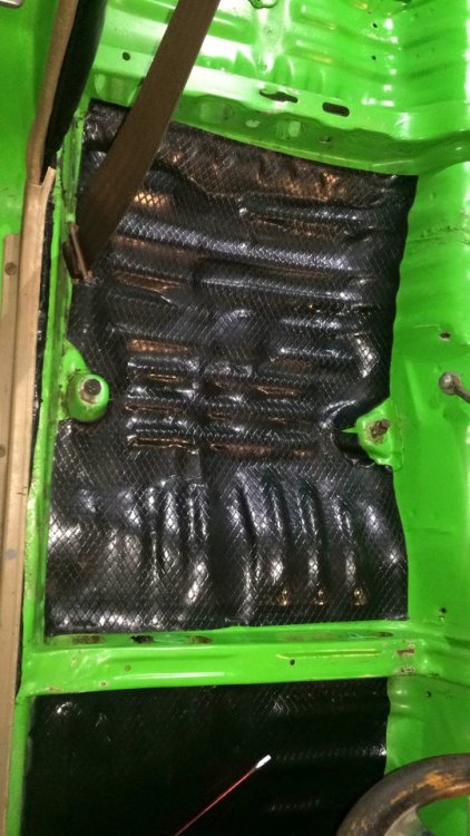

seeing as this car is built for gumbootrally (1000km of driving in a weekend) cumfort is important to my old body.

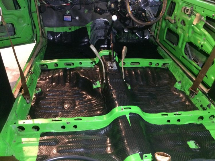

step one fitting Teroden sp300 - its like dynamat but has more of an OEM look and is around half the price. I had a little Dynamat left over so I used that too.
I got this from Car Colors if anyone wants to use it you cut it to shape peal the backing off and use heat (a fair bit) to mold it down id suggest a two man job and allow a couple of hours but the results speak for them selves.
good time to give the car a good hose out too.

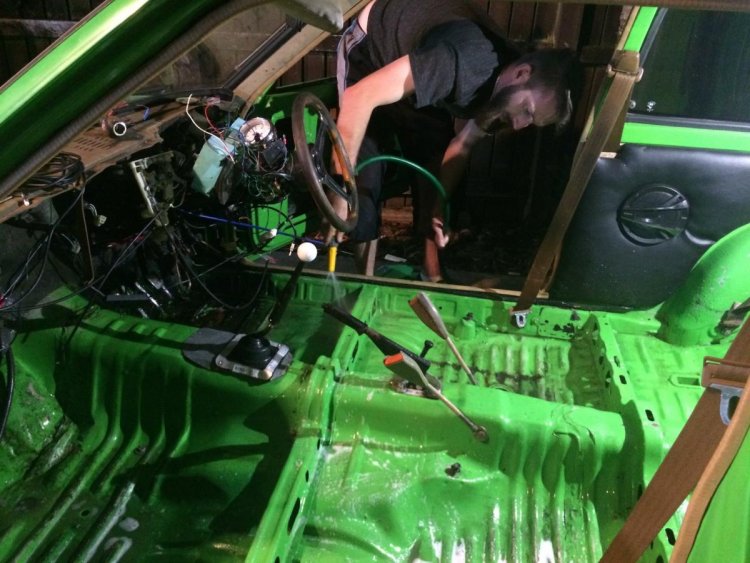

The auto sparkie came around last night and we got a fair bit done.
Looks awesome again watching someone at their trade is something I am still in awe of my trade is talking so not that exciting to watch.
almost ready for start up.
quick before and after shots to appreciate the work

Front shocks have left to get shortened.
