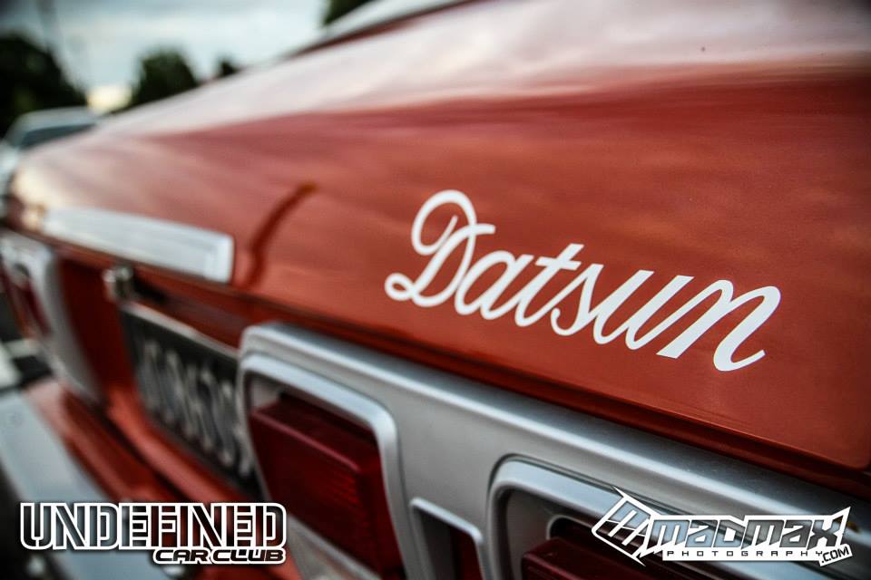

Ok so with car painted and side trims and badges all removed i needed something to fill the void coz so many people dont know what it is so i opted to get custom stickers first obviously is the datsun logo to match my tattoo, then a one of a kind custom, i got the rs1800 escort side decal made into 160j sss i love it to bits!

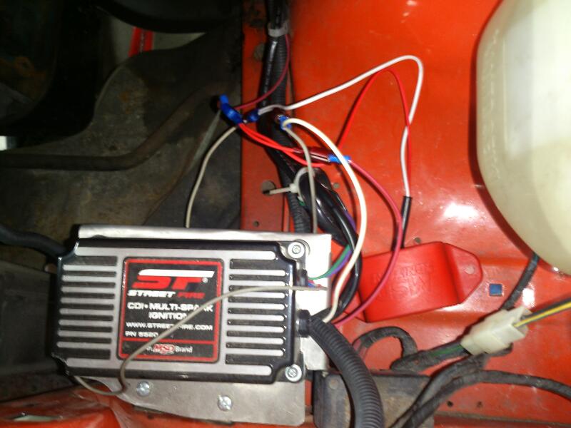

So next was a few things i needed to do, the cut front spring made for some shitty handling sometimes so had to remedy that with custom made springs and shortened shocks, also jut coz the idea of points bugged me and the electronic ignition module i bought wudnt seem to work no matter what we did i opted for an msd cdi unit which is really cool and gives me a setable rev limiter which i like, then like a year laer i got the adapter to make my tacho go as i had been without one for so long.

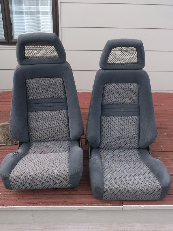

Update! Went to a track day a few months back and absolutely hated driving this thing around because of the seats, i desperately needed some new ones, i did a little research on what would fit pretty easily without mods that would need certing, found measurements etc decided on fishnet recaros from an isuzu bighorn, picked them up from the wreckers for 250, pretty dirty but in pretty good condition really, cleaned them up at work with shampoo and a wet vac and with very minor ahd mainly unseeable mods they are in and soo comfy.

No updates for a while here just been trying to get out and drive and enjoy the car, a few weeks ago me and my brother and father all went for a drive in our own cars, we were on back country roads and speeding along, about 120 kms and my carlet out the biggest backfire ever,then nothing no power just nothing, luckily my dad hadsome small and i mean tiny wires in his car that we mwnaged to get me home, my 300 odd dollar msd had shit its pants and i had no spark. As you can imagine i was pretty pissed off about the msd so i looked into buying another but couldnt justify costs, so i went looking for alternative options, i found at jaycar an electronic ignition module, essentially doing the same as the msd but minus the capacitors, it was in kit form but was only 67 dollars so i decided to jump at it and have a go to build it myself.
It took me a few hours and a few coffees to keep me interested but it was done, i installedit the next weekend and the car started and ran awesome, once played with all the settings on it and adjusting the dwell and my timing the car was running better than it ever did on the msdso heres a fewpics.
