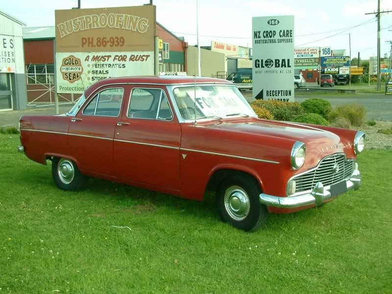

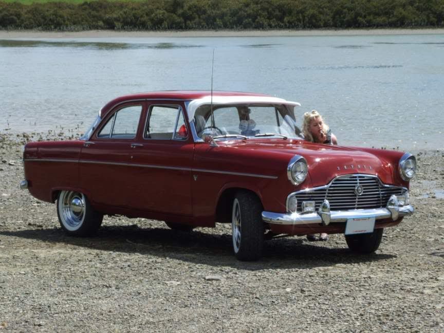

I think I might be bordering on obsession here now lol. Yet another car joins the stables. Named Maxine after my mother who sadly passed away Dec 10.
Runs a 3 on the tree box with no synchro on first or reverse, hydraulic clutch thats fucking heavy connected to a meaty Straight 6 with a reasonably straight through exhaust. Sounds grunty. Even if it aint lol. Has millions of receipts for vast amounts of mechanical work done to it over the past decades. And it even has the original dealer warranty papers. Apparently, some guy in Papatoetoe bought it new.
4 wheel drums. Its the flash version with the heater and fan and variable wipers lol. Done a genuine 43,000miles. Picked it up today with a brand new WOF & 12 months reg courtesy of old owner.
Just some pics of how it was when I bought it. Suggestions? It's 100% original currently so would like to keep it looking that sorta way.

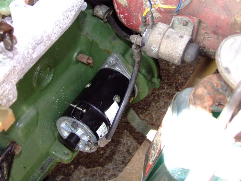

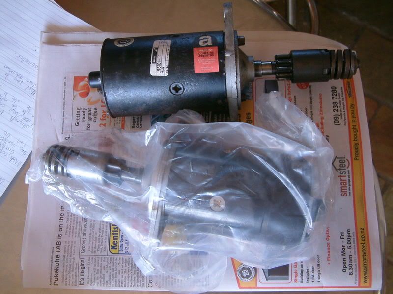

Well, after towing my busted trailer to Pinto Trailers on Sat to get it fixed when some hoe ran into it, and breaking down on the Harbour Bridge (stupid useless fuel guage), the starter decided it didn't need to have a complete armature anymore.
Cue new starter - thanks Appco.
And new starter installed. You can also see the button in the main power wire to the starter. Enables you to activate the starter from under the bonnet for timing etc adjustments. Not starting :(

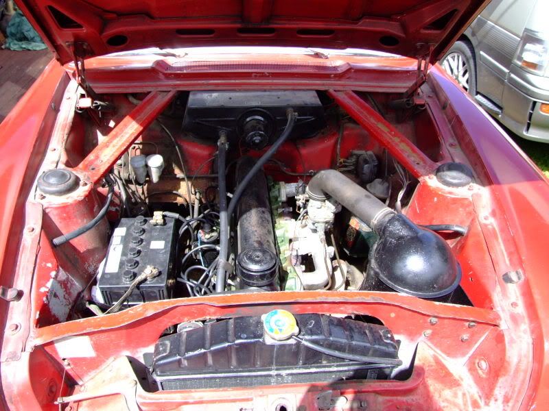

And just cause I'm nice and haven't put pics up yet. Heres the mighty powerplant. Well, its probably not all that mighty, but its got that much torque - it pulls alot like a little school boy.

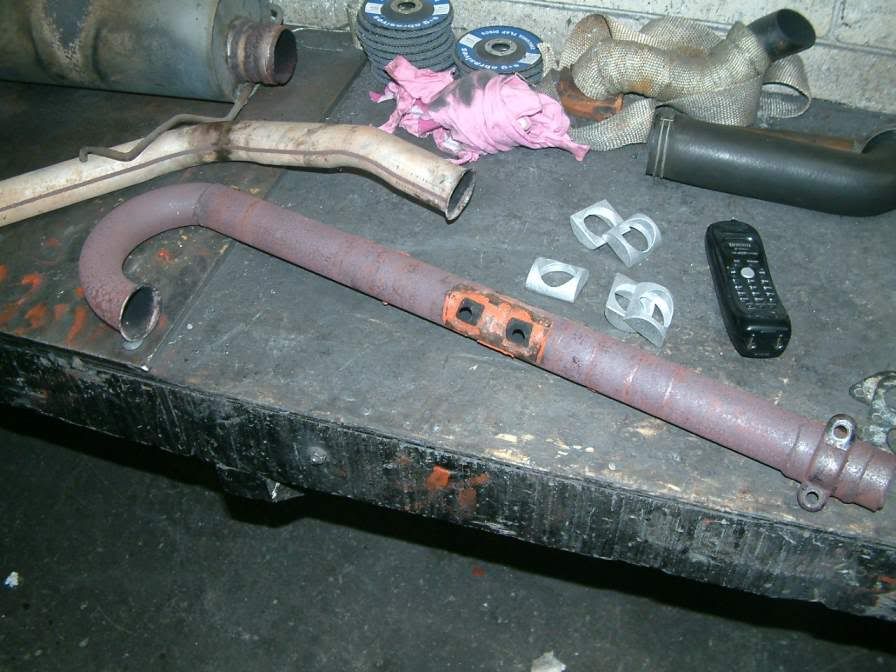

And just for interests sake. Heres the exhaust manifold. The most horrible restrictive manifold on the face of the planet. A piece of pipe with holes for the exhaust ports. Speaking from experience, my old man said that extractors and a decent exhaust free up a ton of power in these, so thats a high priority. Intake manifold aint brilliant either, as I hear it creates hot spots in cylinders 5+6 due to leaning out, so will have to investigate that.

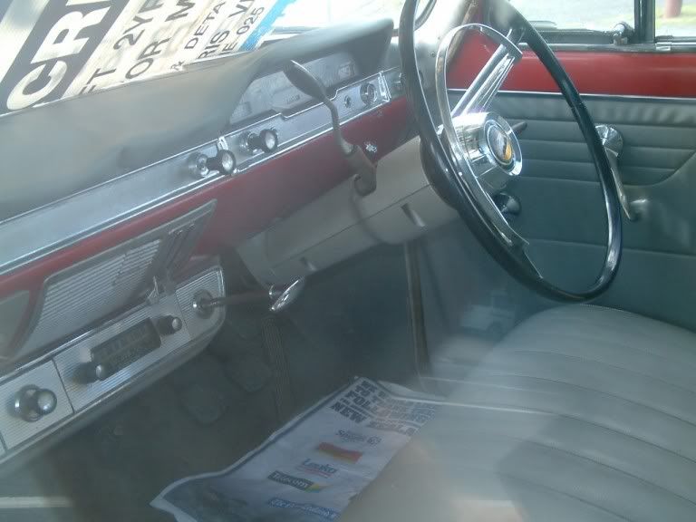

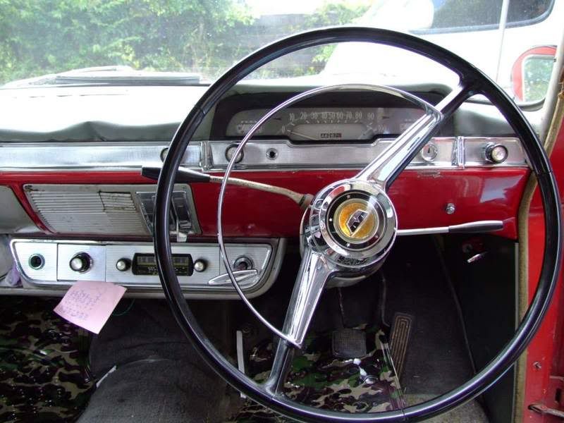

And some scrubbing with the autosol on the dash chrome (as well as everywhere else but theres more pics to come shortly with a couple other things to show as well). Bought the chrome up mint. Tip: An old toothbrush can be invalueable here for little nooks and crannies!

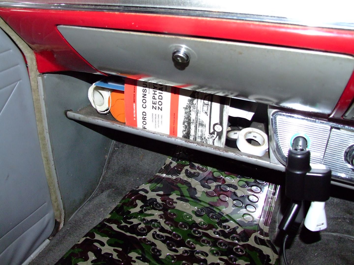

Can also see the ciggie lighter I snuck into the factory hole down bottom left. This particular car didn't have one from factory, but they were a factory option. Feel free to flame my nasty camo mats - they were a 2005 xmas present from my Aunt and they've just been sitting in the Simca doing nothing. Since someones put new carpet in the Zephyr, I may as well try and keep it looking reasonable.

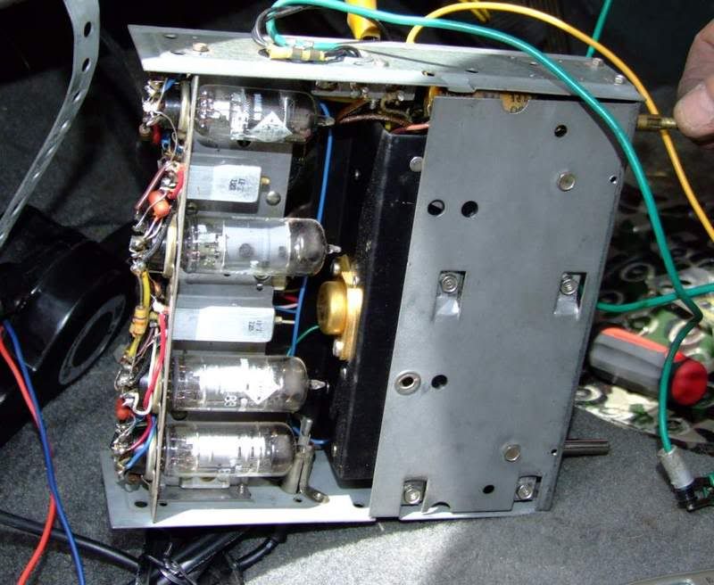

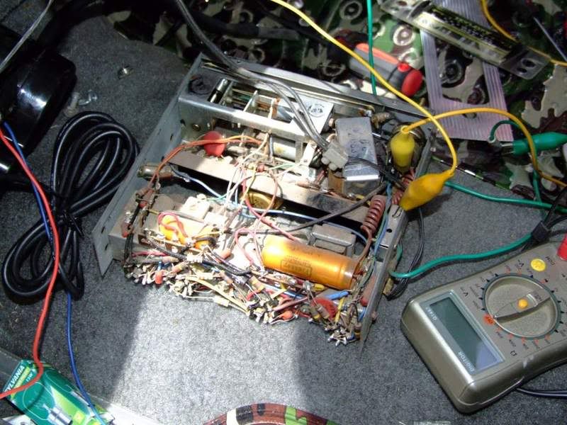

Contemplated pulling out the radio for a while, see if I can get it going. Well, as luck would have it I pulled it out, discovered it was still wired for positive earth.
*cue sad face*
Not looking good for it working then since car been converted to Negative earth. Prodded around a bit and got a hint of a click from the audio stage. OOOOOOOOO!
But wait! Switch has blown and saved the radio, so jimmy rigged a little click switch on wires and mounted it under the dash. Lubricated all the dial cords and pulleys, and got the light bulb working too.
Also removed the aerial, freed up the 4 sections and lubricated them, couple of kinks so it won't fully de-extend, but fully extended it's a massive 1.8metres high :shock: Can't ask for better reception than that!
But anyways, got me an original working VALVE car radio :D
And pics....... (for those of you who don't know what valves are, they are the glass tubes in the picture, they were around before transistors - I collect valve radios (home ones) with my dad so had a fair amount of prior knowledge to get Zephs radio going)
Crocodile clips and some poking and prodding gave promising results!

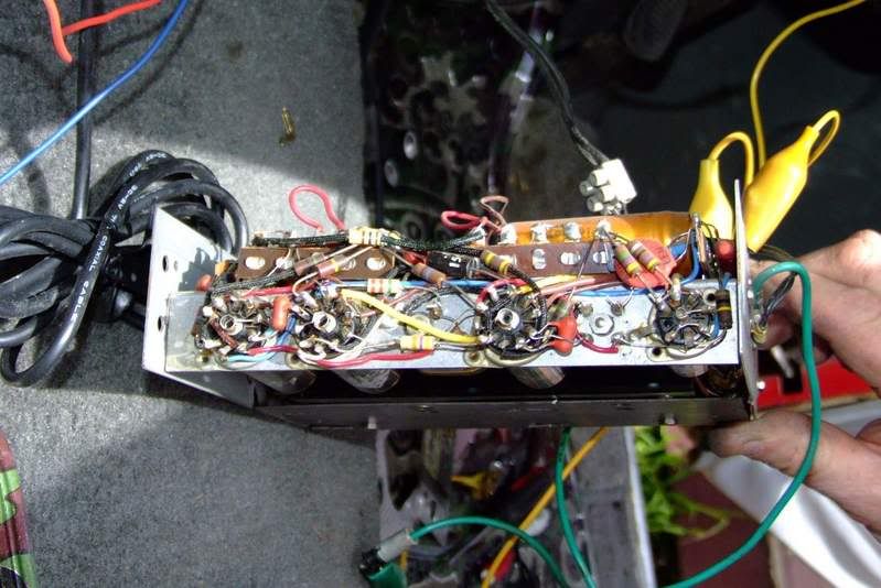

Sockets where the valves plug into. Alot more wiring and generally more messy than todays modern transistors as you can see.
The important bit, the valves! Those ones aint terribly impressive, they're little ones and the heaters use low voltage. Can get some much bigger ones that get very hot and can get some interesting electrical shorts inside for a nice show.

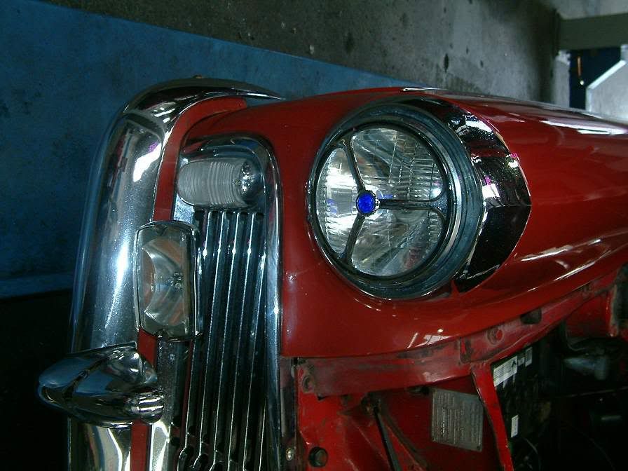

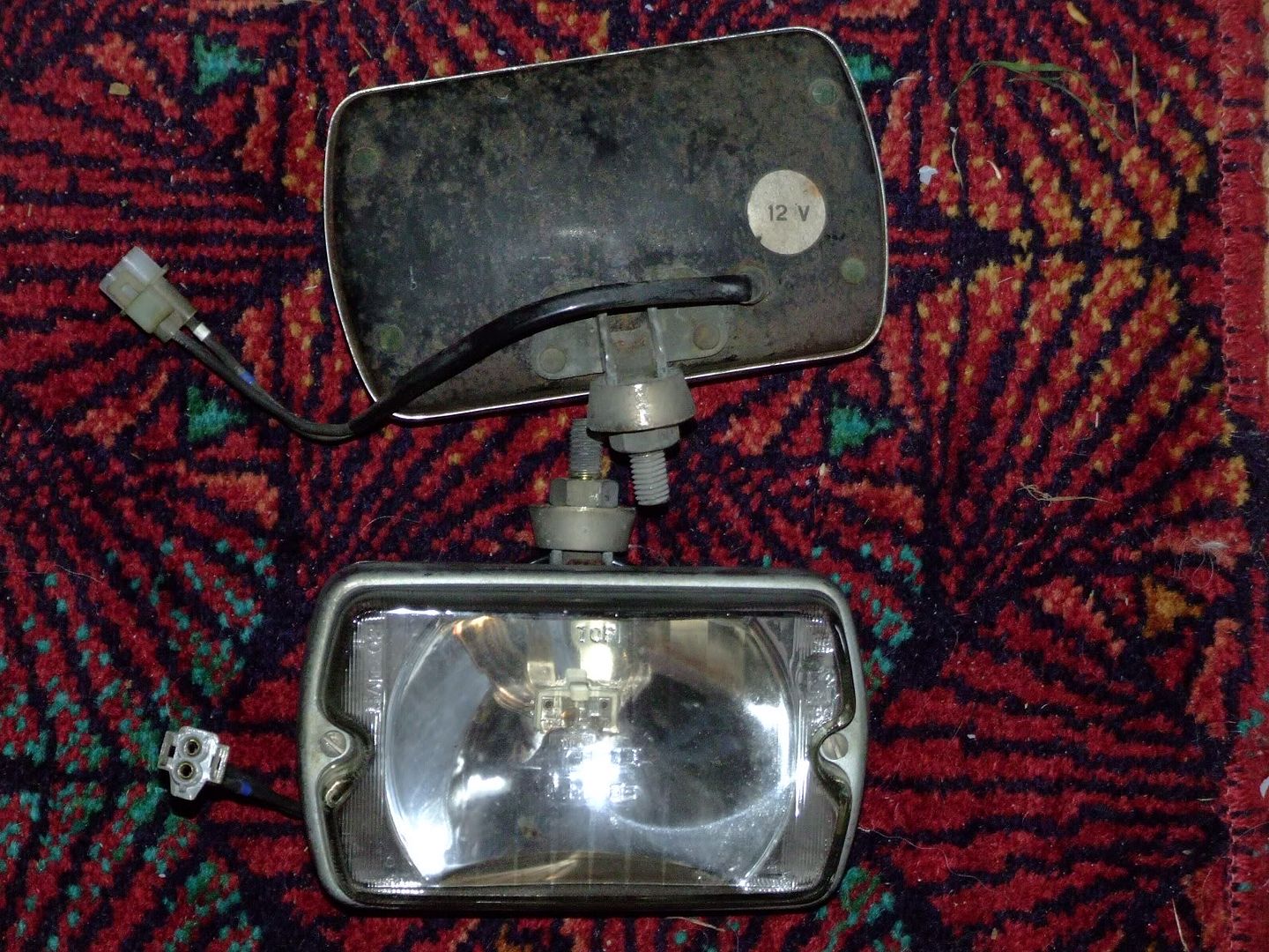

Dug these old things out of the shed. Bought them ages ago - like 5 years ago. Raided them off a Morris Marina, had them on 6 cars since. They fitted the period look of the Zeph, and well - to be blunt the headlights suck - old technology does have it flaws :( I paid $5 for them when i got them. Saw an identical set in Supercheap - $259 :shock::shock::shock:
Thought they could do with some TLC before they were fitted to the car, so pulled them right apart, polished up the chrome rims, sanded down the back plates, masked them up and gave them a nice coat of gloss black. Put all back together and hey presto........
Then came the problem of mounting them. Got the drivers side measured up mint and made the hole for the light to bolt too. Sweet, looks good. Measured up the other side - SHIT! Damn bumper or brackets or both are bent, so theres 8 inches between indicator and over rider one side, and 10 inches between the two on the other. Blast! Oh well - made a hole in the middle, so when I straighten the bumper brackets, I only have to enlarge both holes half and inch in opposing directions to even it out. Still pissed me off. But they're on and look good which is great. All thats left is to wire them up, but still keep the wires hidden in the engine bay. Nothing like a challenge :)

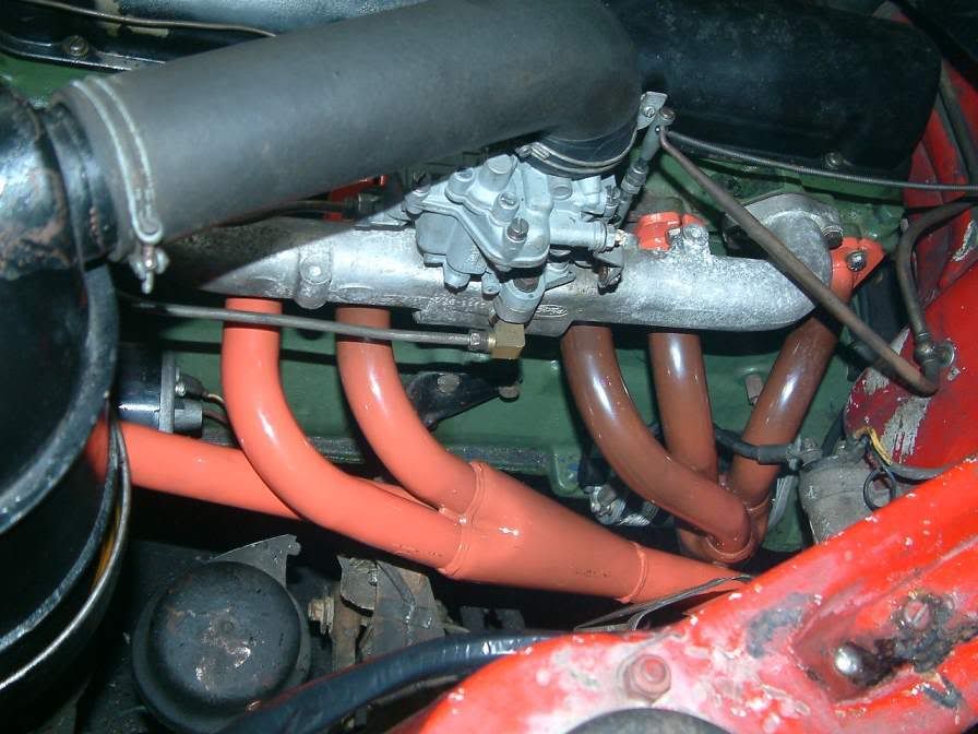

And motor wise - I thought it was struggling to breathe.
Out with the Hockey stick........
In with the tuned headers care of Coby
After a bit of use (apparently coby dont use heatproof paint.....!!!!)

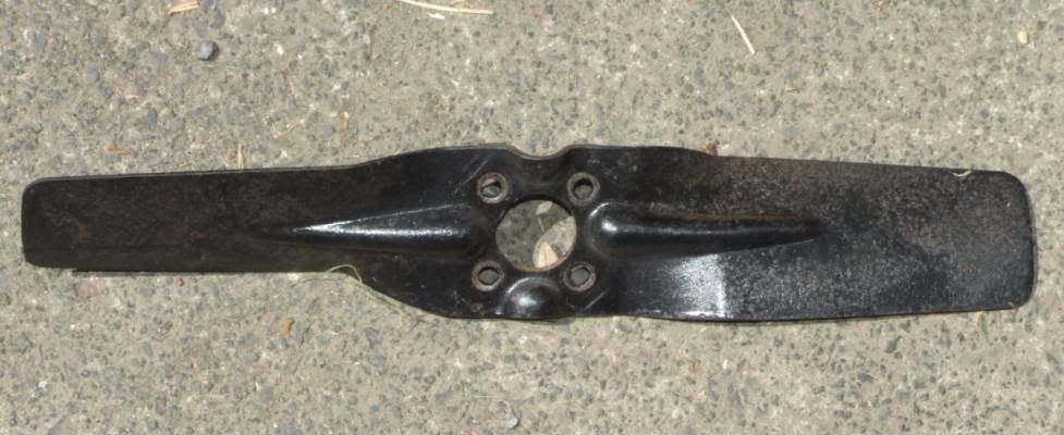

Old 2 blade fan
New 4 blade fan, freshly painted. These are impossible to get in NZ as they were an accessory for much hotter countries, same with the guards around the sump which my Z doesn't, but the green one does.

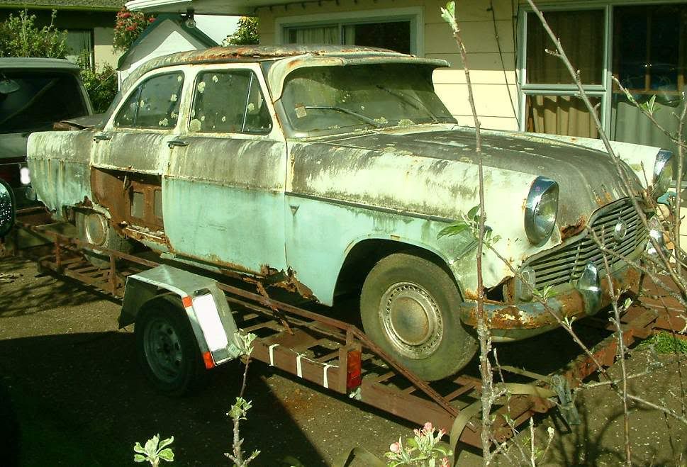

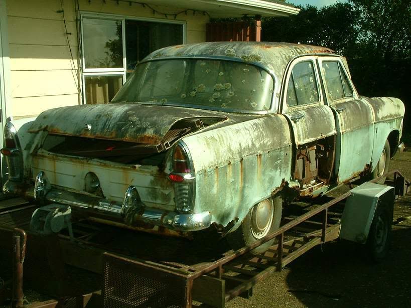

And the other was a freebie from someone who tracked down our car club. This basket case has been sitting by the ocean for 15 years, and as you can see, is falling apart. A half assed wash made it look heaps better. Don't have pics of it washed though. This is it when I got it home, on my awesome trailer.

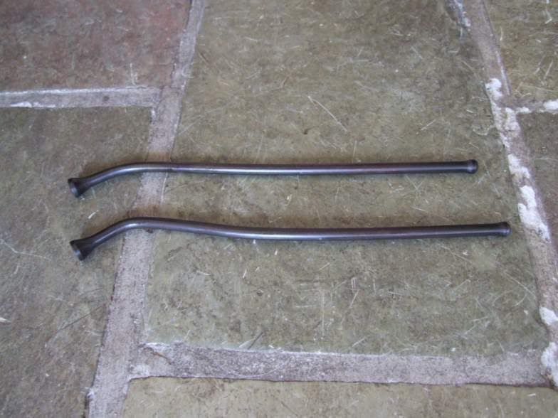

Spent today trying to get the motor running - previously the best I could manage was it turning over slowly. Replaced starter, and replaced leaky carb with a spare and it fired up with some tinkering. Running on 4 cylinders though :( Pulled the rocker cover off and was greeted with two stuck valves and this.....
Bugger - valves - 1, pushrods - 0. Managed to free up one of the valves but the other is stuck fast, so will require head removal to free it up. So it runs on 5 now. Proof of concept though, motor runs and runs well considering, so I have a spare now with some work :D
