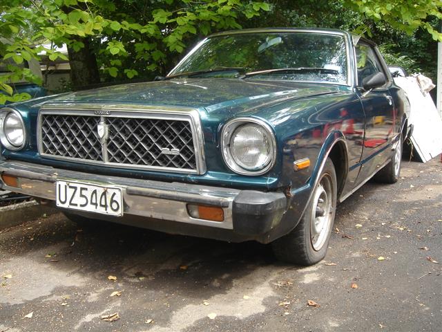

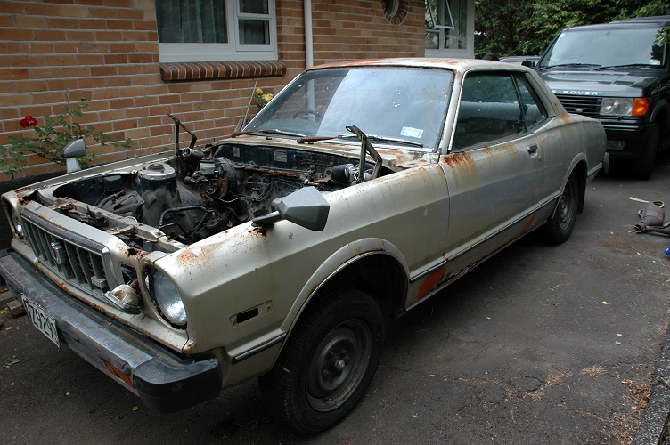

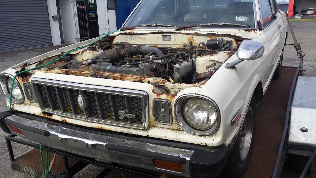

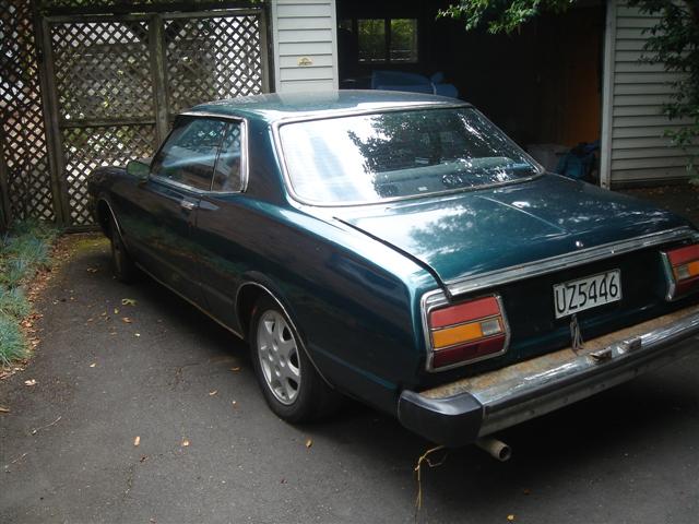

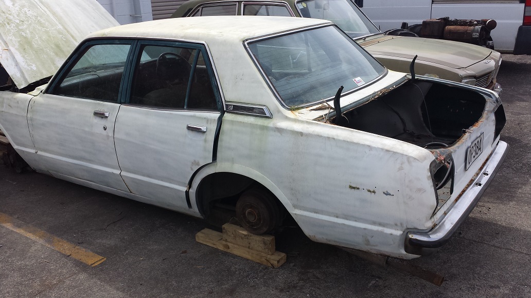

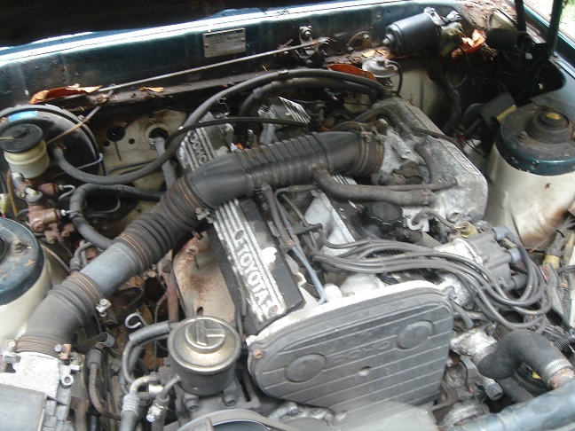

This project has been going on for about 8-9 years. Basically a good friend of mine has had this Chaser for years he used to sell it to people and when it rusted out he'd get it back weld some patches in it and then sell it again. I managed to convince him to give it to me back then. He had already fitted a 5mge. I bought a soarer and pulled the 1jzgte from it with plans to install it.
Then after being told by a Toyota guru that there was such a thing as a Toyota V12 I managed to track one down in Japan and imported that in 2009.

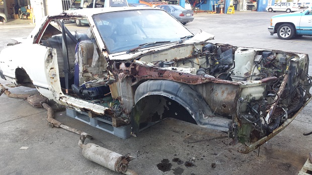

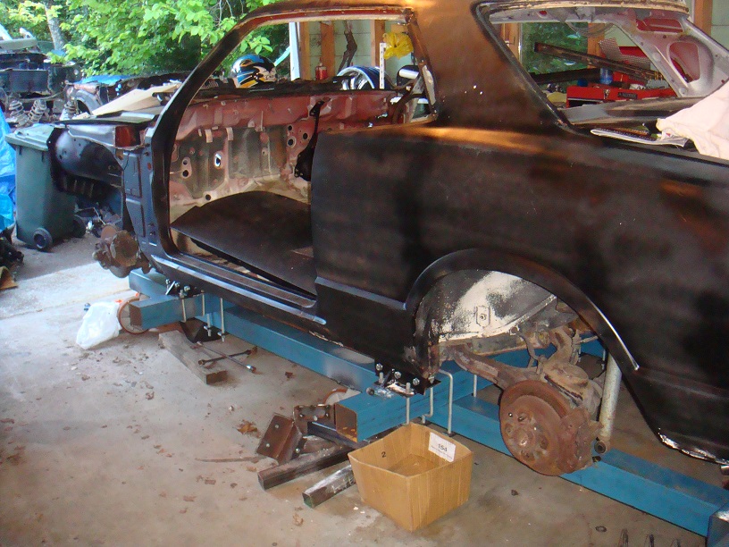

The thing that has made this project drag on for so long it that it's so rusty!!!. I've had to buy so many other rusty cars to get better parts from to help with the build, I've been so busy for the last 6 yeasr building my business I haven't had time to get to work on to it and trying to find a good panel beater who wants to do this kind of work has been near on impossible. It's an idiotic build but the car's rare and will be cool once done- if it is ever. I've built a chassis jig to it sits all square while we do some sill mods to help handle the torque.
