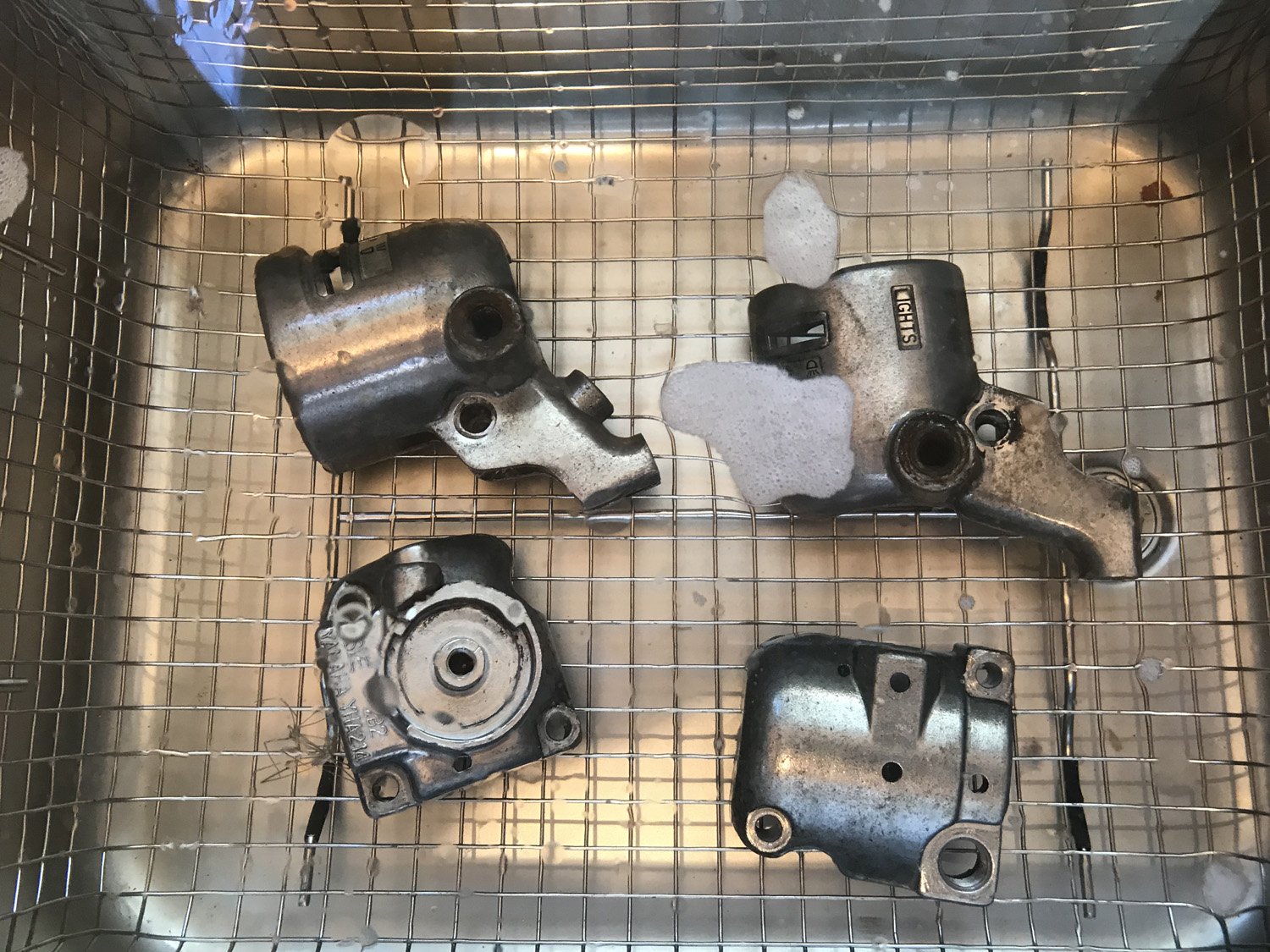

Turns out the switches I ordered are slightly different to the OEM ones. I don't want to have to rewire anything so today I set out to restore the originals. Happy enough with how they came out. The switches now 'click' much better than before.

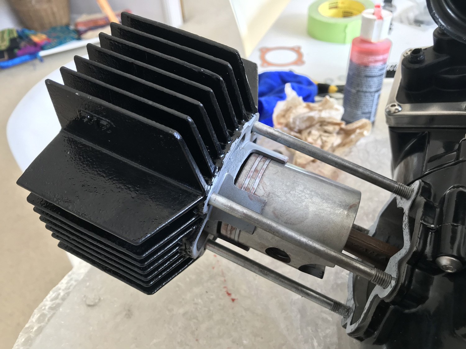

Look what we have here. Had to do a mock up after painting the cylinder and head. Off to the machine shop tomorrow.
The end is in sight! Blasted head and cylinder. Once machined and installed the engine will be complete!

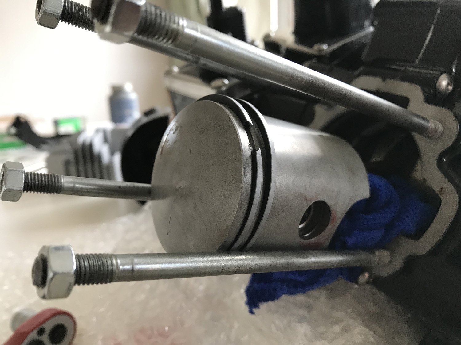

Shout out to Yambits! +0.75 piston arrived alongside and new small end bearing. Cylinder and head are off next week to get blasted. Once painted the cylinder will be off to the machine shop for a a fresh bore & hone.

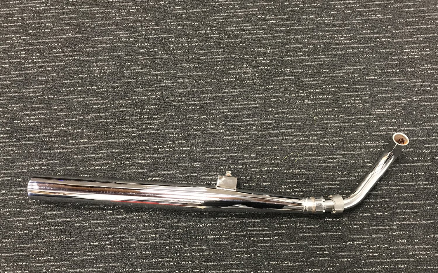

$15 dollar exhaust arrived and it looks just as you'd expect - like a $15 exhaust. I'm happy enough.

@Truenotch cheers bro! Looking forward to your build thread! Got carried away and installed the points/magneto. Realised that I need to find a replacement side emblem, mine is bent to buggery. Also placed an order with Yambits for a 0.75mm oversized piston. Toyed with the idea of going 2mm over, but I think I'll keep it conservative for now. Once the piston arrives I'll send the cylinder off to get a re-bore and hone.

It's Christmas time and I'm poor so I'm waiting till the new year before I splash out on some crank installer / case splitter tools. In the mean time I've been cleaning and painting bits and pieces to keep the progress going. Oh and I bought a brand new exhaust header & silencer from China... FOR $15. Postage is around $80, so less than $100 for a brand new exhaust - I wonder if it will actually fit?
