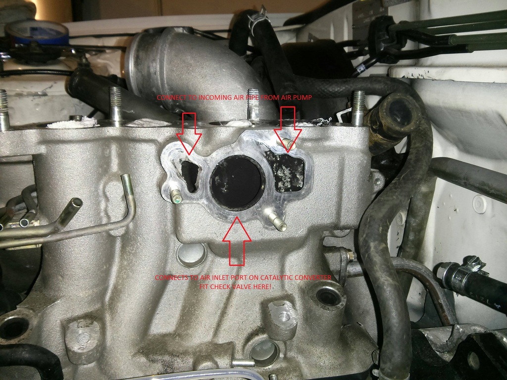

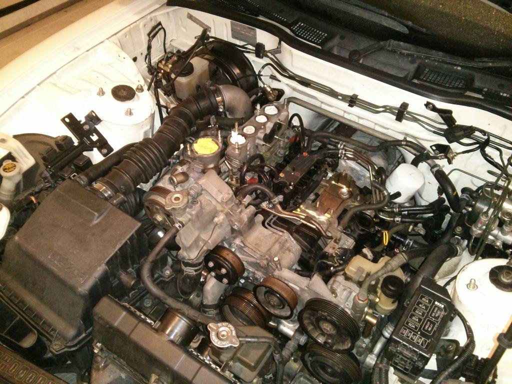

Squeezed in a couple more hours today. Got the oil injection valves plumbed, They've got check valves built into them (which I've just realised I've forgotten to check!), the plumbing on them is just for evaporation emission purposes I believe. Added in the line which goes to the fuel pressure reg control solenoid too, as I won't be able to get to it later. I got the injectors in place, the solenoid block mounted, and started plumbing that in. I'll have to un-bolt it to get the loom in place, but the lines have enough flex to let me leave it plumbed up. All the old vacuum lines. A few of them are cracked, all of them are super hard and brittle. Air box and turbo inlet plumbing back in. I made sure to remove the rags from the turbo inlets! I got a replacement secondary turbo inlet pipe locally, guy had the check valve for the pressure chamber too, score . It's *possible* I might be able to start it up again tomorrow. I need one new belt as I stuffed one getting it off, and one of the HT leads was in not too great shape, so I might try to track down another set of those. I don't think I'll re-wrap the loom quite yet, as I could yet still have issues. It's not a major to get it out again and wrap it anyways .
Dammnit man, sold plan.

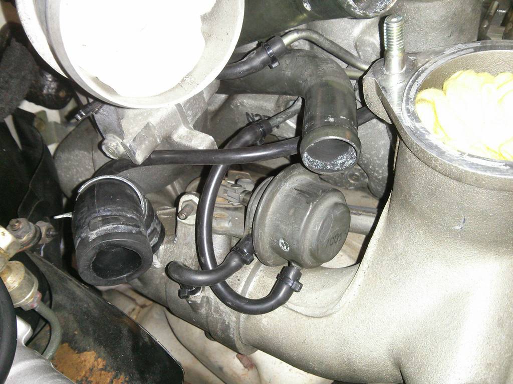

Did a bunch of Uni work at home today, so split some time to work on this for an hour or so aswell. Tested the Turbo Control Actuator, on the pressure side, functioned correctly. I tested the vacuum side too, didn't climb under the car and actually observe the valve, but the line did hold vacuum. Plumbed up the actuator side of the metal pipe manifold that feeds the Charge Relief system. Installed and plumbed in the Charge Relief Valve. Updated my vacuum port reference map. Will hopefully get a bit more time after dinner to have a further play, can hopefully get the injectors installed, secondary air system back together, Air Bypass Valve (blow off valve) installed and start in on the solenoid block.

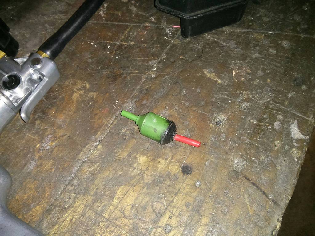

Wasn't really tired when I got back from uni in the wee hours this morning, so spent some time in the garage. Once again, this post is more for my reference than any actual progress. Air Bypass (Blow Off) and Charge Relief Valves both tested and functioning correctly. Vacuum Tank tested and held vacuum fine. Pressure Tank tested and held pressure fine. Check Valves that goes inline with the Pressure Tank is fucked, will need to source another. Airbox to Turbo Intake accordian pipe is fucked, will need to source another. Figured out how the Secondary Air Injection system is routed through the manifold. Tested the Secondary Air Injection unit and is functioning correctly. Tested Deceleration Control Dashpot and is working correctly, however will need to be set once the car can be run to normal operating temp. Cold start system looks like it's bee played with, set to somewhat logical settings, but will need to reset once car can be run and warmed up. Tested both Wastegate Control and Turbo Precontrol Actuators, both hold pressure and function correctly. Tested Charge Control Actuator and it's functioning correctly. Just need to test the Turbo Control Actuator now, but its a pig to get at, will jack car up and get at it tomorrow. Started re-running vacuum lines, but really need to remove the secondary turbo intake pipe to get to a couple of the barbs, will also do that while car car is jacked up.
