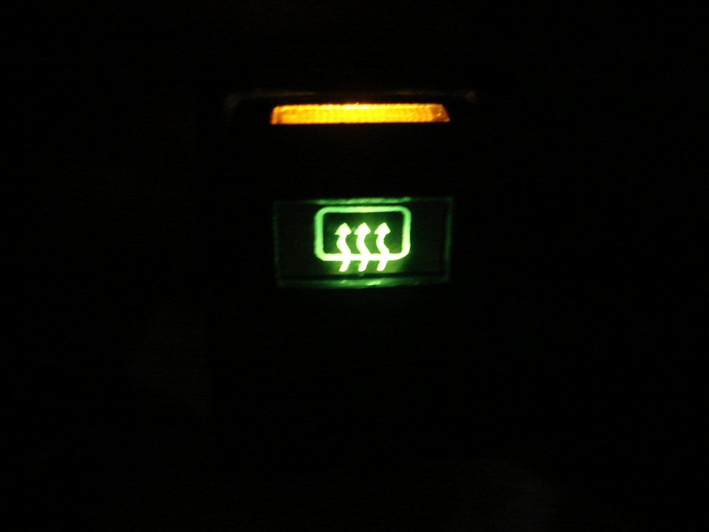

I was waiting for something else to happen before I could attempt a wof, so I decided to do something about the dashboard switch lighting. The rocker switches have tiny screw in lamps in them, but they often manage to either fail or quietly unscrew themselves resulting in partial blackouts. That can actually be a bonus, because when they do work they get so hot that operating the switches can be a health risk. On top of that, they melt. Hey. We got LED's these days... The bits look like this.. I sacrificed a switch body to use as a jig and soldered up the LED plus a resistor whose value (820 ohms) I had chosen to give me the amount of bright I was after. Bingo.. That comes out quite easily as one assembly and gets transplanted into a working switch, by pulling the rocker out of the switch body, swapping this with the original lampholder, then bunging it all back in again. Happy with the level of bright.. And in the dark it is not over-bright which would be more annoying than it not being lit at all.. So that took ages, being 7 switches and all, but it is done forever hopefully. Another thing that had to be done for a wof was to get the screen washers going. The front one did nothing at all despite having power. A rat around in the old manky bits dept elicited one that worked, so I mounted that up front. All good there. The rear one made noises but would not pump anything. It is hidden away near the spare wheel, but is still fortunately fairly easy to get at. I found it was wired backwards, so of course it was running backwards too. East fix then.? Nope. Won't run at all when wired correctly. Ratted around for another, and after rejecting 4 or 5, found a goodie. Pleasingly it primed up and was doing its thing in a trice. I admire the fact that they hid all the gubbings for this setup, while leaving them very easy to get to. Does not happen very often. Ok. Next step warrantsville.
