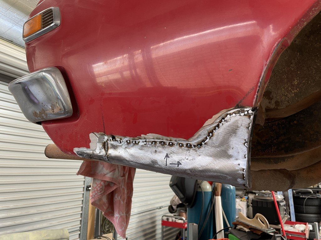

I was pretty happy with the result thus far. Proceeded to put the bottom half of the outer skin on. Welded it out. And totally fucking rushed it. Not enough cooling between welds. In hindsight, I should have Tigged it. Oh well. At least there was reasonable access to the back of the panel - a fair amount of hammer and dolly work went into it which then got it pretty close.

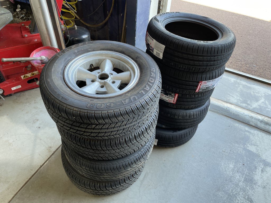

Determined to get the coupe ready for the upcoming car show, I pulled out the stops and proceeded to bite off more than I could chew. First job was to strip the suspension and driveline out to make way for the MS112 gear. Work on the car was only possible after normal duties were addressed - so between the hours of 7pm and 1-2am each night after work, things happened. Also decided that whilst I liked the wheels I had for it, the tires fitted were far too big. Called in a favor and got some more appropriate tires fitted. Much betterer!!! Gave the front springs a tough up with the 5" grinder and improved the ride height. Plenty of work went into getting the MS112 gear under the car - and due to obvious time constraints, photographing each stage wasn't in the forefront of my mind.

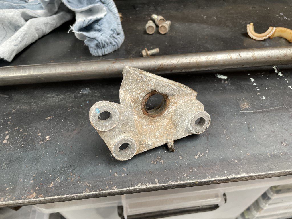

With the necessary holes and fixtures swapped between firewall plates, both pieces were tidied up ready for paint. Vapor blasted the aluminium support bracket that holds the column shift parts together. It was about at this time that I became aware that the annual Toyota Enthusiast Car Club of WA car show was approaching. With the show being one week away, I made the decision that I would get the coupe looking respectable enough to take it along without feeling embarrassed for my (perceived) lack of progress.

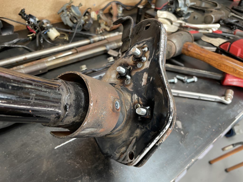

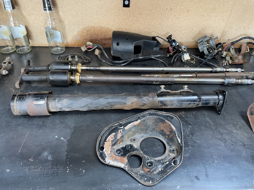

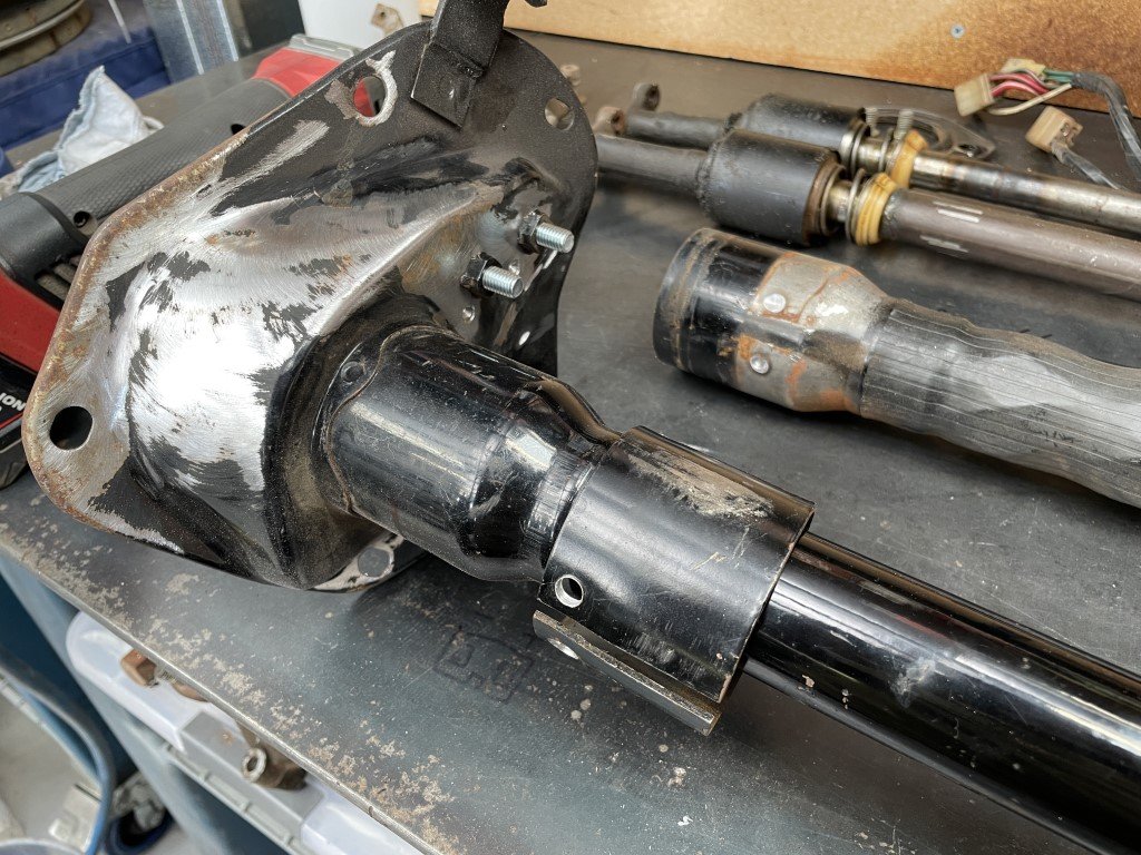

After getting it home I decided to start toying with the thought of installing the MS112 running gear (including brake booster / master) which seemed like the best way of fixing the seized calipers / leaking master cylinder. This blew out to removing the steering column to give it a collapsible column conversion for the future engine conversion / upgrade. Seeing as I had a car with a collapsible column (column shift automatic) and the MS51 column was floor shift, I set about dismantling both columns to work out where the similarities started and ended. The collapsible column has a rubber o-ring and flange to secure the column tube to the firewall plate - whereas the non-collapsible column is fully welded. Additionally, the firewall plates were quite different between column shift and floor shift. This resulted in some drilling, grinding and cutting to allow me to transpose holes and fittings required for the column shift parts to fit the non-collapsible column. An extra part the column shift setup had was a collar at the base that needed transplanting.

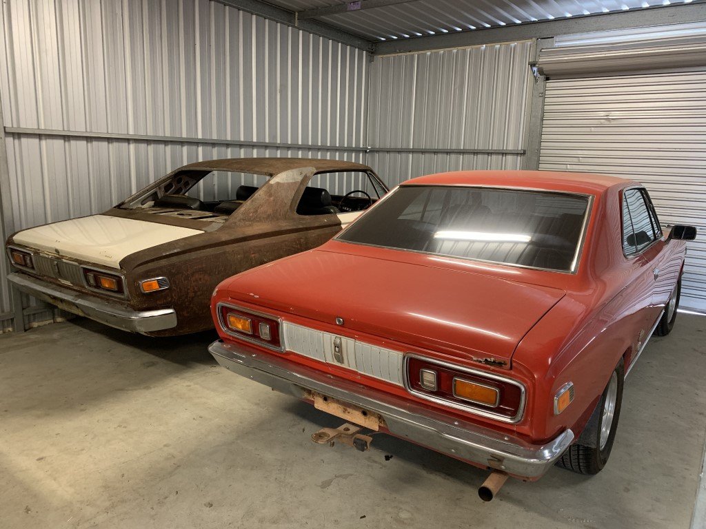

Fast forward to nearly 12 months after getting MS51 #1....... After understanding just how hard it was to find parts for a MS51, I jumped at the opportunity to purchase a second MS51 when it was offered to me. The beauty of this one is that it's been stripped back to bare metal for all except the hanging panels - which means I can see exactly where the sins are. It also came with a whole bunch of parts. Including this....

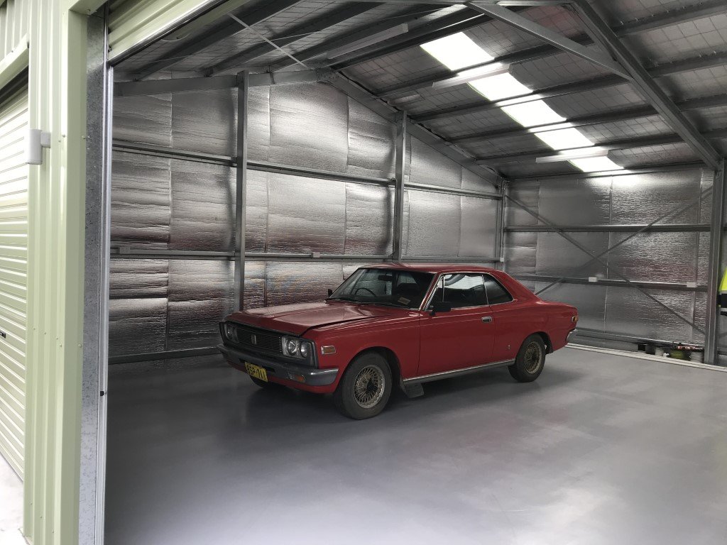

Fortunately, I had recently built a decent sized shed in my backyard - so the 51 went straight in. I set about giving it a quick tidy up and look over to establish just how bad it was. First thing to go were the wheels - chucked an ad on gumtree and had some fella take them off my hands for what I thought was a reasonable price. Nighttime insta shot just because.
