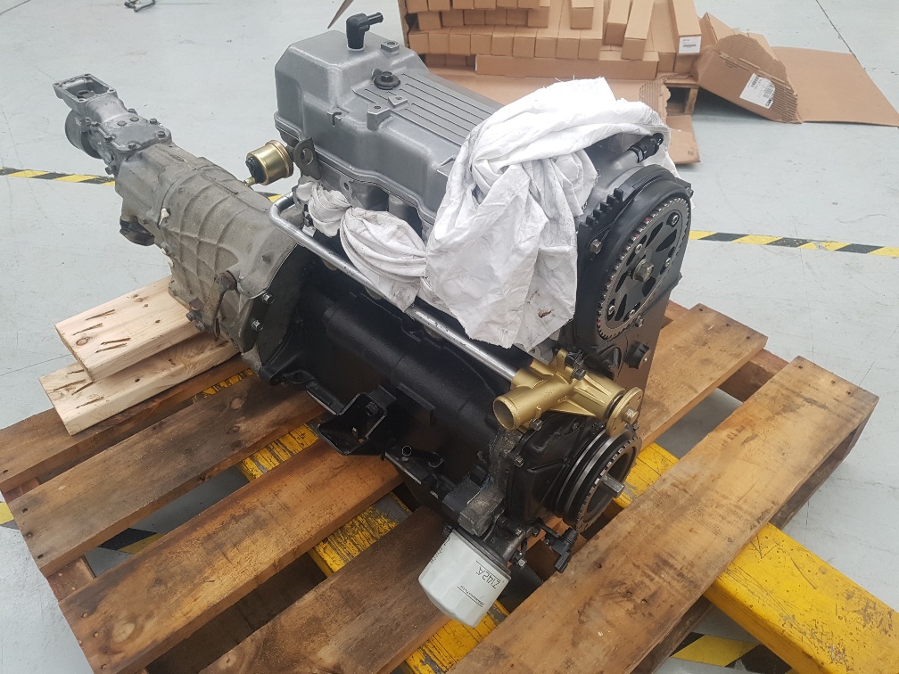

Finally found some valve locks and got the cylinder head finish assembled. Still needs lash to be set. Time to bolt it down to the block and time it up ready for exhaust and intake mockup.

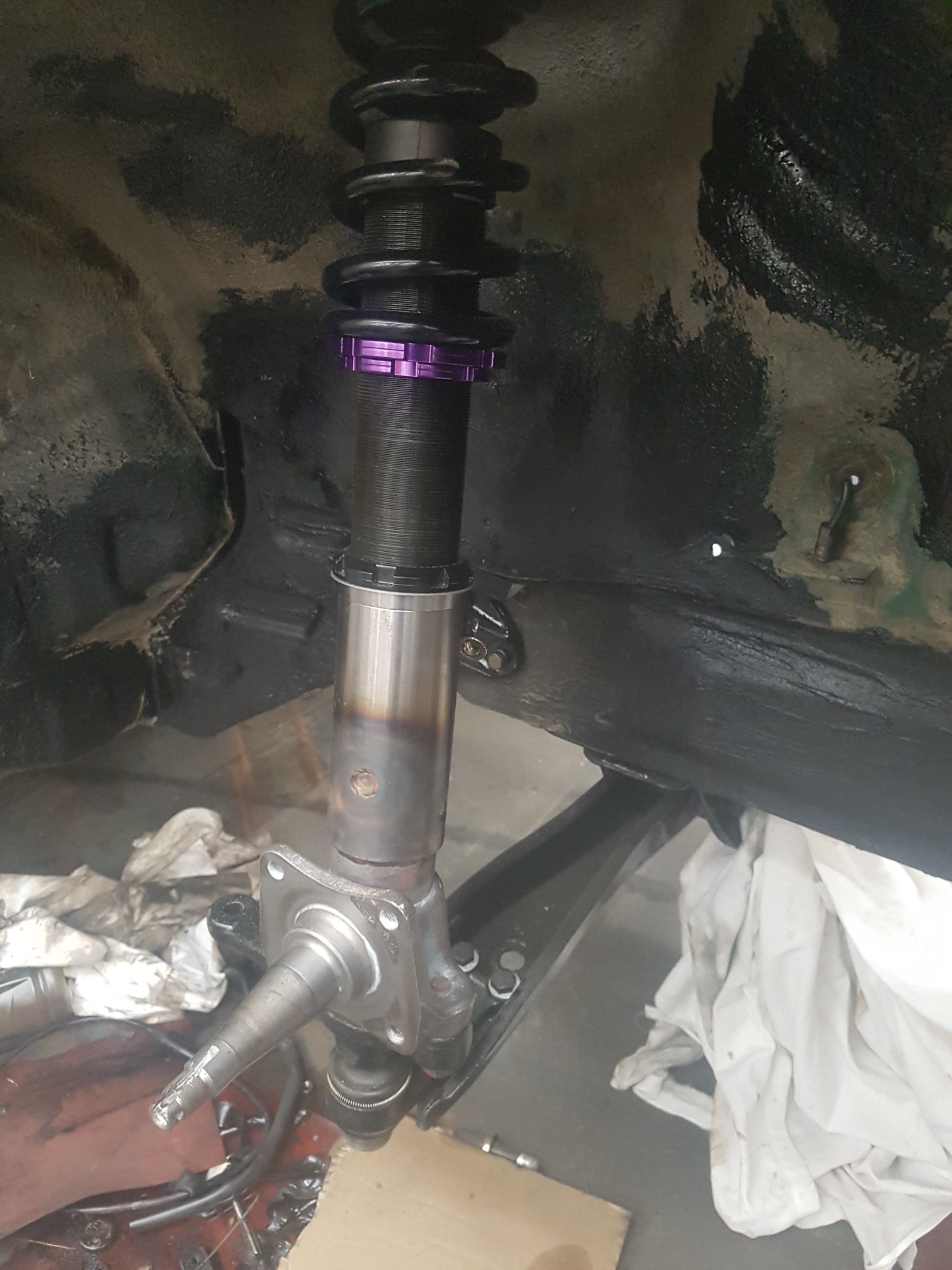

New D2 shocks arrived with weld on tube sleeves. Shocks are sporting custom camber plates design courtesy of Poo and water jet out of 10 mm aluminium thanks to Adam.
