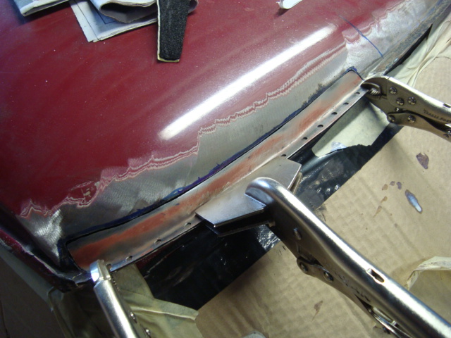

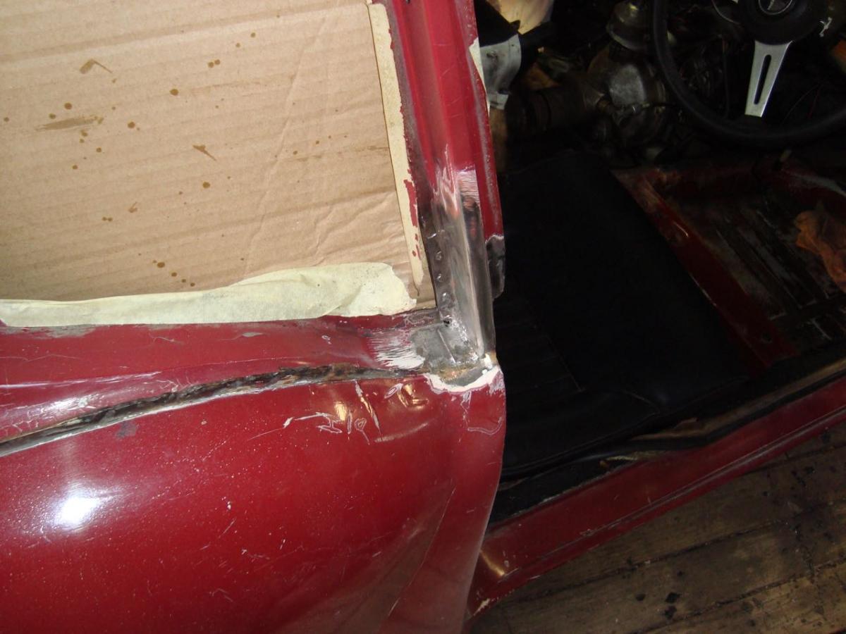

  19. Long overdue update. We finished the roof and it looks really good. The paint doesn't match but its close enough. We also finished the B Pillar repair
  20. So it was out with the hammer and Ethan spent the next couple of hours making up some patches and welding them in. More to come......

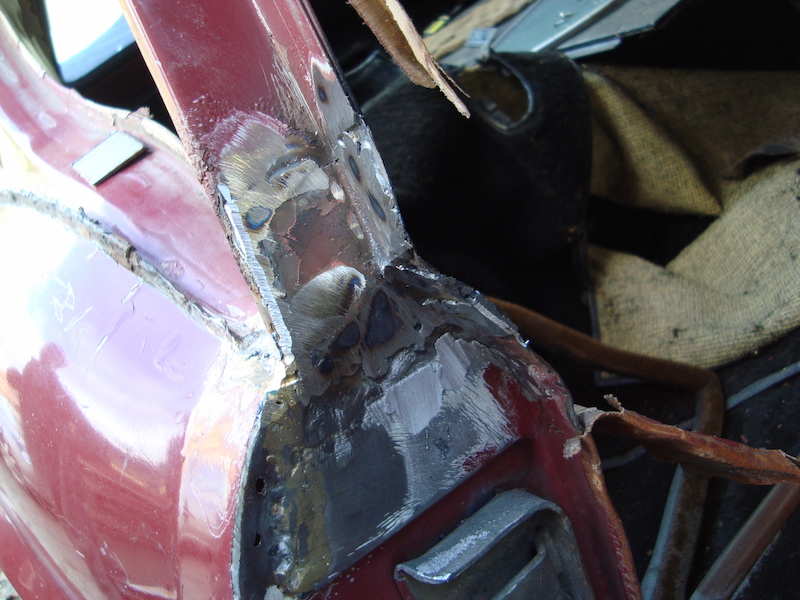

  21. We made the mistake of looking at a crack at the bottom of the B pillar. Once we had sanded it back a little we ended up with this It looks like a little more is going on here. Notice the old repair with Brassing and Lead. The other side looks a little rusty but we decided to investigate further. Oh no.... This is where we ended
  22. Grind it some more Bog it up Paint it
